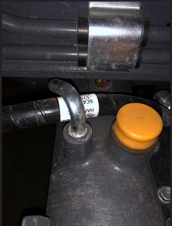

I have this exact issue with a brand new bx2380. (5.5hrs on it)
Front axle fairly warm, oil seepage @ right front breather bolt. (left is fine)
Plug shot out (almost) like a champagne cork.
whitetiger
Nov 20, 2011
3,285
1,700
Kansas City, KS
Are you referring to the vent plug on the top (14mm head)? If so, it has a sealing washer with a rubber insert under it. Check to see if it is tight, if it is, the washer needs replaced.
As far as the pressure, it is a non-vented assembly and when the oil is warm builds pressure. The dipstick will pop when removed, it's the nature of the beast.
