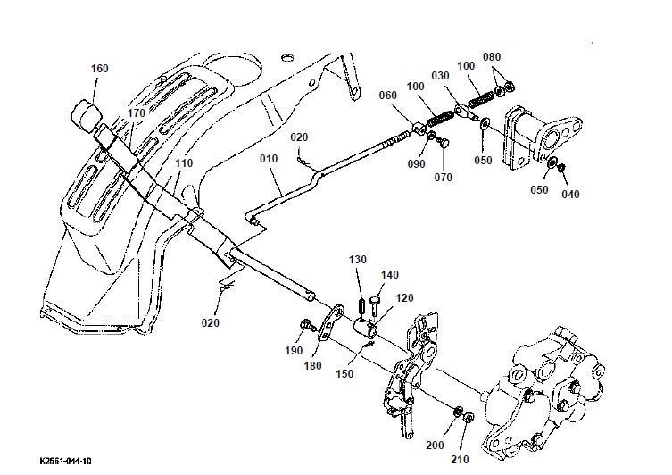

Another option is to adjust the return springs on the lever to allow the handle to stay down. The springs are on a shaft just behind the right tire. You can see them from the rear of the tractor.
It is much easier to adjust when the right rear tire is removed.
