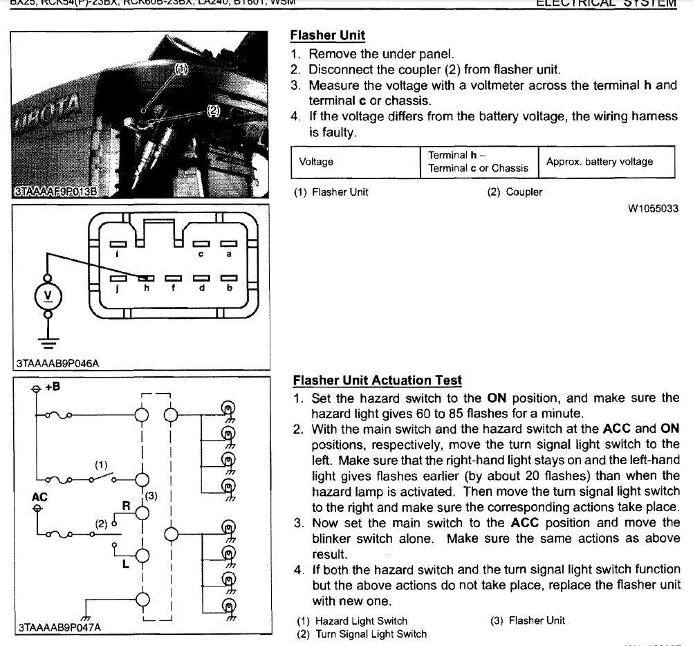

According to manual, the flasher unit is under the front dash, on the left side. In the BX WSM page 6-S22.

So they are Dual Filament? I have been researching and I can't confirm this. I'll down load the manual and make a donation.
12,813
5,587
You can get the BX25 WSM for free from www.kubotabooks.com. select tractors, scroll down to bx25.pdf....

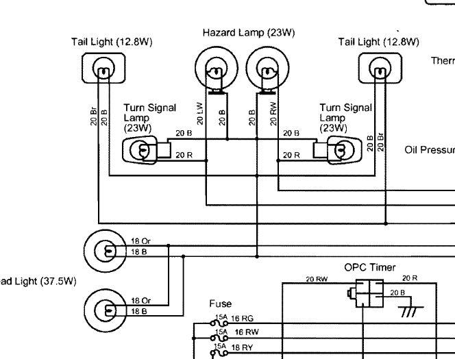

I have it now and they are single filament bulbs ( 1156 ? ). left turn and hazard are in parallel ( tied together), same for right side.
The pita is the wiring diagram is on two pages,'fun' trying to follow the electrons.
You might have a blown fuse...will have to combine both pages, make one, print it out to see though....
BX25 Manual shows it as 2 separate bulbs (Hazard and Turn), each single filament, but wired in parallel...
From what I can find, they are the common 1156 type of automotive bulb
