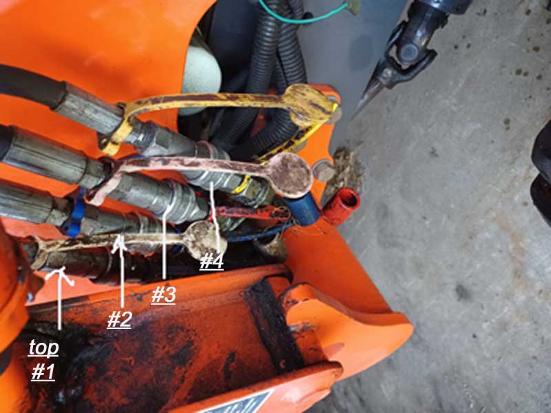

Would someone identify which hose controls lift and bucket. The lines are in a row on the tractor and hard to trace to each cylinder.
I attached a photo numbered from top to bottom.
My primary problem is the bucket leaks down immediately. I suspect cylinder seals as the cause but would like to be sure.

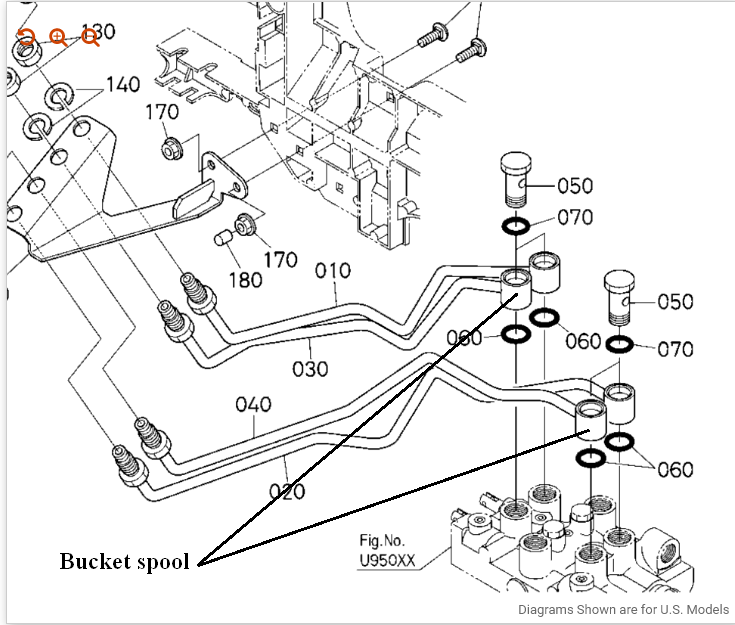

Parts diagram for BX2350 loader valve,

Just received an e-mail with answer;
Ports 1 & 4 control bucket up and down
Ports 2 & 3 are bucket tilt.
By switching 1 & 4 to 2&3 eliminated the control valve as the cause of leaking down. Now to order seal kits for lift cylinders.
