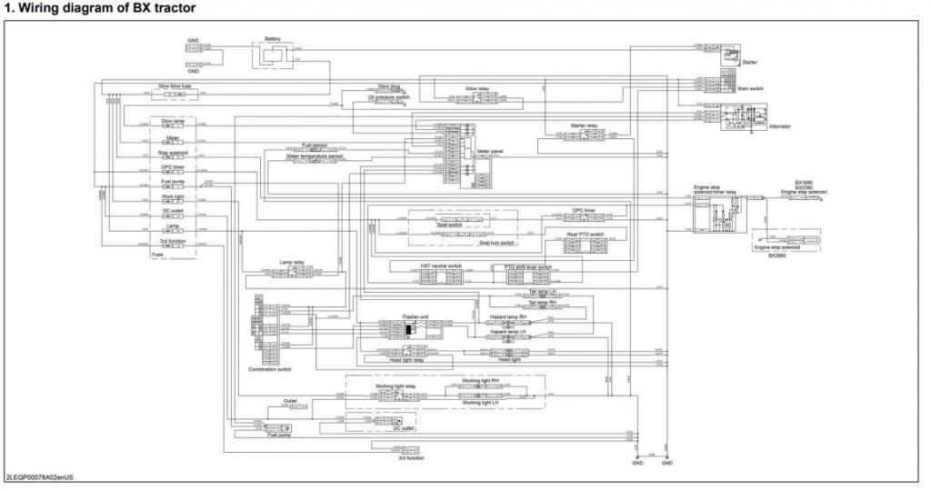

the pump does not run with the key in the on position. I cannot find which fuse operates the pump. the schematics I found on the web don't indicate a fuse. any guidance on a good schematic or insight on the fuse location is appreciated...thanks all.

Yah IF you find a readabe wiring diagram email me !!!
The fuzzy one I have shows a fuse for the fuel pump, 5th one down from top IF they're in the same physical order. I can't even read colours or sizes of the wires, let alone Amp rating of the fuses......
Hope you can see what you need in this diagram. Fuel pump fuse is fifth from the bottom

don't count on the order of the fuses to be correct, mine weren't. Since there's only a handful, check them all.
If the fuse is good, check to see if you have power to the lift pump with the ignition in the on position (not the start position). Check for loose wire to lift pump. Since its located under the tractor, they are vulnerable to to sticks etc.

Thanks to all for your input. It was the fuse. It was located 2nd slot up from the bottom. Started right up...very much appreciate the guidance
