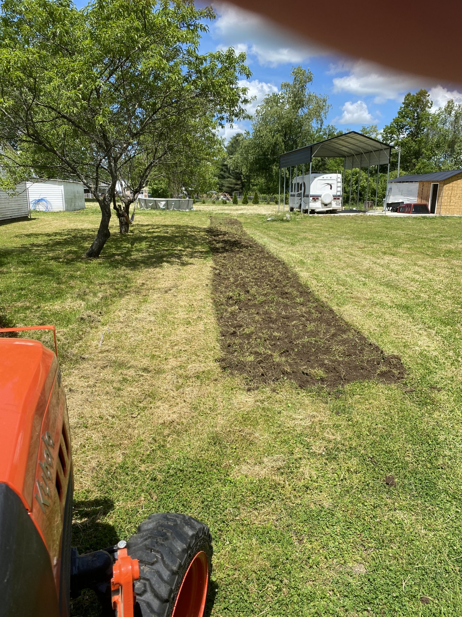

I just did a 1/2ac 'formerly no-tilled' for 30 year 'patch'. Last crop was oats,still have jars of seed that I combined.
It was all my 40HP tractor, in 1st ,low could do to pull the subsoiler through. In the 'real' garden I can go 2nd,hi...
After subsoiling, waited 3 days, then ran 3 furrow plow. Again, the tractor told me the ground was 'tough'. Let 3-4 days go by THEN ran the 5" fwd tiller through, wait 2-3 days, run again. The ground is 'reasonable' though it'll need a LOT of compost to get good 'tilthe'.
The deeper you 'chew up' the better the root crops you'll get, like foot long carrots.

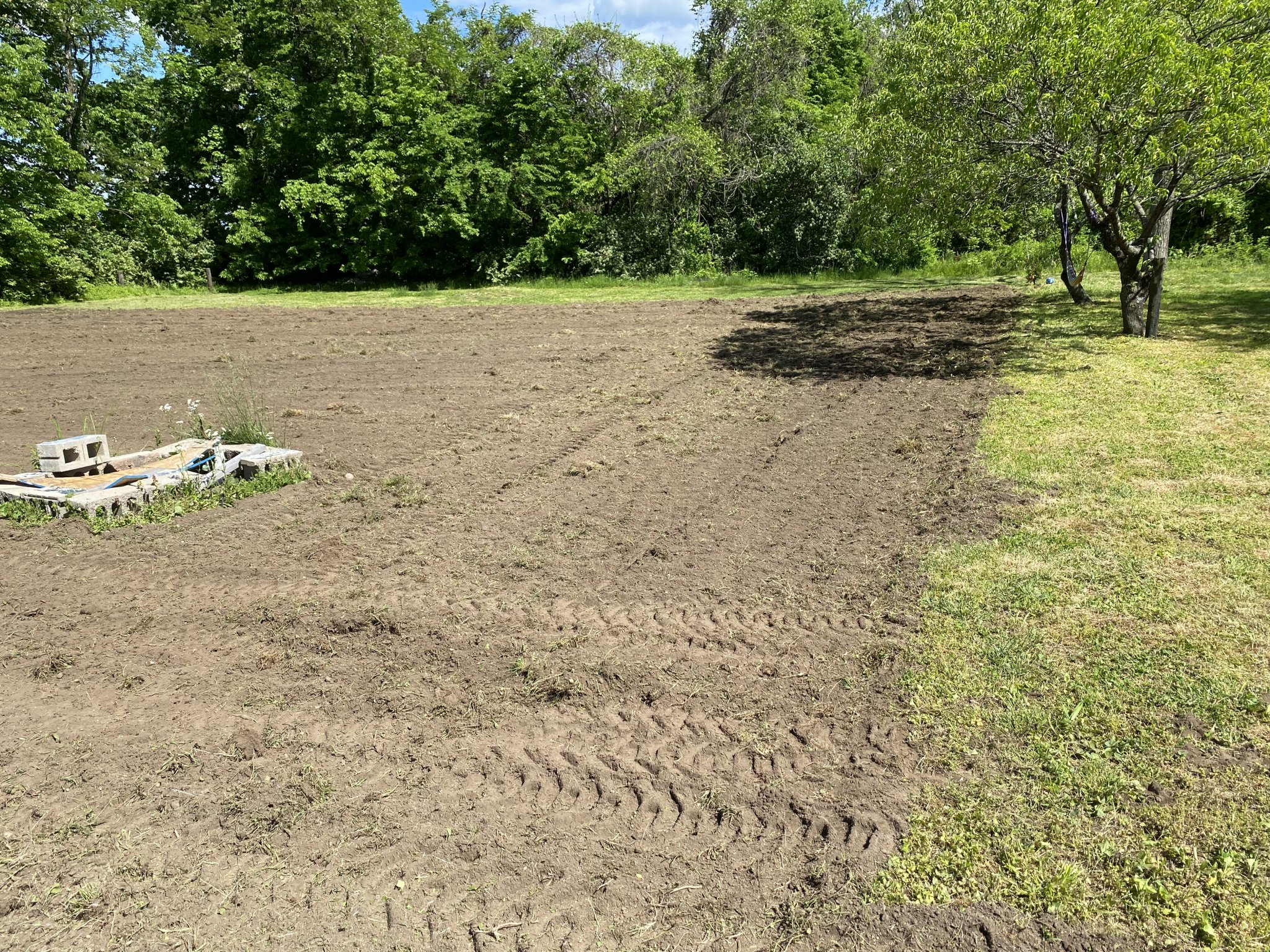

Last year I put in a new ~3/4 acre front lawn. I used a reverse rotation unit after running my box blade thru to remove the rocks / roots. The ground hadn't been touched in more than 30 yrs and was really hard.
I was really pleased with the results and certainly had no issues in 2wd pulling the tiller.

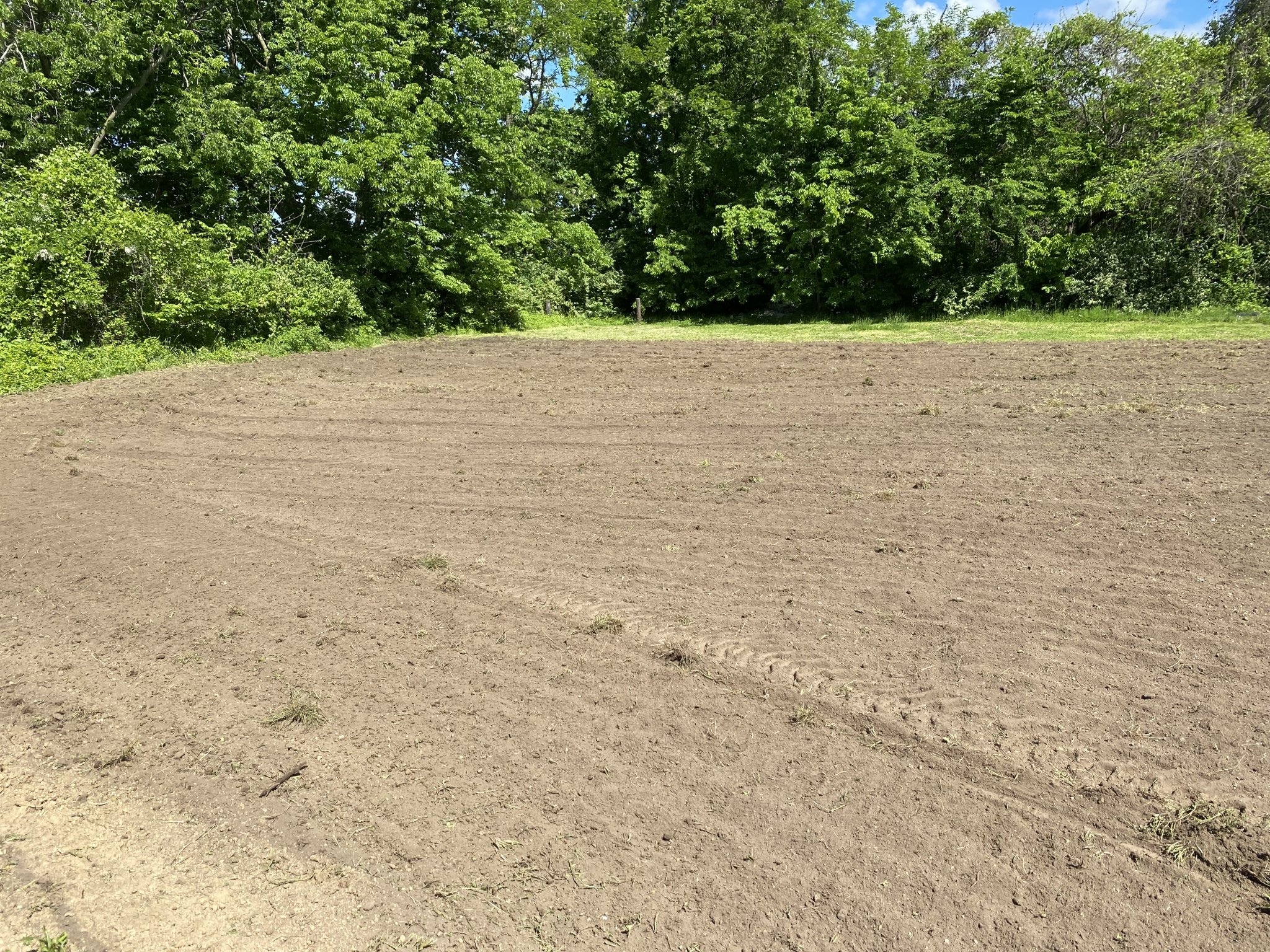

LandPride RTR52 on my BX. In my soil it works great but as in the vid, it will pull a lot of trash along. First time use was pasture never turned, went through like butta. On friends place, pretty much the same, EXCEPT, he has rocks. Hit one rock and it bounces like crazy, does not kick it out but pushes along hitting over and over... really wakes me up! My soil is a sandy loam, his more a clay loam. Either one, without rocks/roots, leaves a very nice seedbed with one pass. It's only stalled my BX once, that was last week and was a big/unmovable rock. Has worked great for 10 years now.
