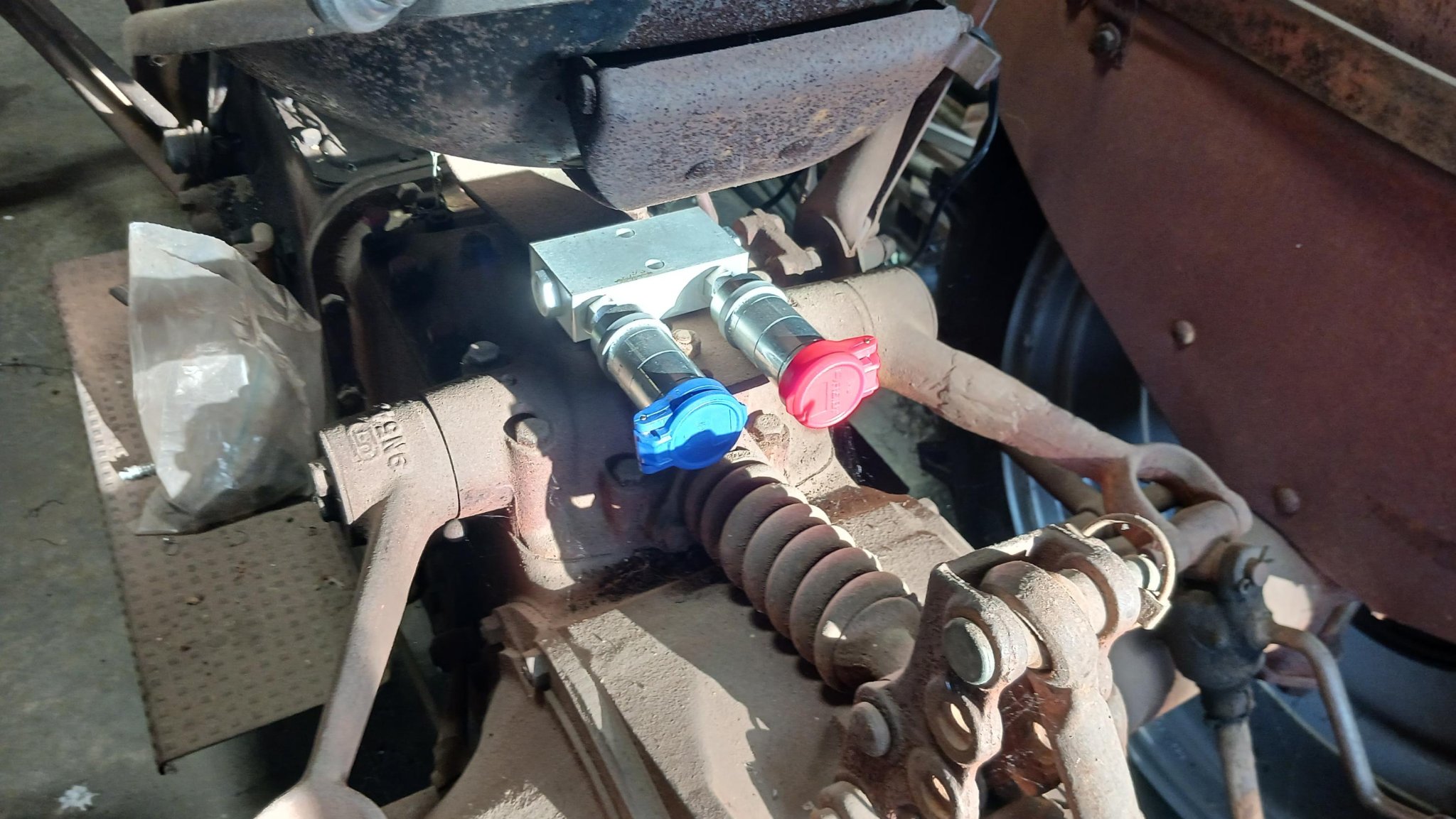

My DIY solution - the mounting block is the DPOCV.
I should have listened to you the first time you told me to do that.
But learning to make that bolt was pretty cool. (y)
For the 'tilt" cylinder, I will probably cobble something like you have together.

You can also get control valves for your top tilt with dual pilot operated check valves installed in them. This is what I did.
Simple, but it does move the check valve further away from the cylinder… If that is a concern.
I have found having float on one of my control valve sections is handy, but float is not compatible with pilot operated check valves. So it’s one or the other.
