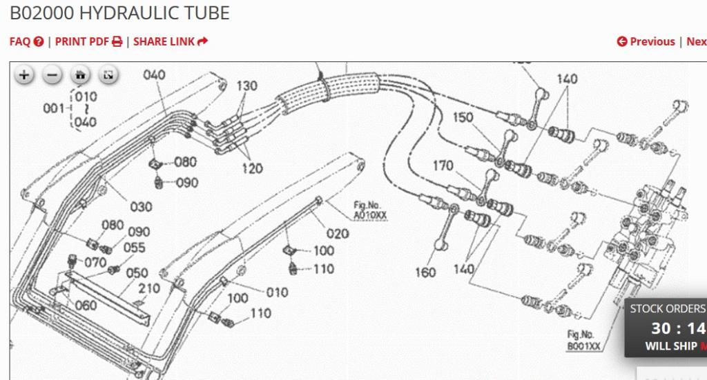

Go to the Messick's or Coleman Equipment website, enter your model number and peruse the parts drawings. You'll find what you need, the part number and the retail price as well. Your local dealer can do that as well. Hardlines don't usually fail for no reason btw.
