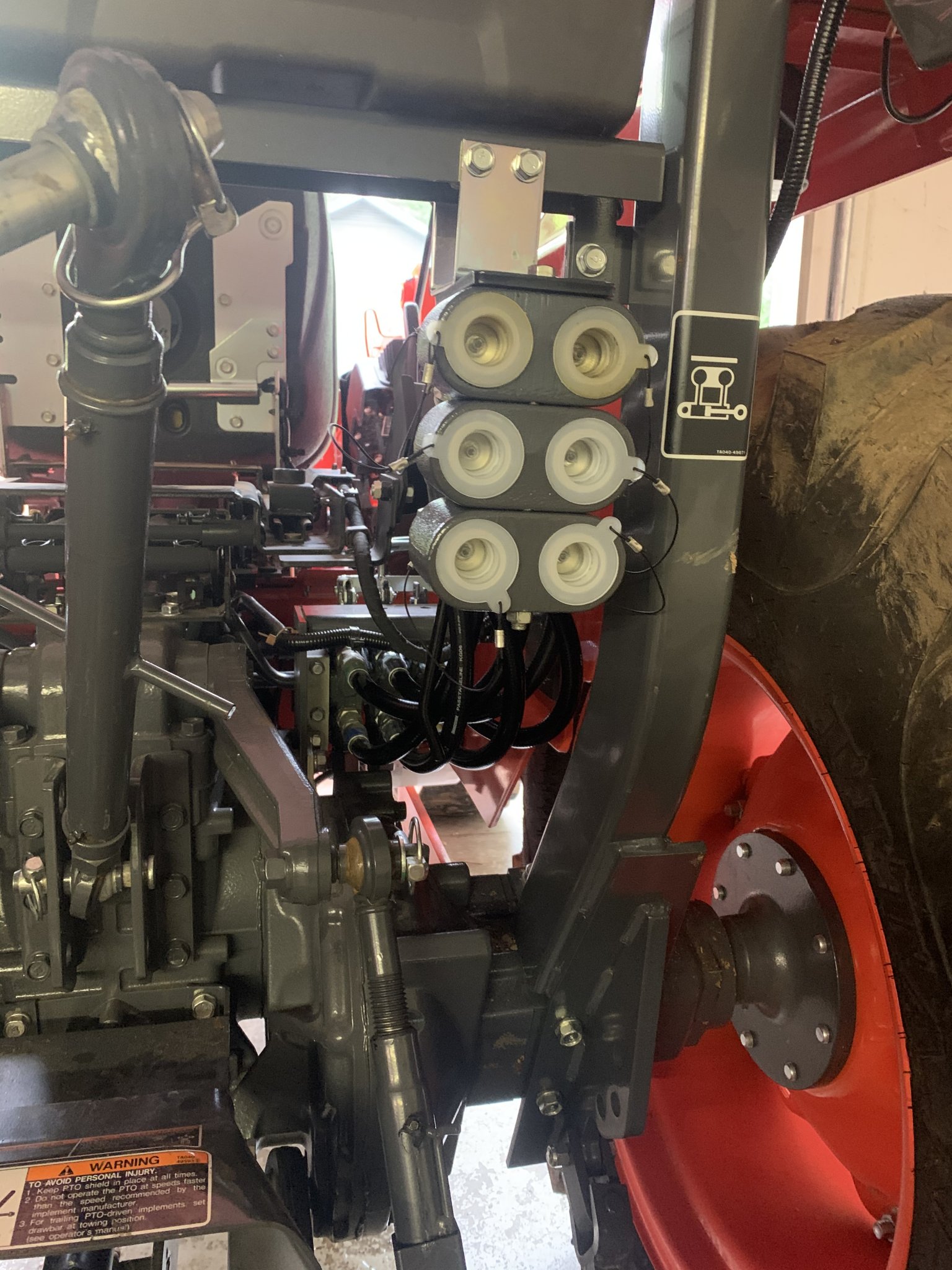

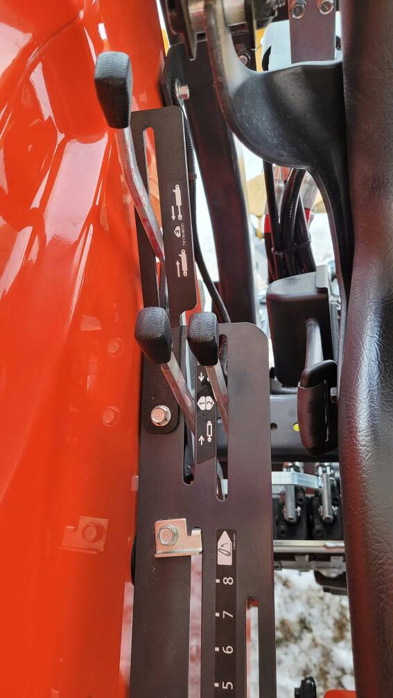

These are on my 6000. The 5400will be the same unless you are looking at a cab. The levers would be different.

View attachment 77489 View attachment 77490
OK I got it...so I will still need to install a Third Function Valve after I get the tractor to use a grapple. The website doesn't have a Third Function Valve as an option on the build.
So what sort of attachments/implements do you use the rear remotes for on your 6000? And thanks for the quick anwers

Yes, you or the dealer can install the 3rd function. It is very simple. I have done 2 so far. One on my LX and on the MX.
Top and tilt mostly. But there are many uses for rear remotes. Bat wing mowers, hydraulic rippers on a box blade, some hay tools have cylinders that need them, tons of others that I am forgetting/don’t know about.

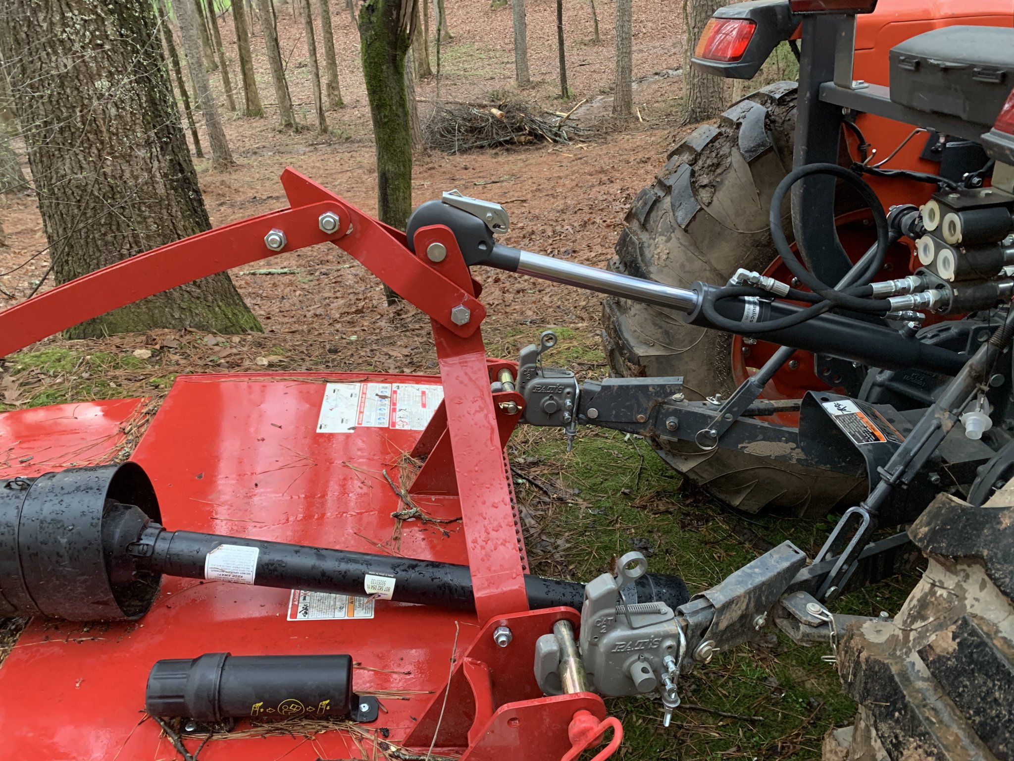

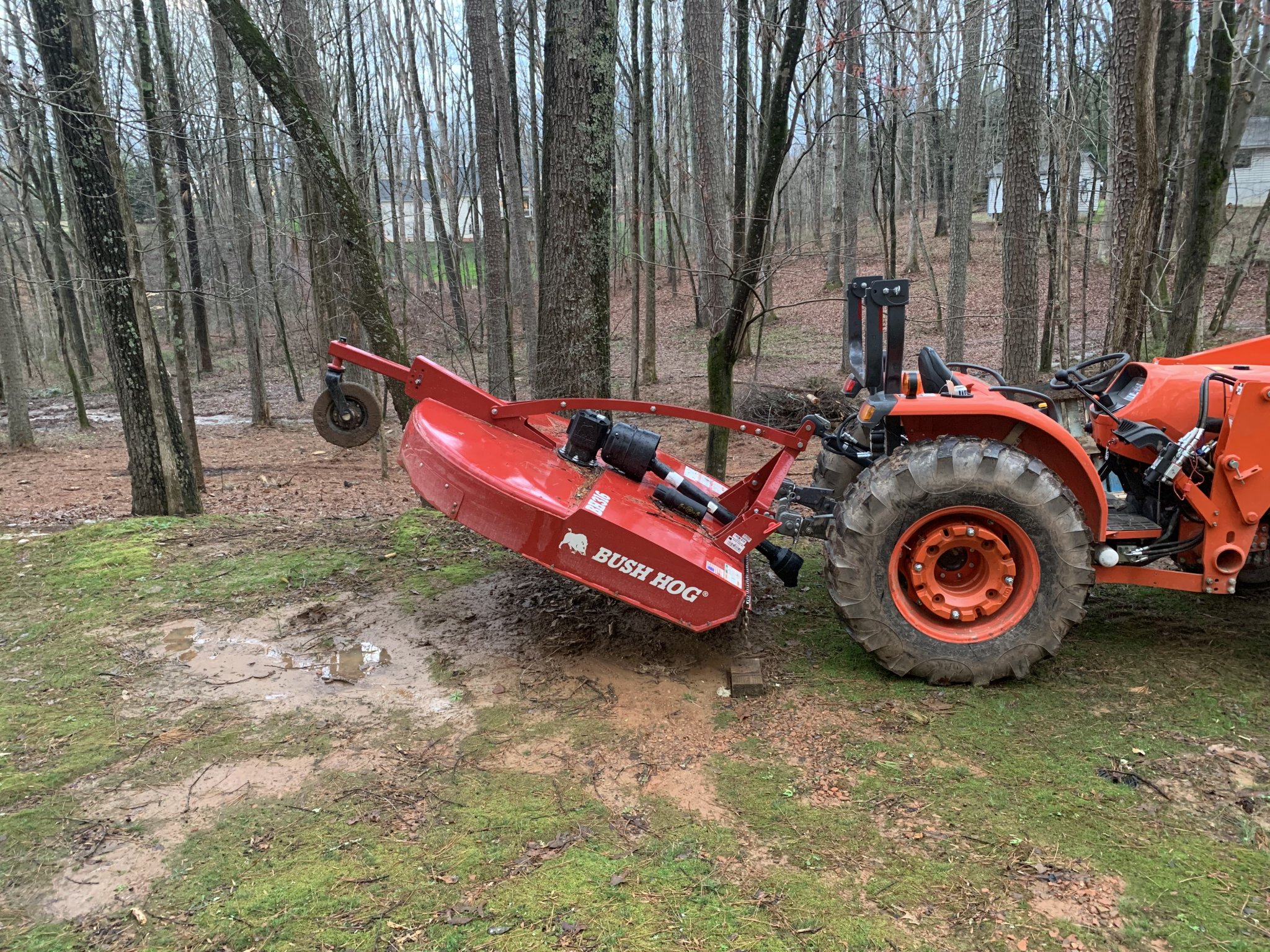

View attachment 77491 View attachment 77492
I have a quick question, where did you get those quick attach Ratt adapters ? they look sweet.

If you mean the lower links, they are Pats easy change. Those with the euro ball top hydraulic link is my version of a quick hitch, with room to actually install the PTO.
I like it. Ordered set of lowers just now online. The typical units for quick hitch seem to me would change pto shaft lengths.
Never saw this option before. Thanks 😊
