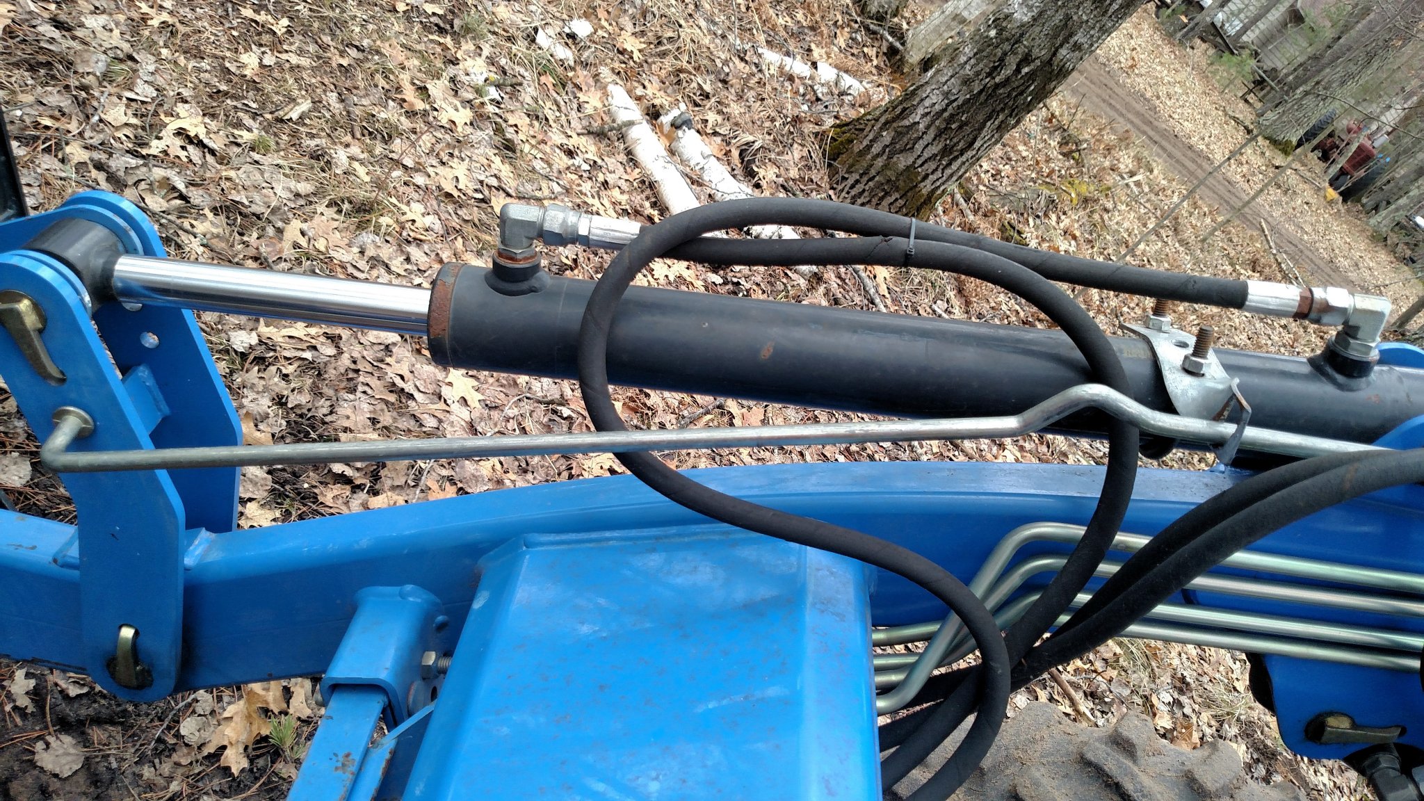

I like the style where there is a little notch in the rod that gives a little hiccup when the bucket is level. Simple to make.

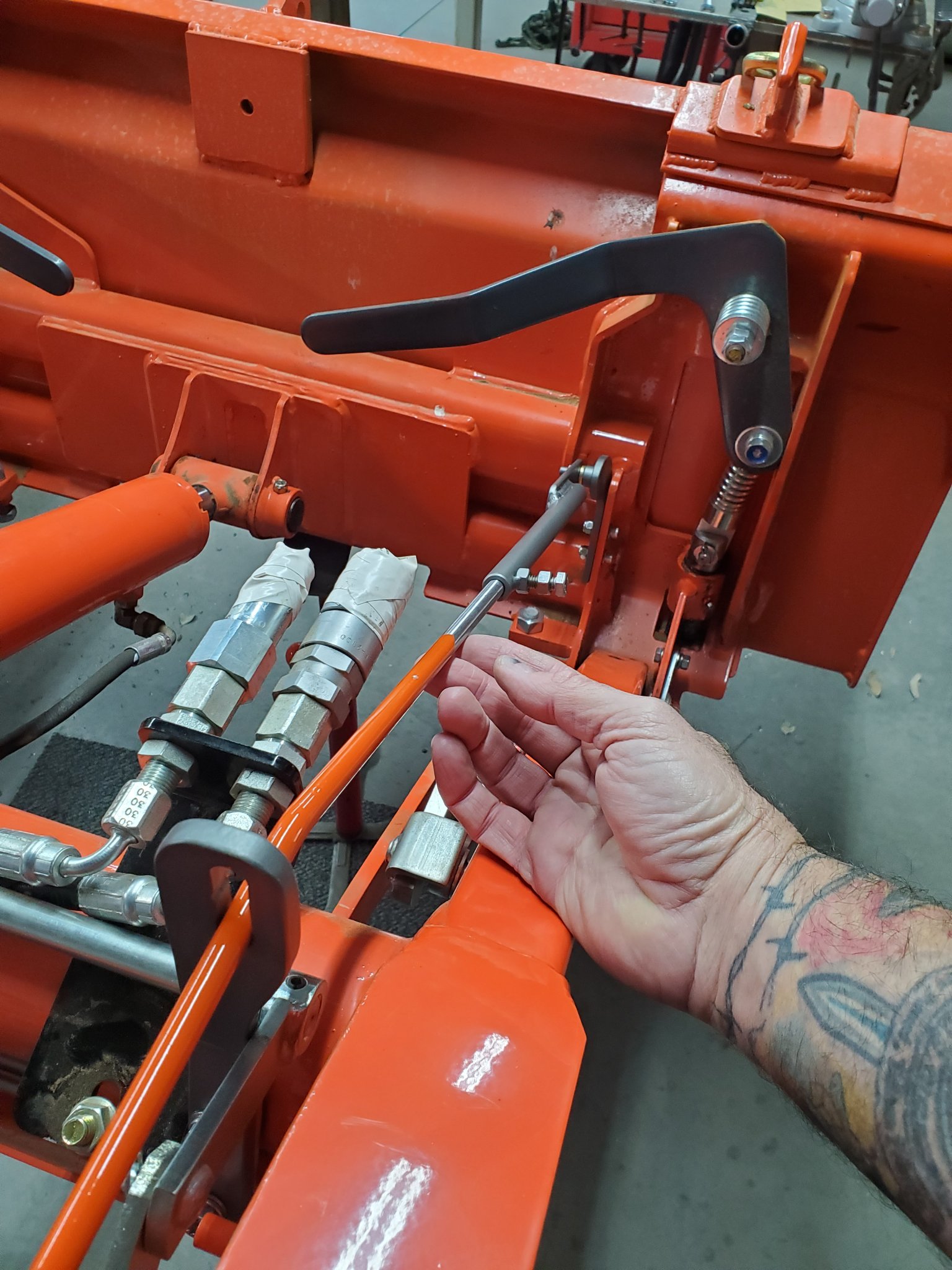

WAITING OVER HERE!
How'd it turn out? I've posted this elsewhere but, here's what I did. Same thing?
