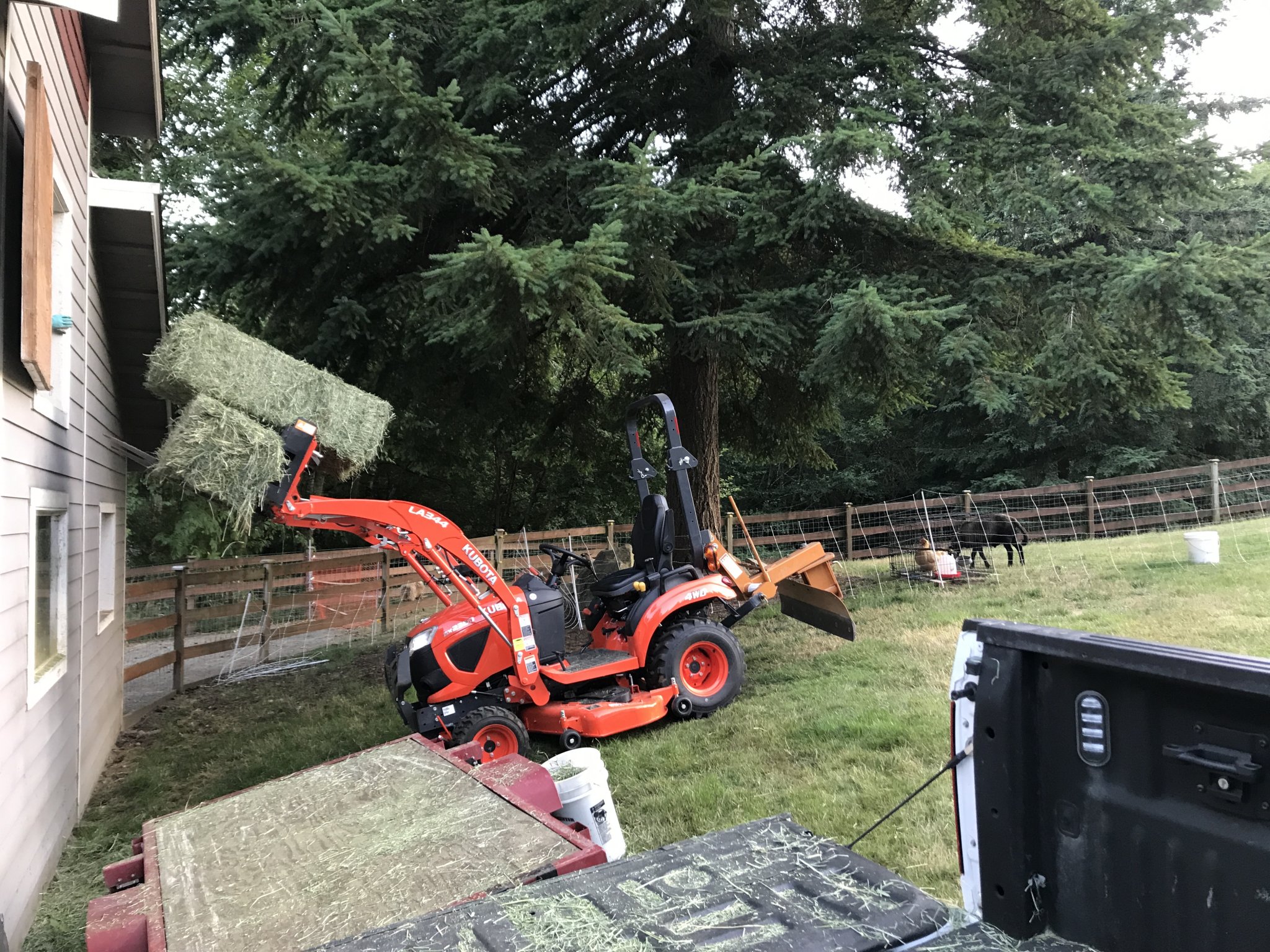

My biggest disappointment with the BX is the loader lift capacity. 900# sounds like quite a bit until you start accounting for all the actual usage case conditions:
1) the actual load is never at the pin
2) the bucket/fork weight is subtracted out
3) you want to go higher than some inches off the ground
You're rightfully worried about weight of the bucket vs forks, but, the distance from the pin maybe be more important.
In my case, I needed to go to full height to get hay bales into the loft. 2 bales (~110# each) stacked flat across the forks tops out about at least a foot short of getting to full height. But, if I stack the bails by the fork frame, it'll *just* reach full height.
Gee whiz, that #900 pounds is suddenly <200# of full useful lift.
Gee whiz, that #900 pounds is suddenly <200# of full useful lift. View attachment 73710
Build yourself a table to match the height of your trailer. Slide the bales onto the table and then pick it up to the loft from low on the table. To gain a little more height build the table to match the tailgate of the truck and forget the trailer. I do not know if that is practical due to the number of bales that you buy at one time.
Truck and trailer were both fully loaded. We go through a couple of tons a year.
Such a PITA to even need to think about a table, yadda yadda ... (Which, great minds and all -- I'm already in motion on similar thought (y))
