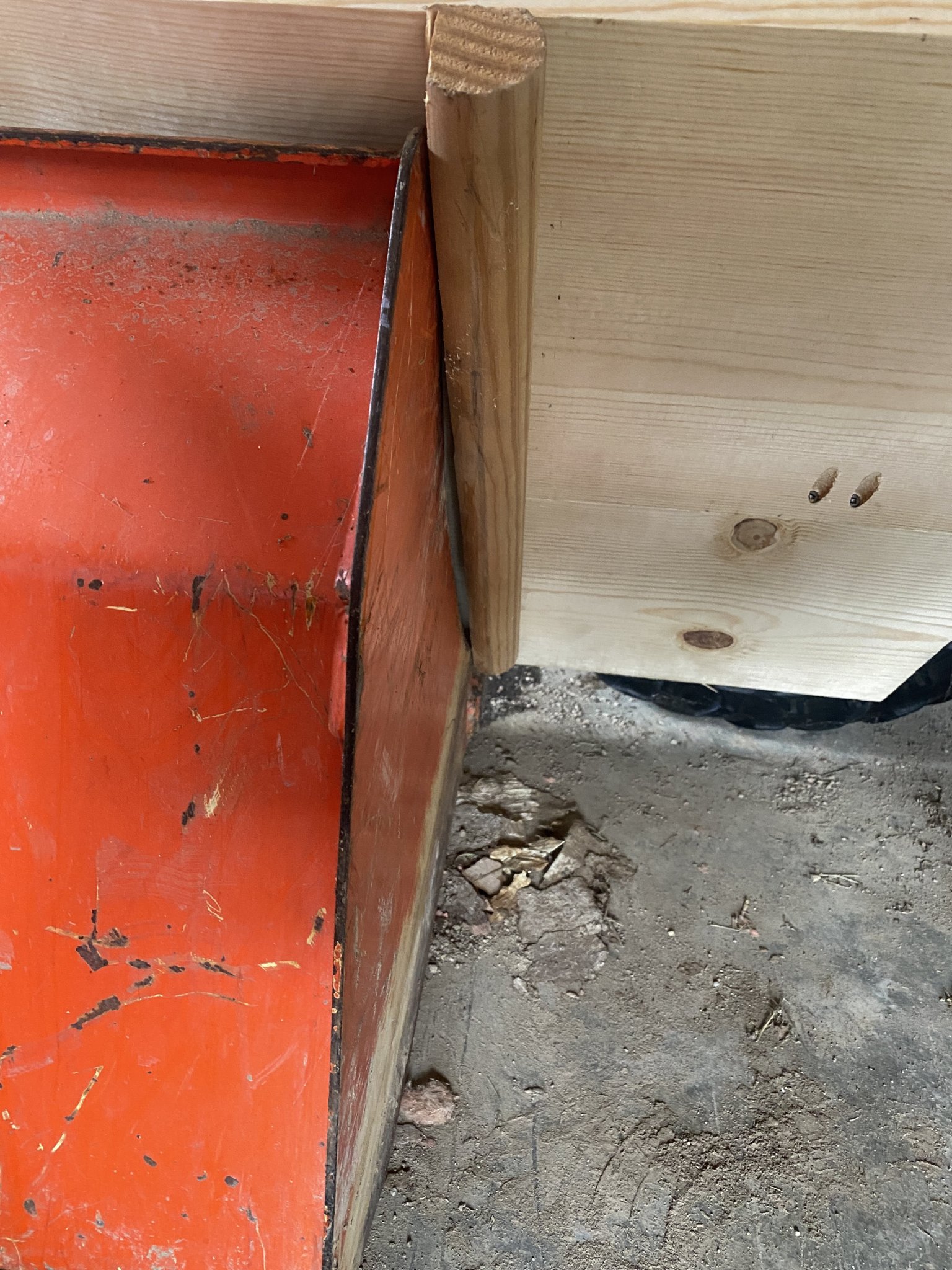

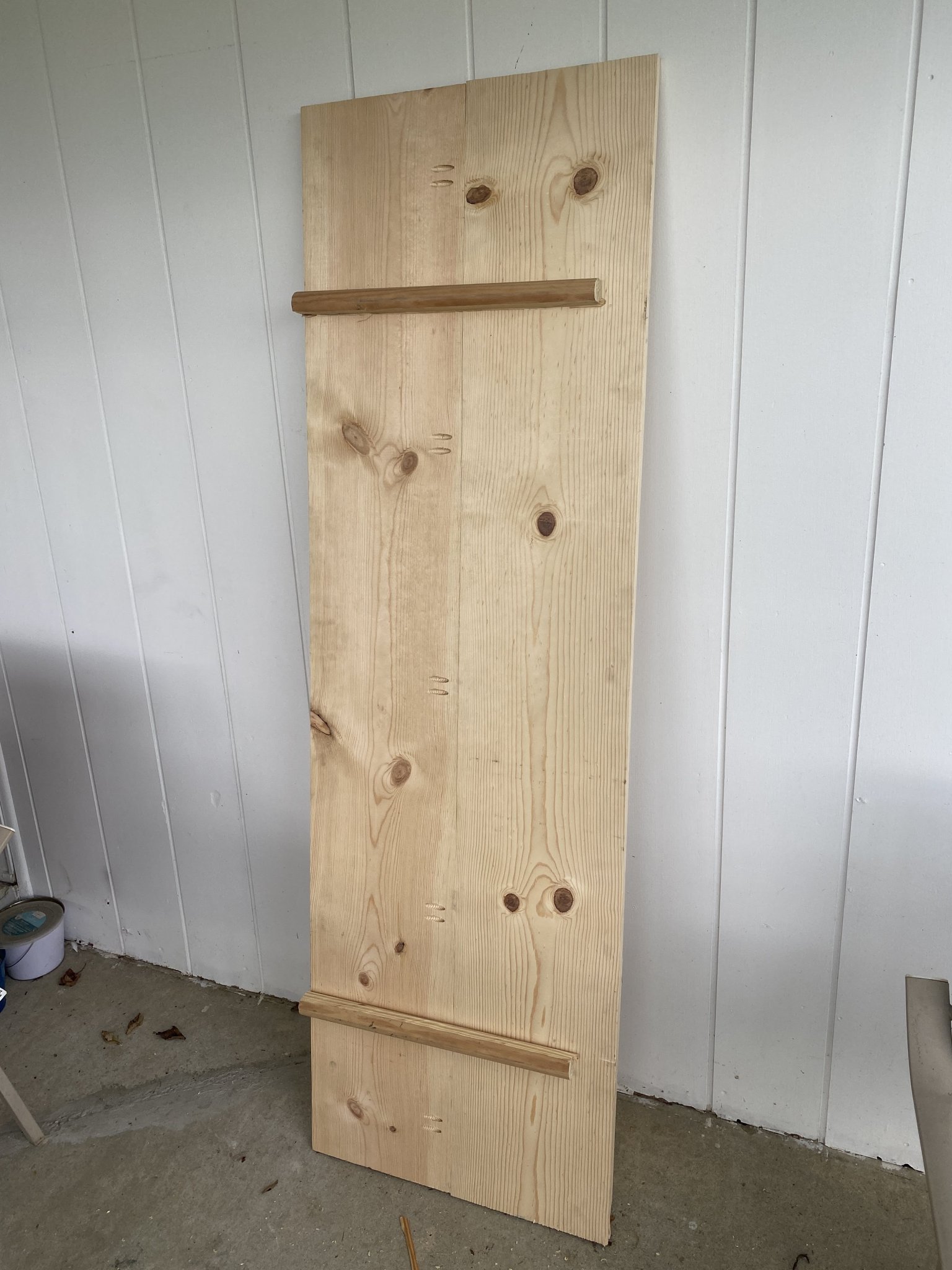

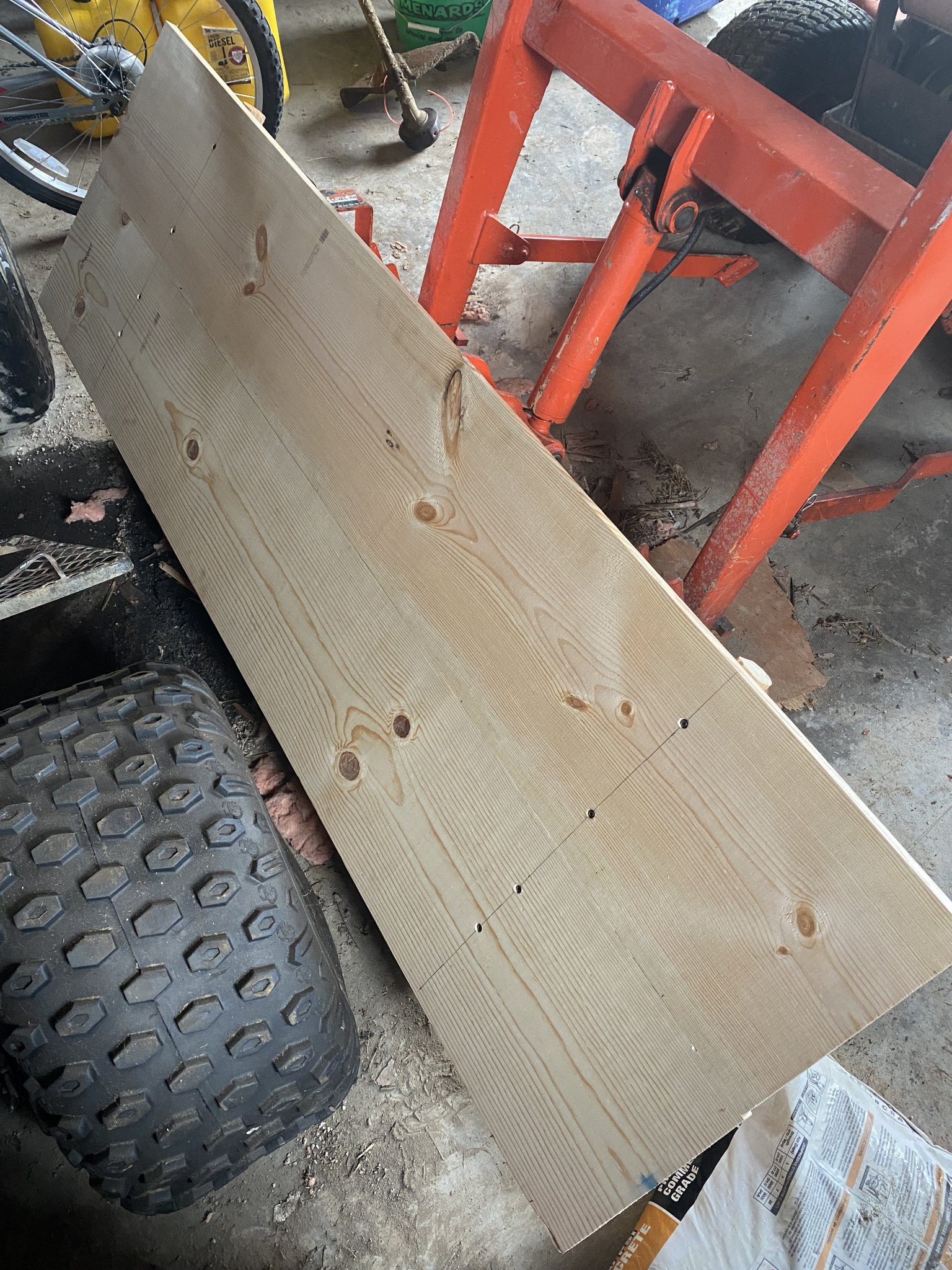

I plowed last year with the bucket. Worked fairly well but took extra passes for cleanup.
For this winter I am building something very similar to this to try. Our winters are really hit and miss. Some require a lot of snow removal and other almost none at all.
JeremyBX2200
BX2200
Aug 3, 2020
499
452
Indiana
thats pretty neat. Thanks for posting lots of ideas there.
I will post some pics after I get it done. I just ordered some bolt on hooks for my bucket. The plan is to utilize those to secure it to the top of the bucket.
Here is where I am at so far:
