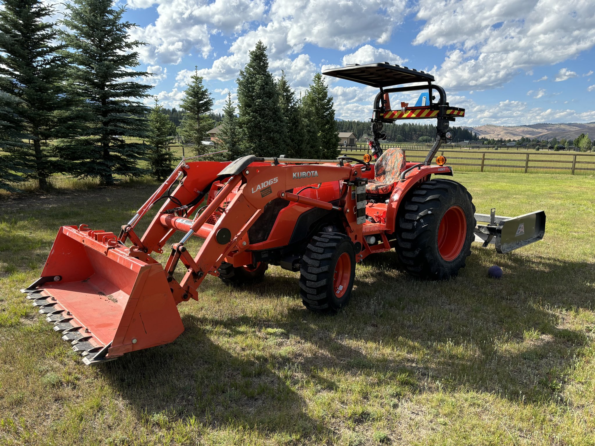

EA's Wicked Tooth Bar installed on my MX5800. Regardless of what you put on your bucket, do it soon before there's any damage to the bucket edge. It's much harder to install a cutting edge on a bent bucket.
