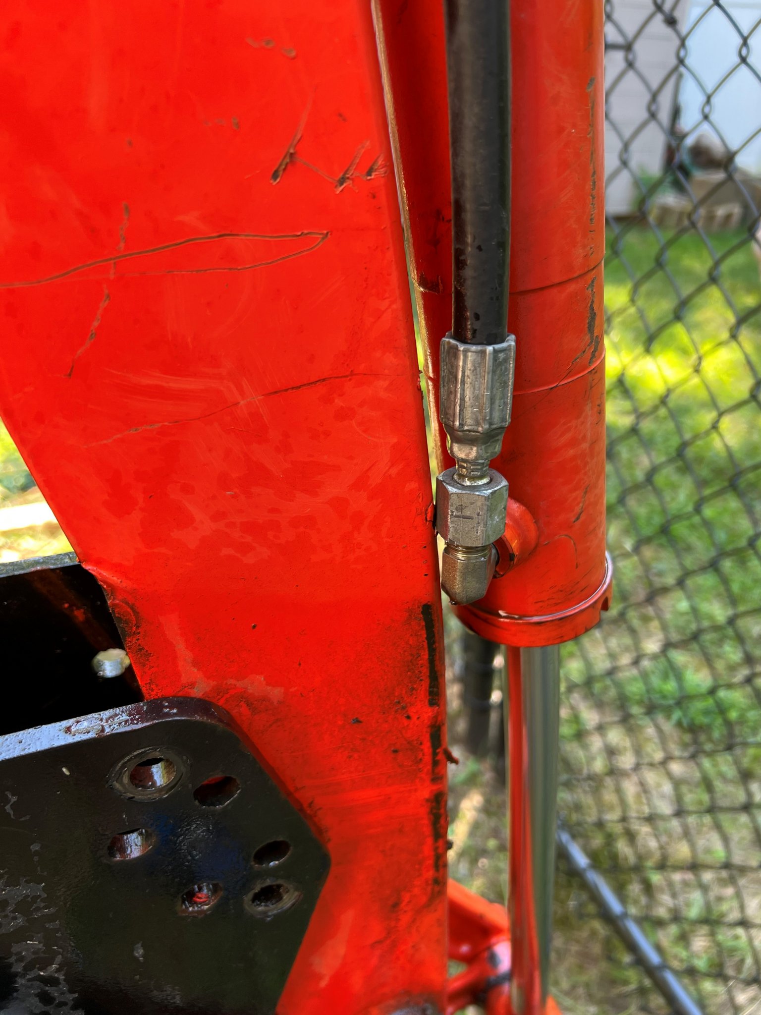

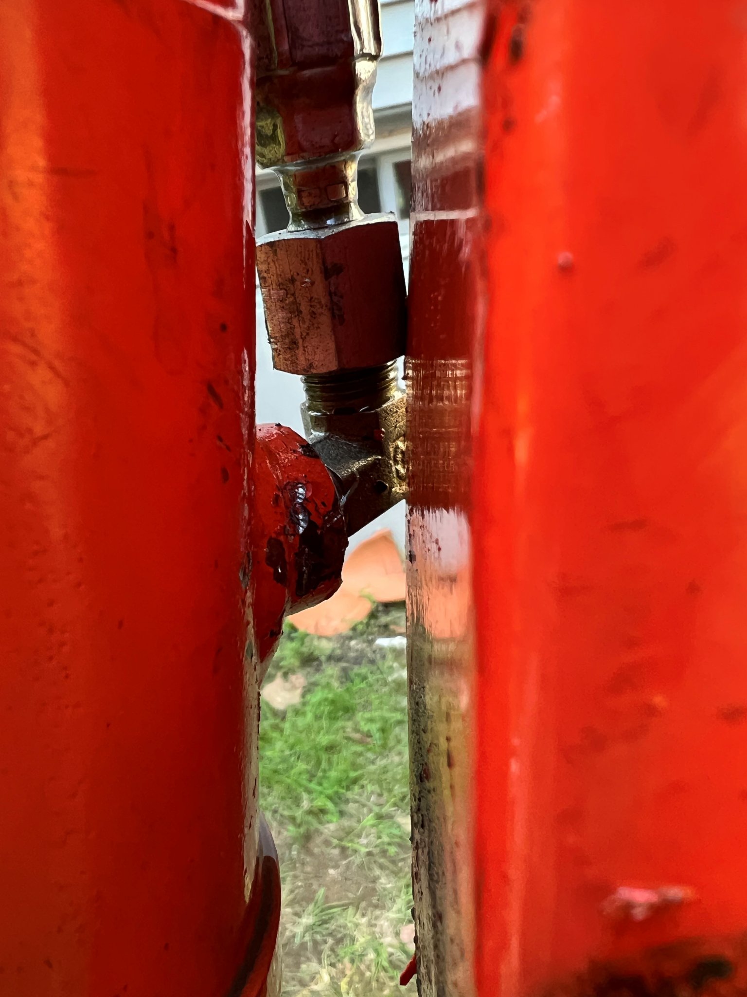

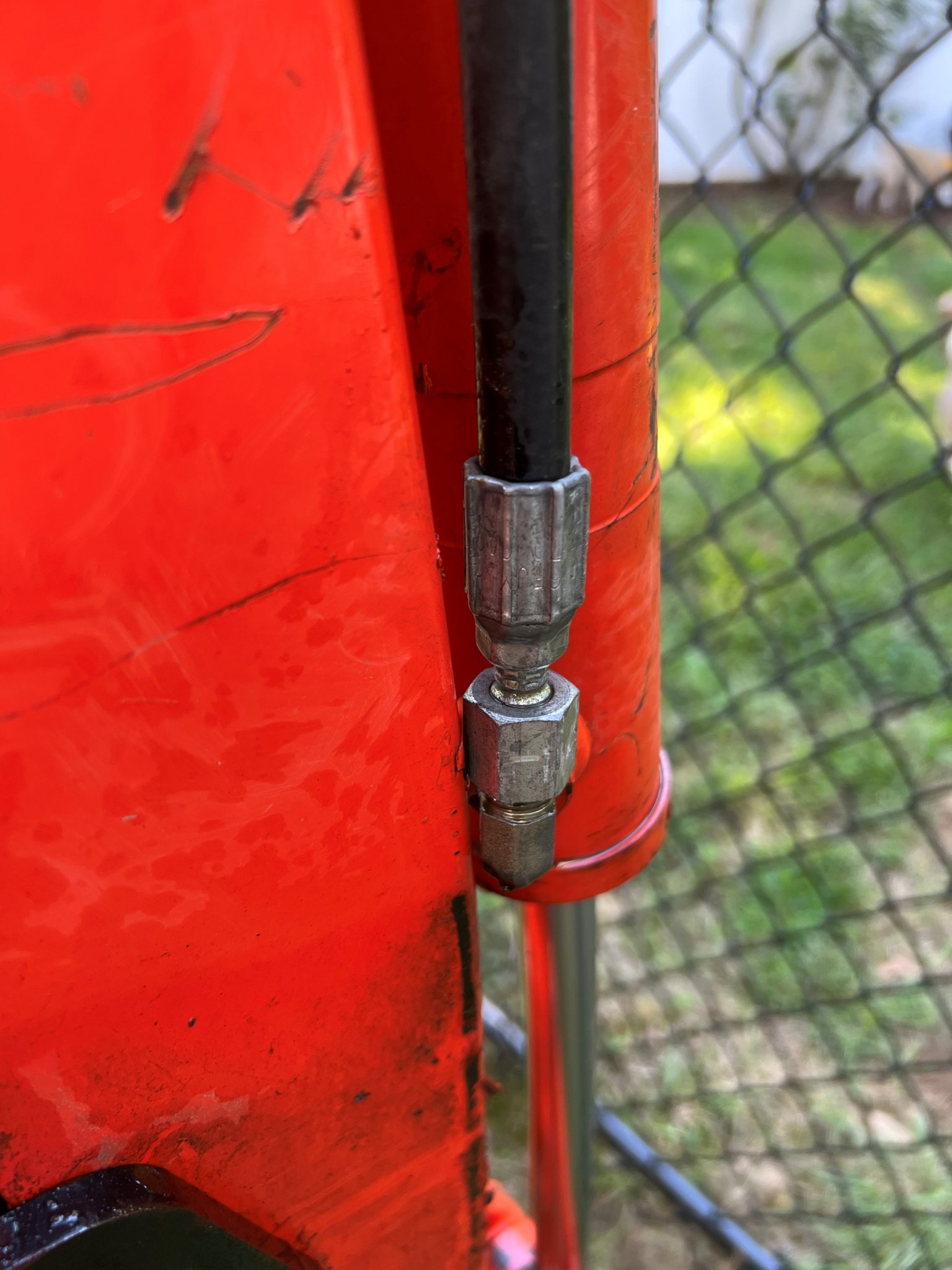

Hello, I have Kubota BT601 backhoe attachment on my BX25. while using the backhoe today, one of the adaptors broke and started leaking hydraulic fluid. Im curious to know how to repair this adaptor as the space looks really tight for me to put a new one in.

Remove the pin in the cylinder and swing it away from the frame.
