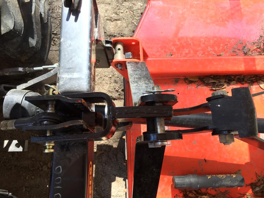

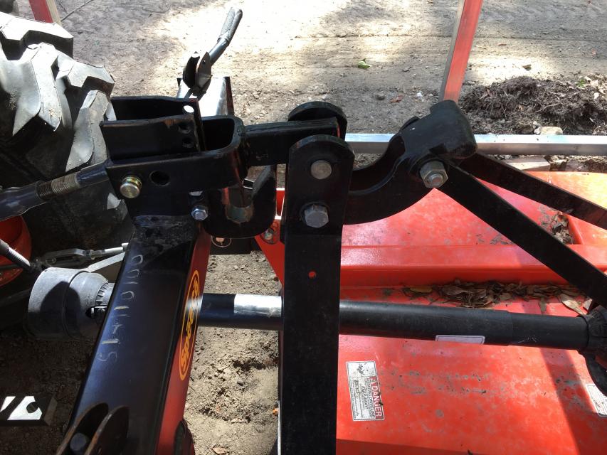

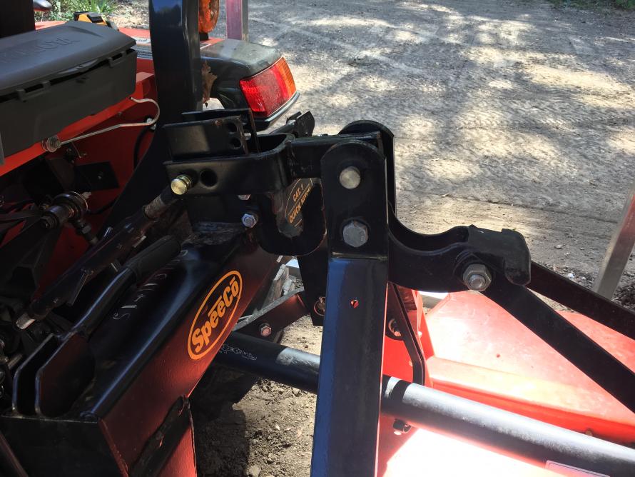

When I bought my L3901, the package included a brush mower made by Land Pride. Seems to be a pretty decent mower, if I can just figure out how to correctly hook up to my quick attach hitch.
I have attached a few pictures of how I have it setup now... can anyone tell me if this is right?

Yep, for those of us with a different model, it doesn't "look right", but it is.

I remove that 'hook' on the QH when I use the fork on my bush hog.

I have the Harbor Freight QH and the land pride rotary mower and I have mine attached the same way. I did remove the hook on the top of the QH but it may not matter on your setup. Are you having any problems with it attached this way?
