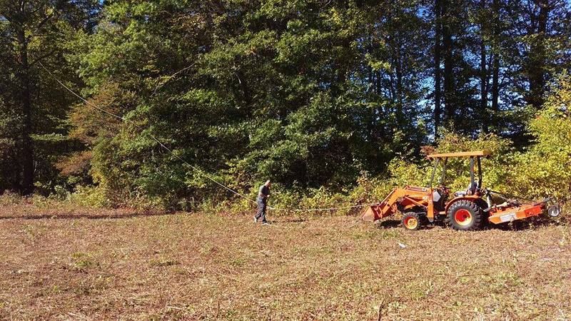

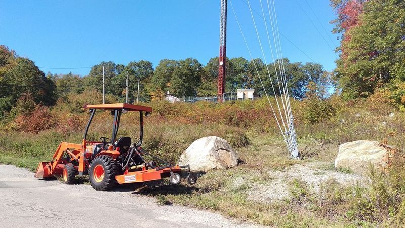

I bought a used in great shape (looked like it was used once) brush mower for use with my B21. It is a Farm Force SE made by Tarter. It looks just like this one.
http://www.ruralking.com/tarter-4-r...m_medium=cpc&gclid=CJqQrYXy788CFVVahgodOJQJ9A
I do some mowing for a man who owns radio towers. I have rented a bigger mower for $150 a day, then I rented this one for $100 and asked if he would sell it, I got it for $300 and have used it 3 times already.
