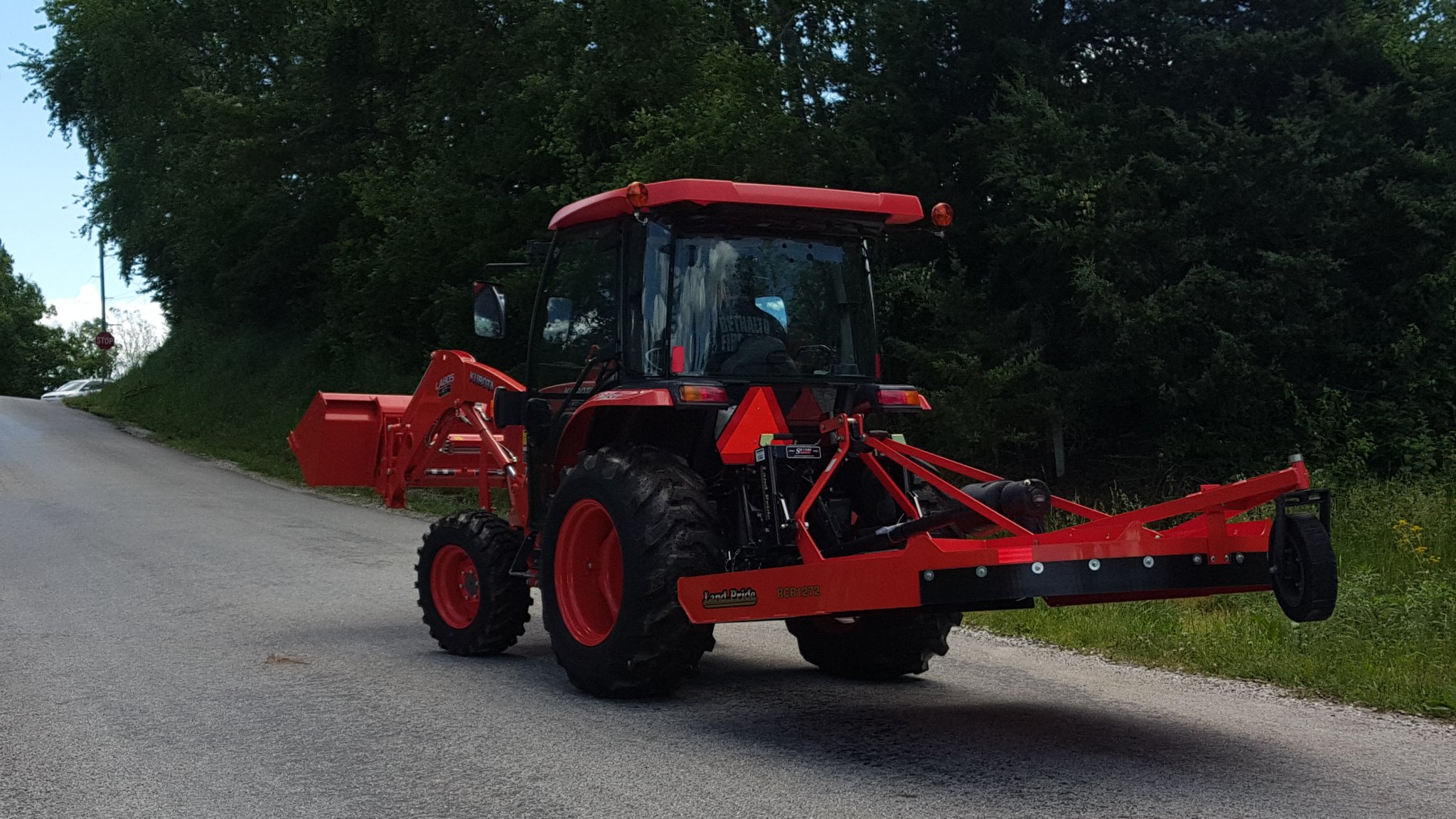

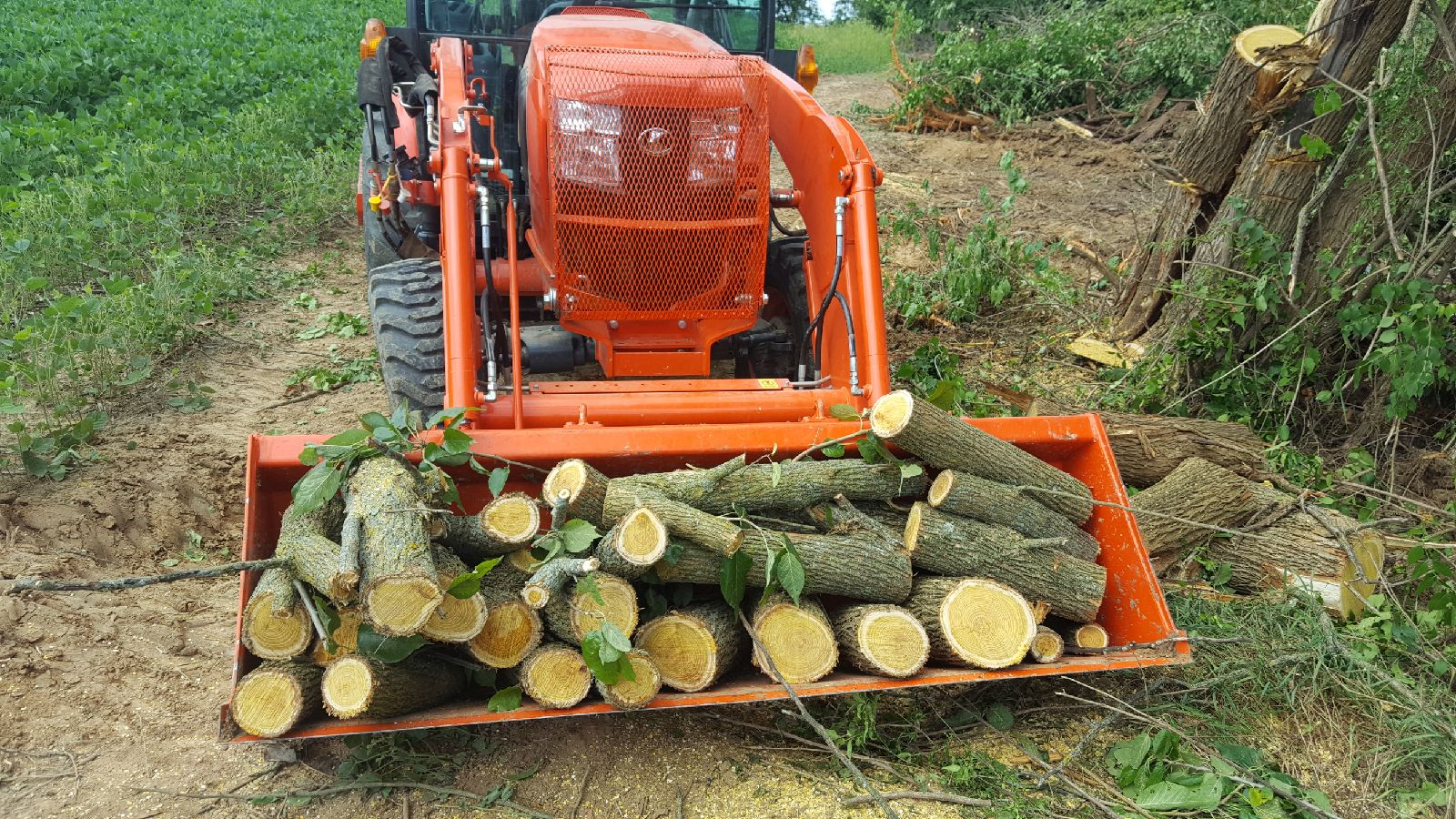

Yes we do. I just turned 154 hours last weekend on mine. My tractor is a little over a year old (got it last year on Memorial Day weekend). The tractor is nice and I believe you will be amazed with how much you can accomplish. This is the first tractor I have owned, so I still have a lot to learn myself.
Few pictures of mine. Since these pictures I have added the rear worklights and the 3rd function valve.
This is my first tractor as well. Almost got the l3901hst but wasn't that much more by the the time a fiberglass top was added than for the comforts of a cab. I also just added the rear work lights and rear wiper. Gonna do the 3rd hydraulics for front and maybe the top n tilt kit with 3rd line next
I would really recommend the 3rd function and a grapple. I have been surprised by how much I have been able to accomplish with the grapple.
