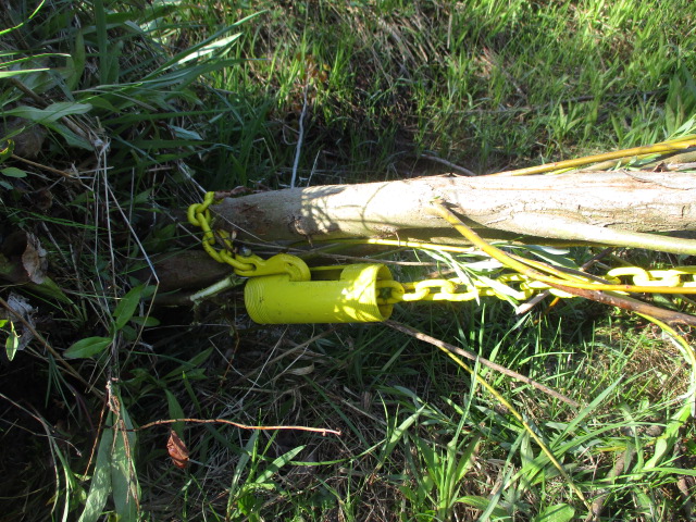

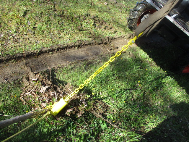

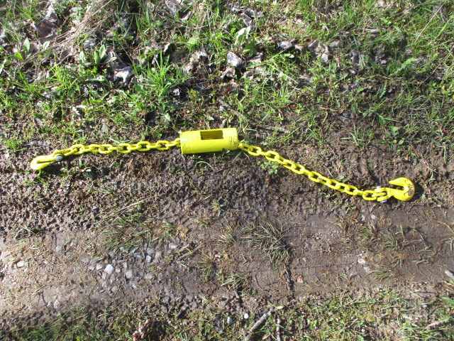

From a older topic on here, a you tube video, and some google searches..... I made this brush puller / brush grubber.
It works pretty good..!
The pipe is what really grabs the trees. Stops it from slipping off.
The only way I thing someone could improve on this, it to grind / cut teeth into the end of the pipe where the chain comes out, the end that grabs the tree.

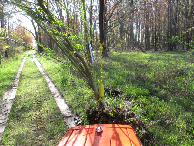

I have been using the front bucket on small stuff. And then hook up to the rear drawbar for larger clumps for brush and a stump I had to pull out.

What's the largest stuff you've pulled with it?

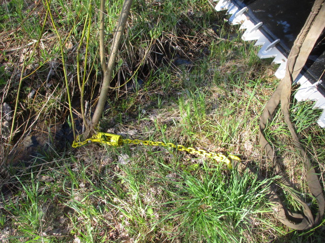

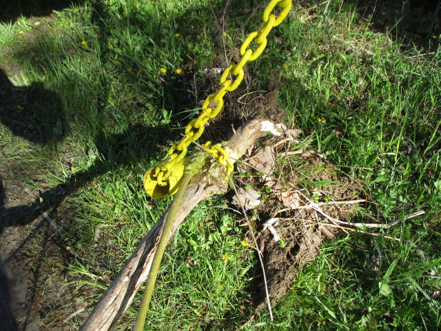

BX 25...... This past weekend, i pulled out a 4-5" tree stump with it. I cut the tree off at about 36" high, and hooked up the grubber just below the cut, had it hooked to the drawbar, pulled it to the left to get it loose, then pulled it out going to the right.
The bucket i use it one only for the small, 1 " , 2" diameter willow trees that were growing in the ditches.
McFarm..... i pulled out some small trees , brush with mine, maybe about the diameter of your fingers, it pulled it up and out.
I would cut that stuff, but then next year, instead of having one tree, there's 3 -4 growing for the cut stump.
Pulling them out is a task , a pain, but there out and don't grow back.

Not sure what you mean by a " slip hook" ..?

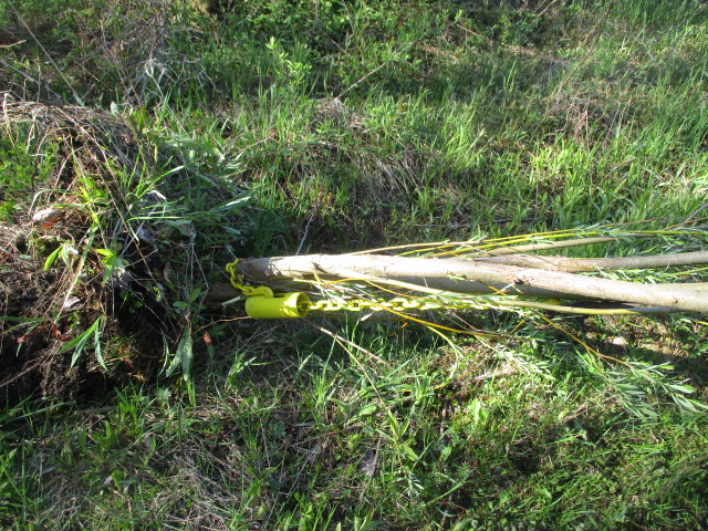

The small hook, hooks onto the slot in the pipe, the other hook , hooks onto the strap or bucket.
If i made it over, i'd use a longer length of chain. but this chain is what i had in the garage, its enough, but on some of the larger brush/ multiple stems/trunks, it's tight to get around.

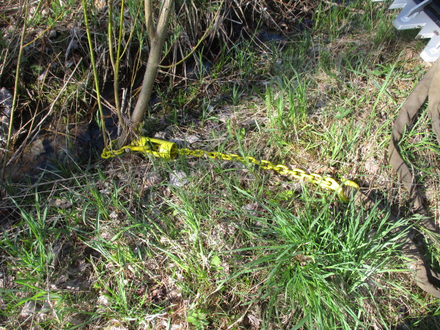

The pipe acts like the slip hook.
The small grab hook can go thru the pipe. The big regular hook can not.
The pipe slides on the chain over the small grab hook, the grab hook goes around the brush / tree that I want to pull out, then the grab hook gets hooked on to the slot in the pipe.
The big hook gets hooked onto the bucket or draw bar.
then the chain slips thru the pipe and tightens up around the tree/brush.
and the pipe's edge / mouth "bites" into the tree's bark.
Pulled quite a few out, only one slipped off.
