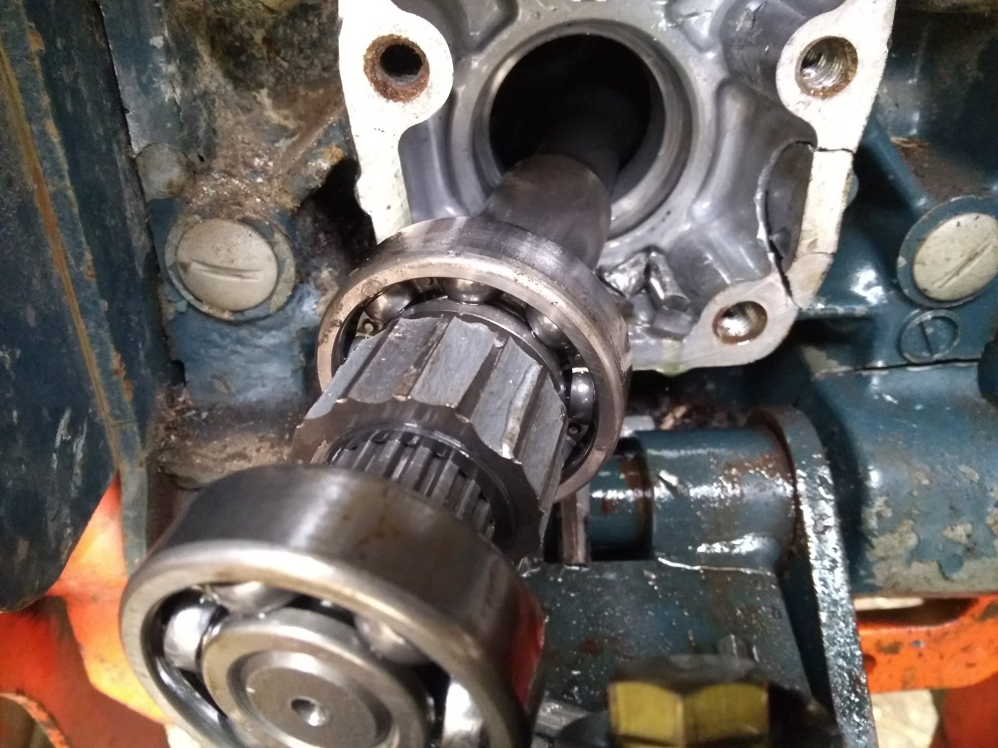

What ever caused the lower ears to be cracked/broken, is probably the root cause of the pto failure.

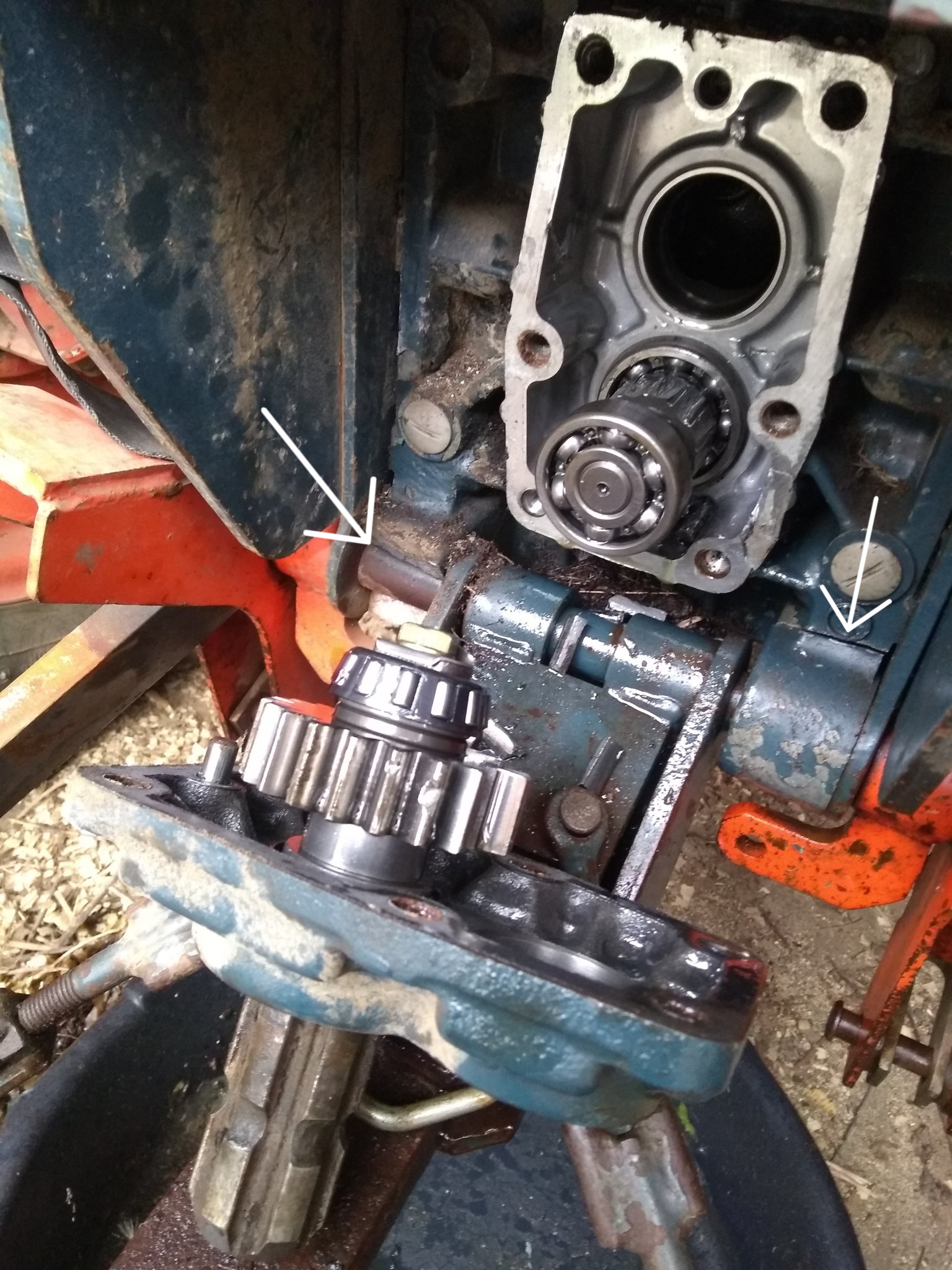

I see six threaded holes for fasteners and one hole for a locating dowel.
One hole is filthy. Was there a fastener there?
One hole in the upper left is not round.

And what is up with these areas?

Based on all the cracked castings the 3pt has been badly overloaded. JB weld is not going to fix that. It would be a challenge for a skilled welder.
All the bolts came out fine,it looks oblong because of wide angle photo.
I was only going to JB weld the area that cracked by the PTO cover right side., not the lower supports

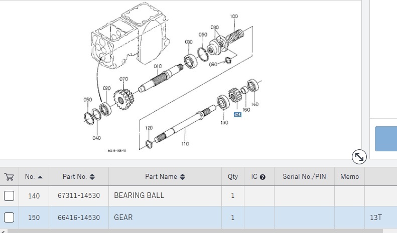

It looks like the damage started some time ago while a rear attachment was being driven. A gear tooth in the 150 gear likely broke out and later, while using the mid-pto, the broken tooth became jammed, breaking the rest.
It may be possible to replace the 150 and its mating gear - but other parts may be damaged. Its a pretty serious failure - reinstating the pto function may not be easy.
The bolts came out fine, upper hole s look oblong from wide angle photo
Yes, I agree, hopefully not more damage internally.

Looks like I would have to replace the case to repair ,does not look weldable.
A good welder could probably build up the missing sections. Then it would need machining. The 3pt is useless as is and trying to use it would be a recipe for more damage/expense.
