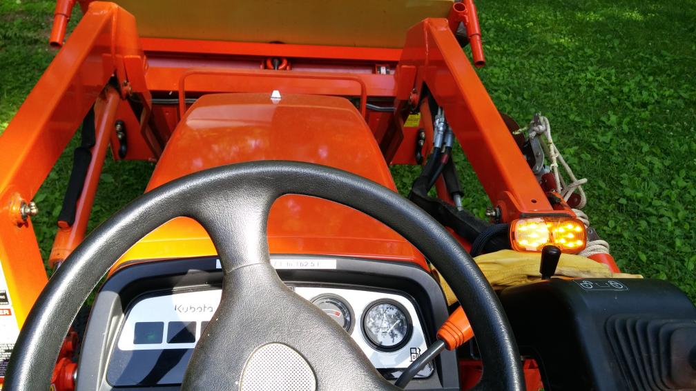

I added a switch (a sealed magnetic switch used in an alarm system) underneath on the brake pedal rod and the switch activates the flashers when the brake pedal is pressed.. Since the flasher lights are behind the seat on my BX2230, I added an additional LED "clearance marker" light up front in my field of vision..

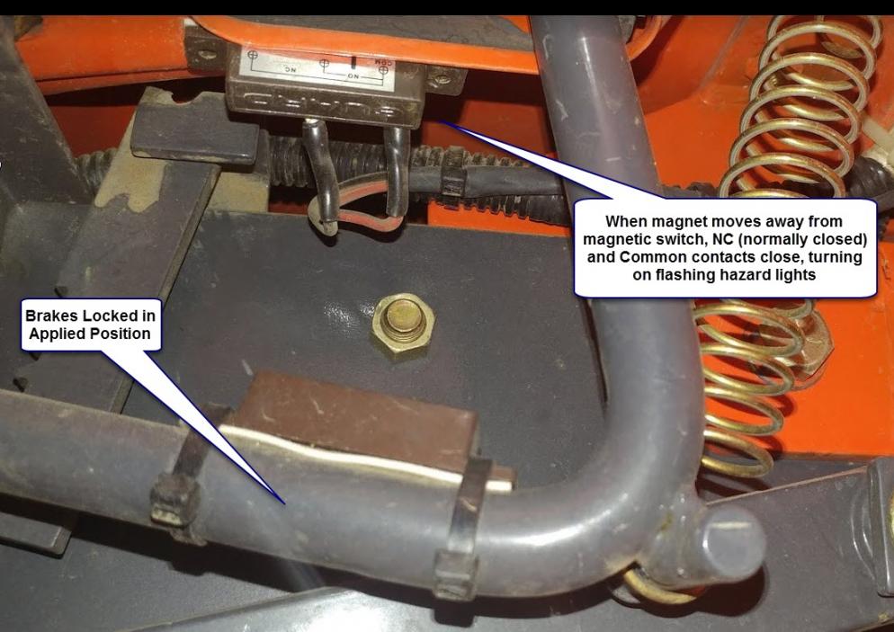

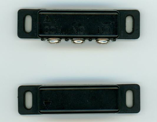

This was a DIY project I did.. The only part somewhat specific to the application is the magnetic switch.. You need a single pole/double throw magnetic switch i.e. 3 contacts Common, N.C. (normally closed) and N.O (normally open). Magnetic switches work best as they are sealed from the dirt and grime that is bound to get inside a non sealed switch.
Most magnetic switches are just single pole (2 contacts).
The 3 contact magnetic switch is needed to detect the brakes off (pedal in the resting position) which will be the only location where the pedal will consistently be in the same position. This is the same as the brake switch in your car, the brake pedal at rest presses against the switch keeping the brake lights off. The brakes applied position will always vary based on pressure applied and brake wear/adjustment.
The normally closed and normally open refers to the position of the contacts with the switch is in it's resting position (magnet not next to the switch).
For the flasher lights to be off when the magnet is next to the switch (brakes off), and to turn on when brakes applied & the magnet moves away from the switch, you would wire the lights using the "common" and "normally closed" contacts.
I wired the magnetic switch in parallel with the flasher light switch on the instrument panel of the tractor.
The extra LED yellow clearance light I added up front can be found in any auto parts store.
The appropriate magnetic switch is available on Amazon.com
https://www.amazon.com/Directed-Electronics-8601-Magnetic-Switch/dp/B0009SUF08
In installing the two components (the magnetic switch and the magnet that activates it) alignment needs to be right for reliable operation. The two little triangles visible in the photo need to be oriented to be on the same end as the magnet rests next to the switch.
