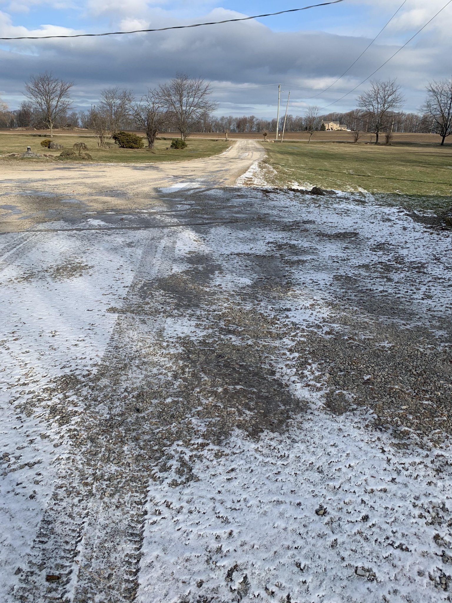

I attached a few pics, right now its frozen so its pretty solid. As soon as it thaws it becomes a mess, my reason for wanting to add some material. I just purchased the property, so I don't know whats under the top layer or this history. All i know is that its been neglected.

Looking quickly at your pics I would think the Box would work nicely to dig in and fill in those voids and shape it a bit for drainage. I'll let others with more experience chime in but I wouldn't hesitate to attack that with the box blade.
On the other hand, the dog will have to move.....the blade would be hell on the dog......

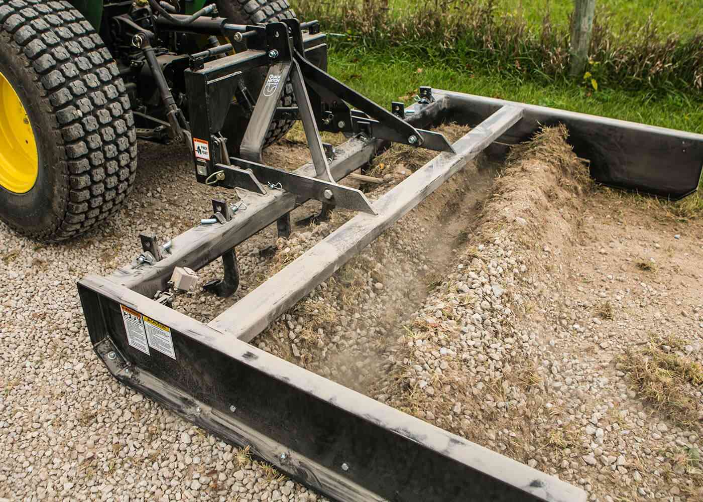

Some of the replies here seem to indicate using a grader blade rather than a box blade. I think we need to be clear about which tools we are talking about in our suggestions. There are 3 tools at play here in the replies. I will list them in the order I personally think are best for the job for the OP
1: Land Plane. Its literally designed and built for driveways and road grading. Its as simple and dropping it down and going forward. Take as many passes as you like. Its simple, its easy, and it produces the best looking driveways with the least amount of effort. You can find them with and without scarifiers teeth. It breaks up the ground in its path, passes that debri over2 blades that help break it up and loosen it, then allows it to resettle right back down on the surface. Great for resurfacing, or getting out pot holes or uneven areas of driveway, or making a gravel drive way look more like it did when you first put down the gravel. It will shuffle the rocks back to the top of the surface. It doesn't drag or move the debris like the other two options below, and doesnt typically create clumps or leave mounds at edges. The downside to a land plane is its really only good for this one purpose. The blades are low and angled specifically for the purpose of grading, so you can not use it to move material or push things. It is a specialty tool, in that it does one thing really well.
2. Grader Blade. A single tall blade, taller than a land plane, but can be angled and rotated to work in ditches and other areas. Works good if you want to try and put a little crown on the driveway. Rather than redistributing the earth back down evenly in its path it pushes it all off to whichever angle you have it set at, so it may leave a row of raised earth/debri at its edge. It has more uses though than a land plane - you can drag dirt or debri if the angle is squared. You can use it to reverse into stuff and push things like a small dozer blade.
3. Box Blade. It's a grader blade inside of a welded box meant to trap debri, dirt, rocks, surface material and not let it escape out the edges. To me this is the worst tool to try and work a driveway as it doesnt allow any easy way for debri, rocks, surface material to redeposit onto the driveway. Takes more skill to use for this purpose, and in my opinion still doesnt have the same results of a land plane. If you want to strip top layer, or move material, a box blade is perfect. It also can reverse push like the grader blade, as it often has blades that face both directions so you dont have to rotate it. If you just drop it and drag it will create a nice smooth path, but you will end up with a big bucket of dirt at the end, so if not careful you will slowly dig your driveway down lower and lower everytime you grade it. Material needs to be redistributed, which is why I think land plane is so much better.
