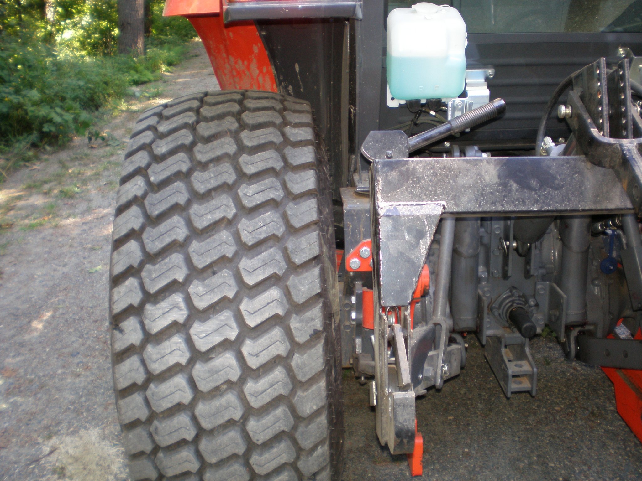

2" Bro-tek spacers installed. Ordered thursday, arrived wednesday with monday being a US holiday.
Fitment was great. Only issue I had was one original lock washer spread when I was torqueing the wheels down. I had another one that I replaced it with. We'll see how well they work. Here's a few pics.

The online instructions were a big help. After a quick glance at them the whole process took about 20 minutes. Great quality, easy install, makes the tractor look more tractory ;) I'd highly recommend the Bro-Tek spacers.

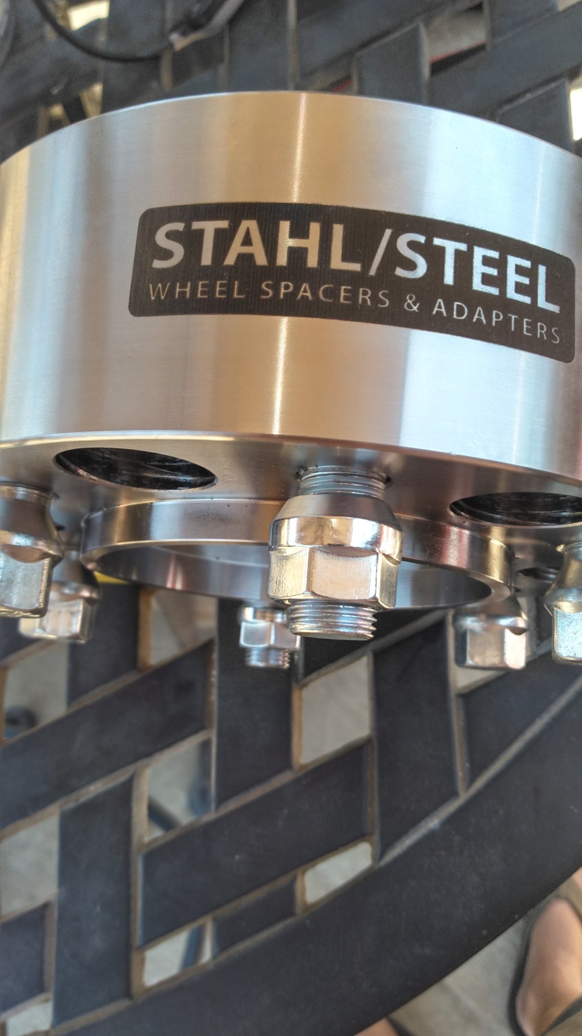

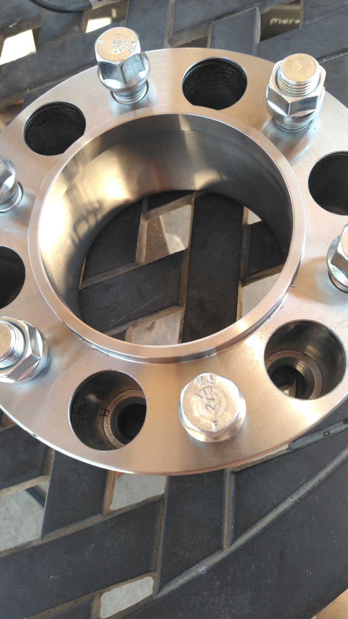

I ordered the steel ones from Bora (Stahl) mostly for the strength. The weight helps too, but it's just a couple lbs.
Aluminum one's are painted or anodized in orange.
I'll paint my steelies in Kubota gray or orange when they show up.
I'll have a better opinion once I actually receive them.
From what I understand Motortech-Sport makes Bora which is aluminum. And Stahl which is steel.
NorthwoodsLife
Oct 15, 2021
1,410
1,476
Wisconsin
These arrived today. Almost too pretty to bolt on the tractor hub. KIMG0700.JPG KIMG0701.JPG

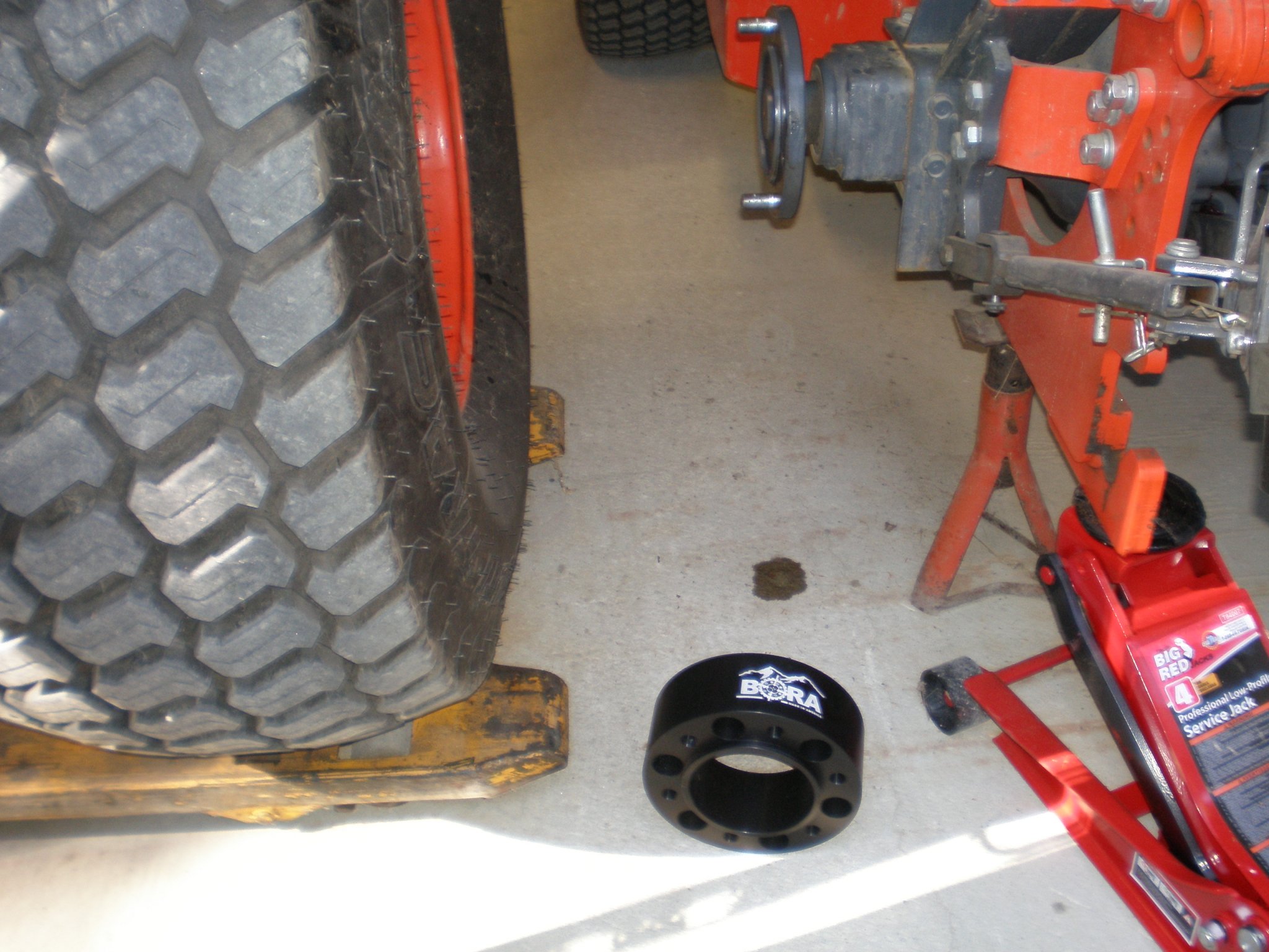

Skeets, I got my BORA spacers from UTV parts and accessories. With my L3560 cab, it is tippy on the steep hills I have. I got the 3" spacers and they were $320. with free shipping. They help a lot, but I'm STILL extremely careful on the hills and try not to get too carried away going sideways on the hills. I also added a tiltmeter to View attachment 55861 View attachment 55861 View attachment 55862 it to help keep me informed on my angles.

I forgot to add the picture of my tiltmeter. I got it from the sales section on TBN. As far as the installation goes, I jacked up the side I was working on, loosened the bolts (almost couldn't get them off) and used a pallet jack to glide out the tires and slide them back on when the spacers were on.
