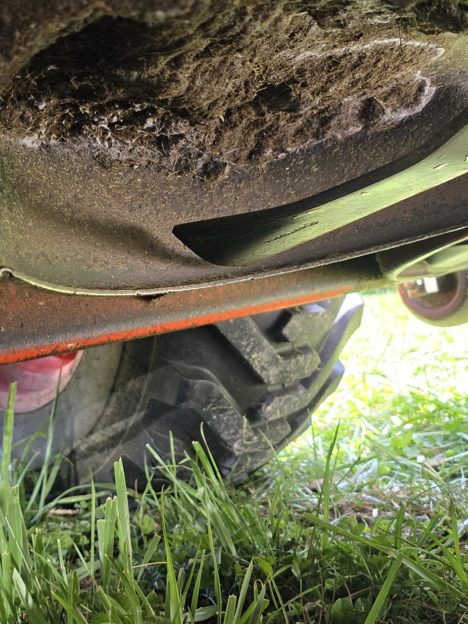

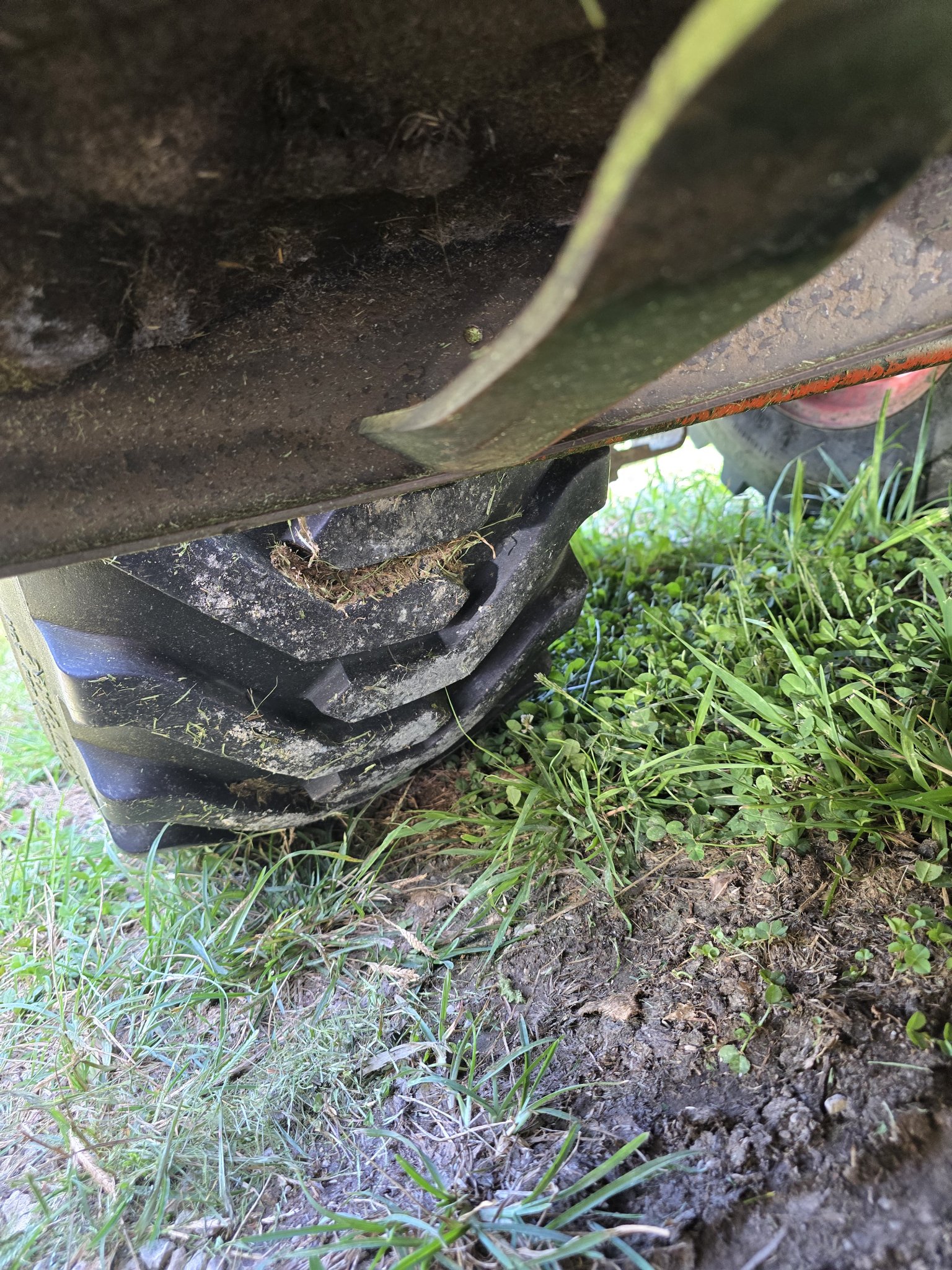

I have a bx2680 with a 5 foot deck. Recently, the blade on the side with the grass chute is about half an inch lower than the other two. It's cutting level with the bottom of the deck while the others are up inside the deck. The spindle housing and spindle are new and everything is tightened. Even when I try different blades, I still have the same result. What could cause this? Thanks.

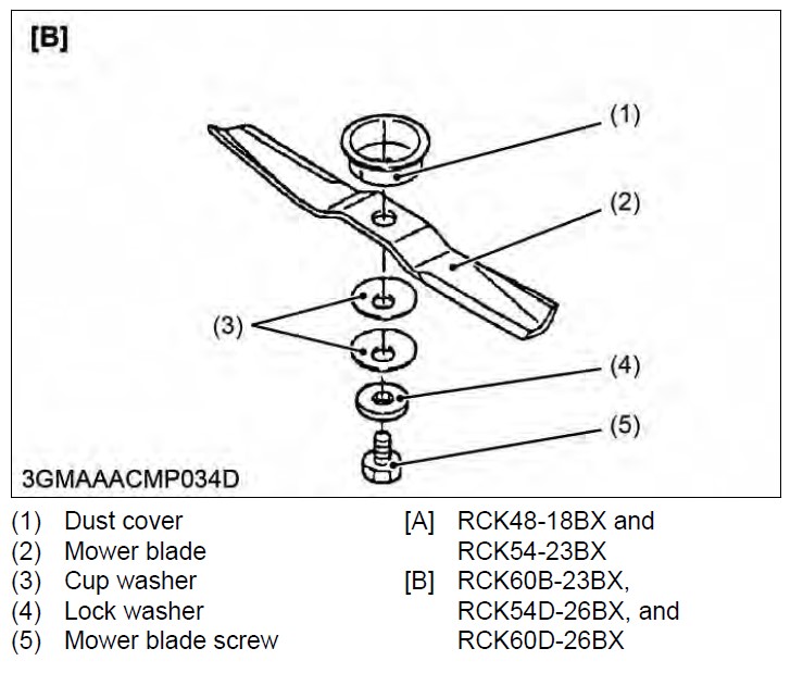

Are you sure the cup washers are on the correct side of the blade? Check for debris under the Dust Cover (1).

Everything was tight when I took it back apart to check it so nothing came loose. I had the blade problem before I changed everything. I got a new spindle and housing cause there was wobble in the pulley so I thought that they bearings were shot in the housing and that I had slightly bent the spindle. I do a lot of mowing so I didn't have time to wait for the dealer to replace the bearings in the original housing. Everything was put on correctly. No debris, dirt, etc is blocking the dust cover from seating properly. I've tried a few different blades and all of them will be at the bottom of the deck while the other two are about a 1/3 of an inch or so above the bottom of the deck.
