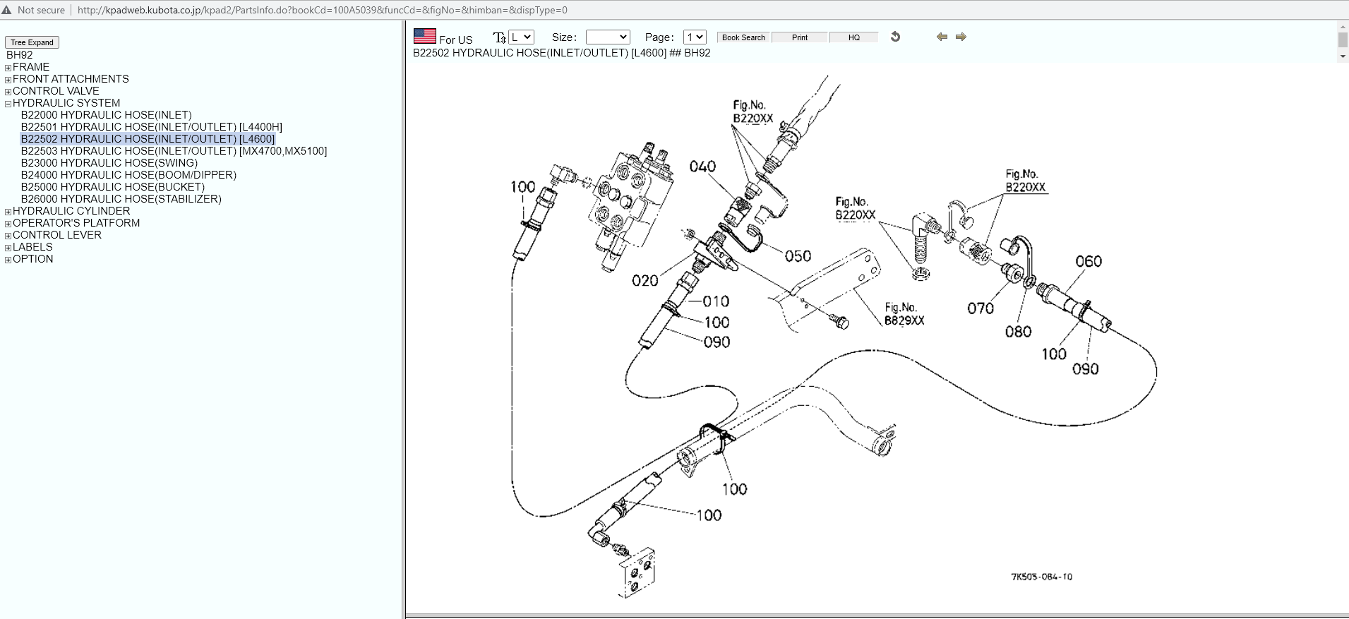

I know nothing about that hoe but this doesn't sound like rocket science. I suspect the two hoses you have are the ones that stay on the hoe when it is dismounted.. You need two additional hoses that come rearward from the hydraulic block / loader valve and stay on the tractor. Quick couplers are used to connect the hoses on the hoe to the ones on the tractor. Here is a parts diagram. When the hoe is dismounted the hoses on the tractor get looped together - e.g male tip #70 gets connected to female coupler #40. You can roll your own or purchase the whole goods hose kit for your tractor from a dealer.
I do know a little about the remote valve kits and I don't see how they would help. The 3 hydraulic connections are all made internally through the adapter block that mounts the valves to the side of the transmission.
