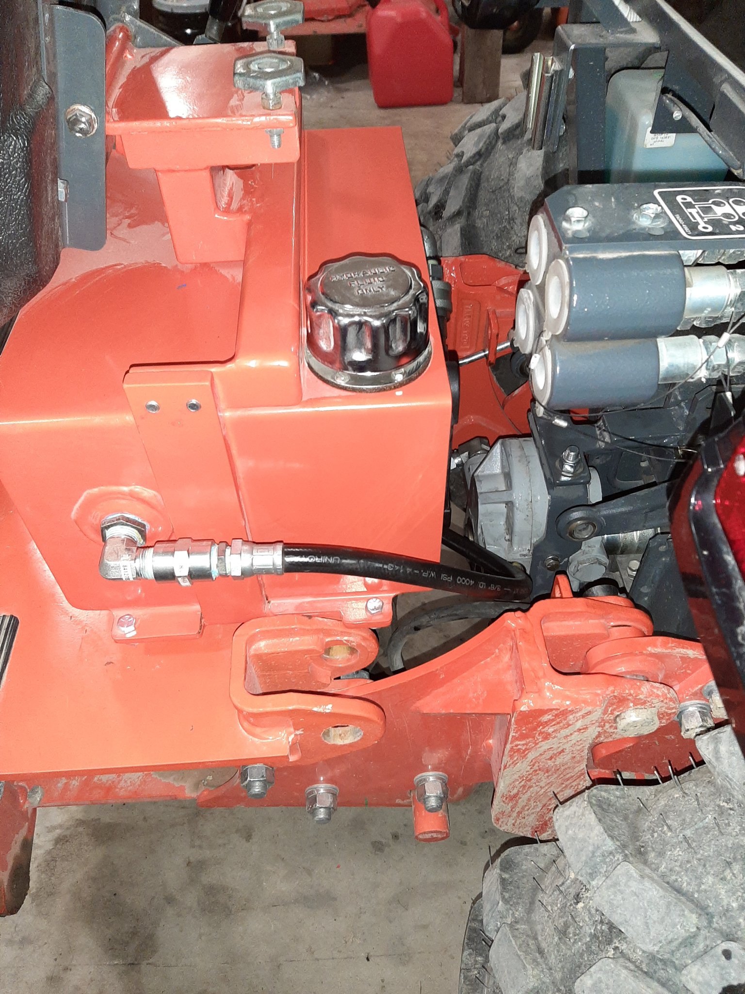

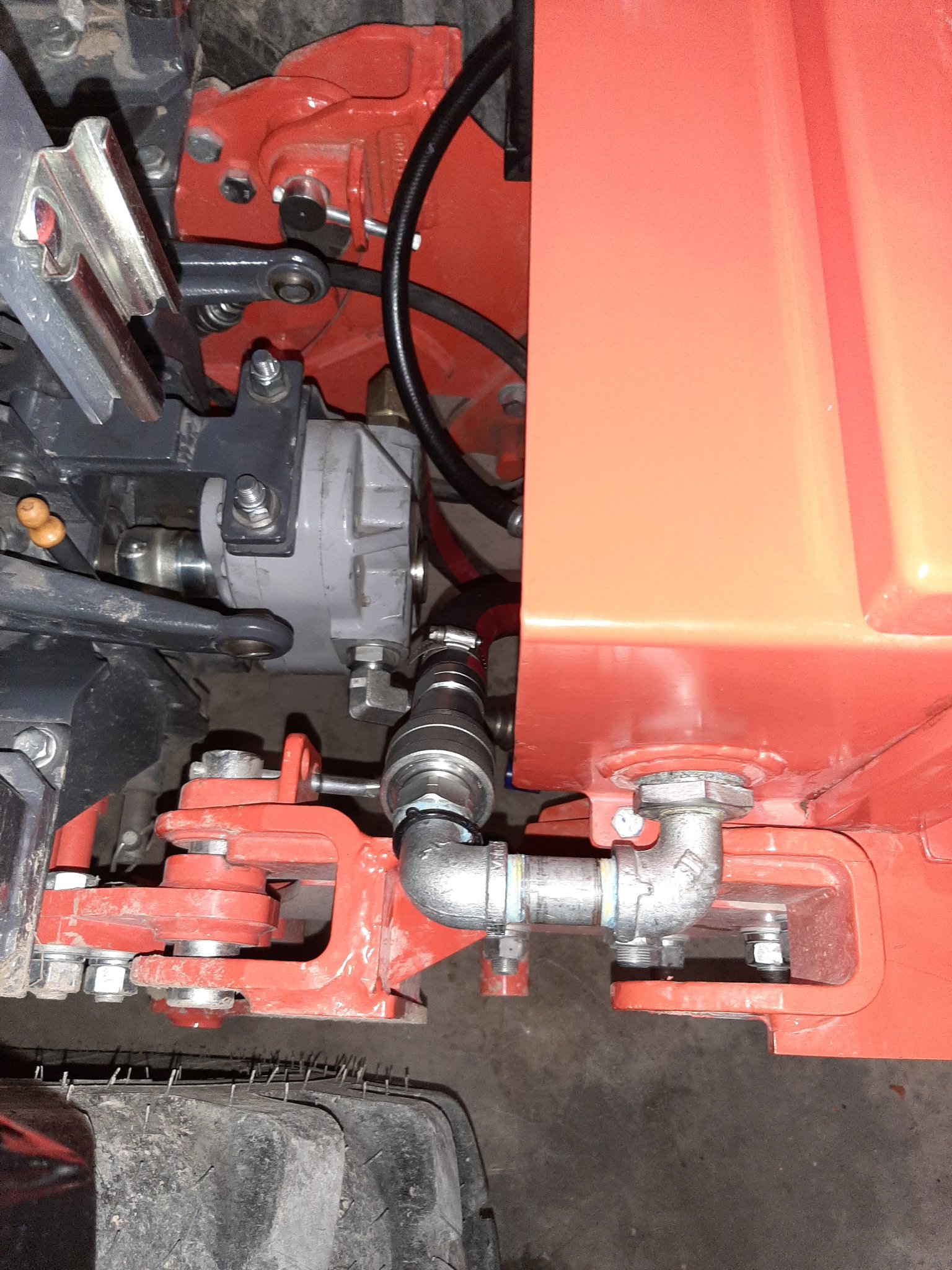

I just gave my BH77 a blood transfusion and new heart. Nice to have more speed. The tank has a mesh strainer, but I hope to find a way to install a valve and cartridge filter in the suction line with the limited space. I might have to forgo the valve and just drain the tank for filter replacement.
Designed to likely fit an open station tractor with few modifications. Used existing holes and has the ability to easily switch from tractor hydraulics to independent using quick connects. All on UDT. My arse might get a bit warm in the summer, but the Woods ran fine without a cooler.

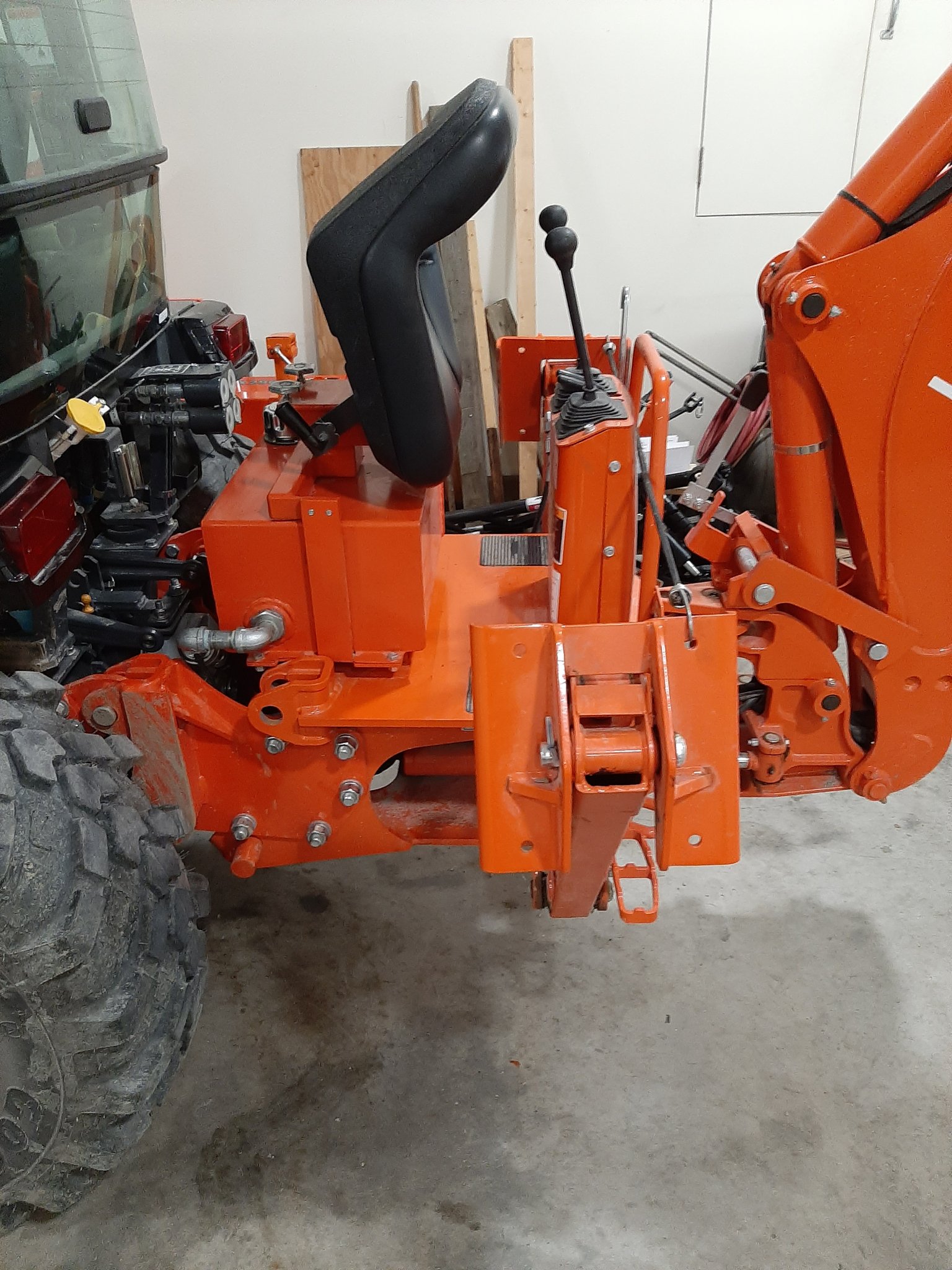

I am now trying to figure out how to get more foot room for my feet to go more forward without been hit by the hoe. I might have to re-design the boom lock. I was less cramped in my old smaller Woods 650 than in this thing. Can't imagine operating it if I had longer legs. I did raise the seat up a bit from stock.

Yes, a 6.8 gpm pump
Wow! Did you do the fabrication on the plates to extend the mount? The original BH77 foot room is cramped; that looks really tight! Is the speed and power significantly more?
I think that I would upgrade to an excavator before I did all that work; but beautiful job!
The plates are what Kubota uses to install the bh77 to a cab tractor. The speed is certainly more which was the objective. I have not used it yet in real work but I expect the power to be the same. The relief settings are factory set.
When I used it for the first time last year I wished that I still had the Woods 650 running on the b7200 with the higher pto speed.
The fabrication work was really not that involved as I used a manufactured 5-gallon tank. I think I spent more time prepping it and painting it. The seat mount took the majority of the fabricating time. Everything made from scrap steel from previous jobs.

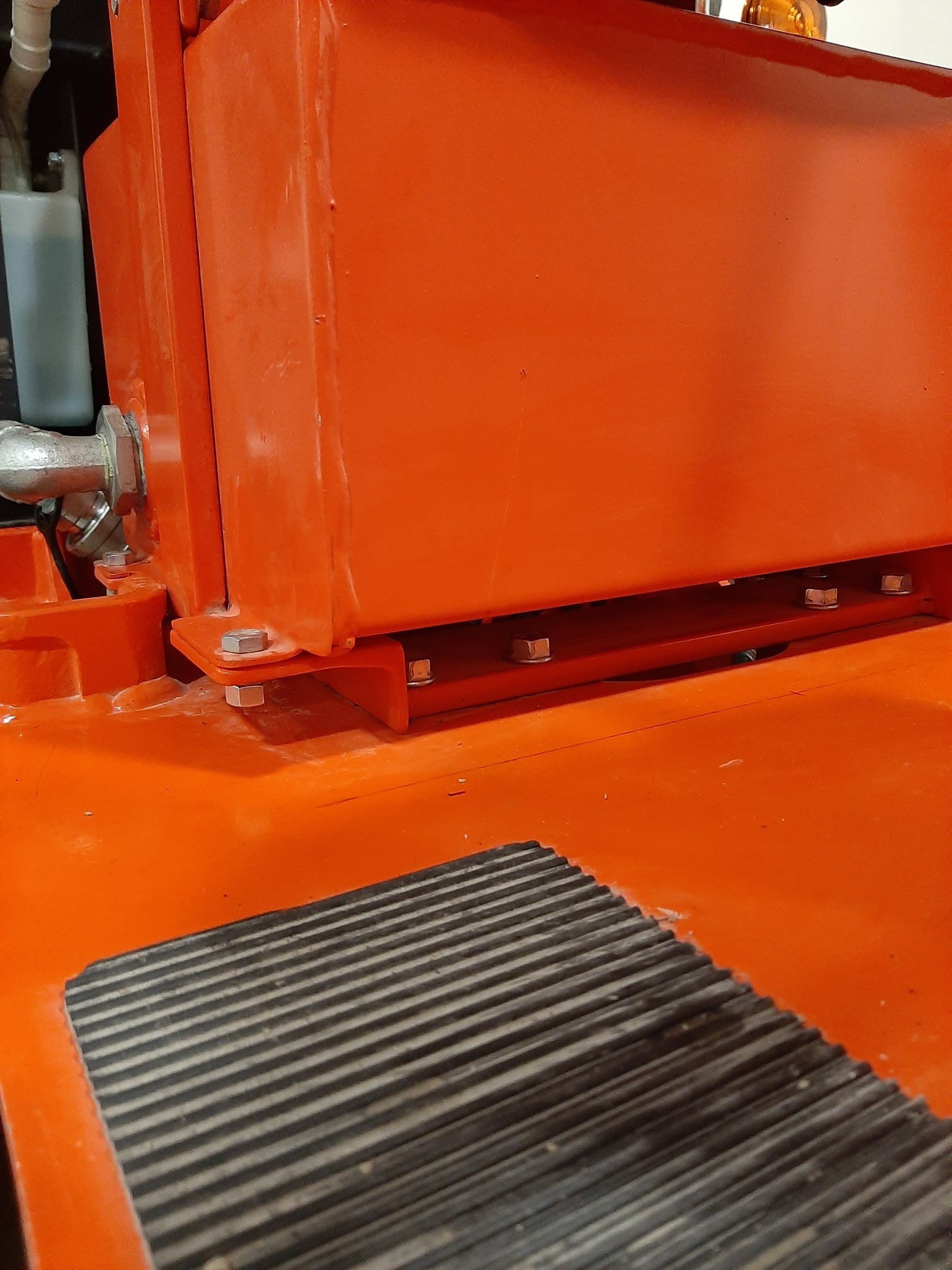

This is the tank that I modified for the job. I picked this particular tank as it afforded ample room for my feet as well as having enough room behind it if the bh was installed on an open station tractor without the 9" extensions. https://www.princessauto.com/en/reservoirs/product/PA1000000758?skuId=8318347
I did not take any pictures during the fabrication but have one showing the underside mount.
It was made from a 3" x 3/8" flat bar with "L" brackets welded to the ends. This raises the tank up a bit to clear parts of the floor and allows it to be bolted in prior to installing tank. Uprights were welded to these brackets to rise vertically and give a place to fasten the seat frame to. The seat frame could be greatly simplified by not having the option to tilt the seat up. All this can be removed in about 15 minutes and everything put back to original.
