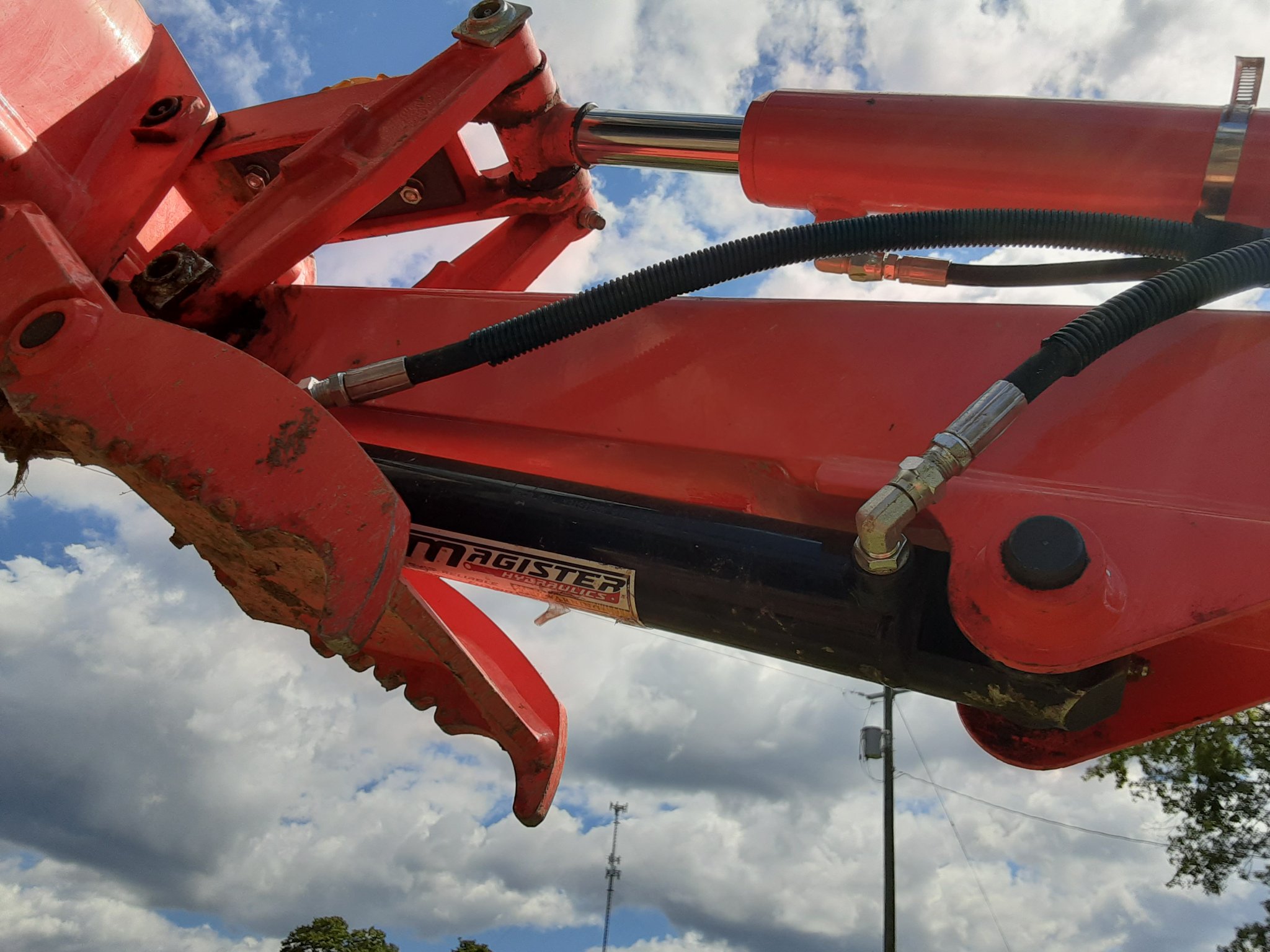

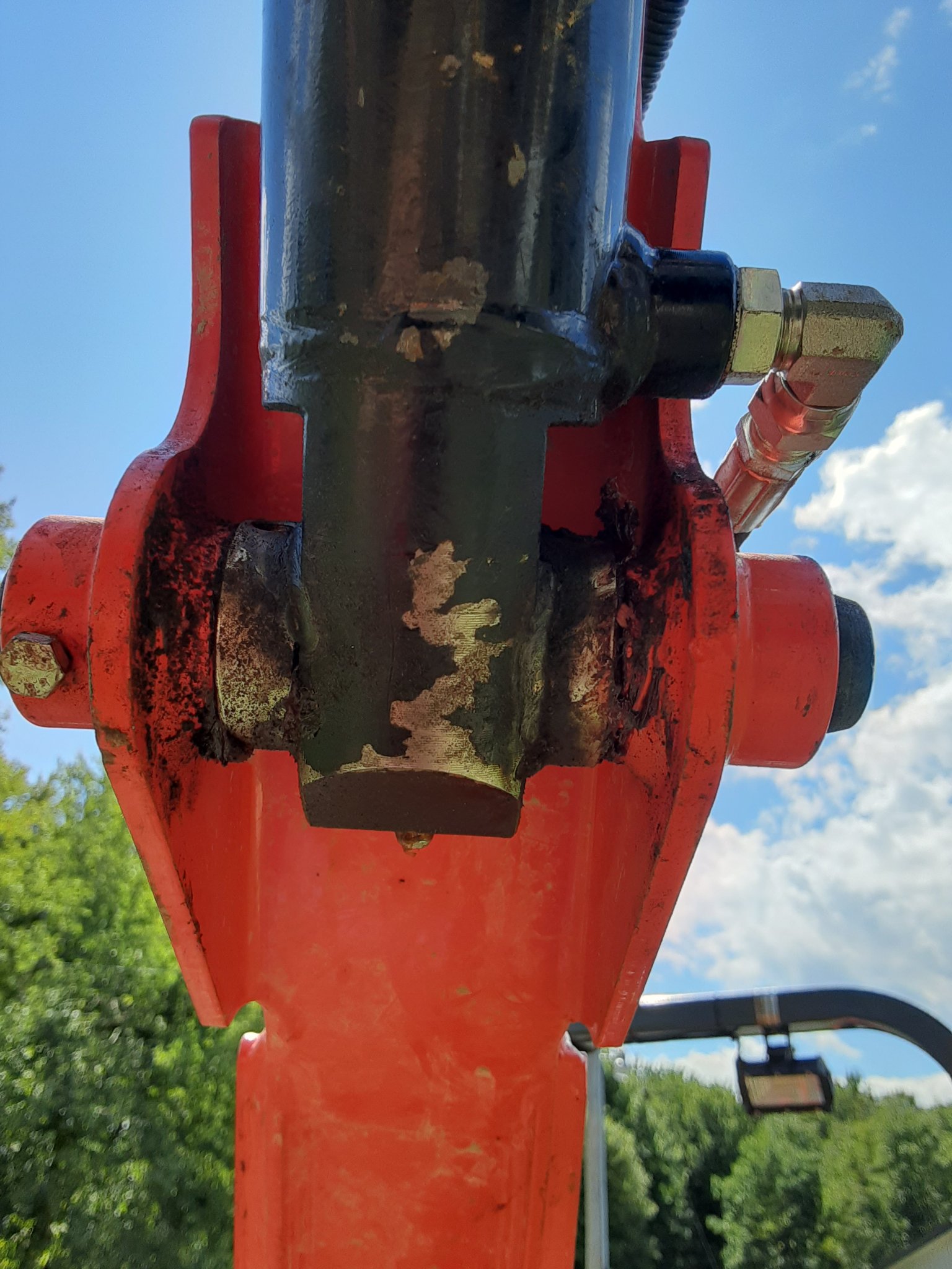

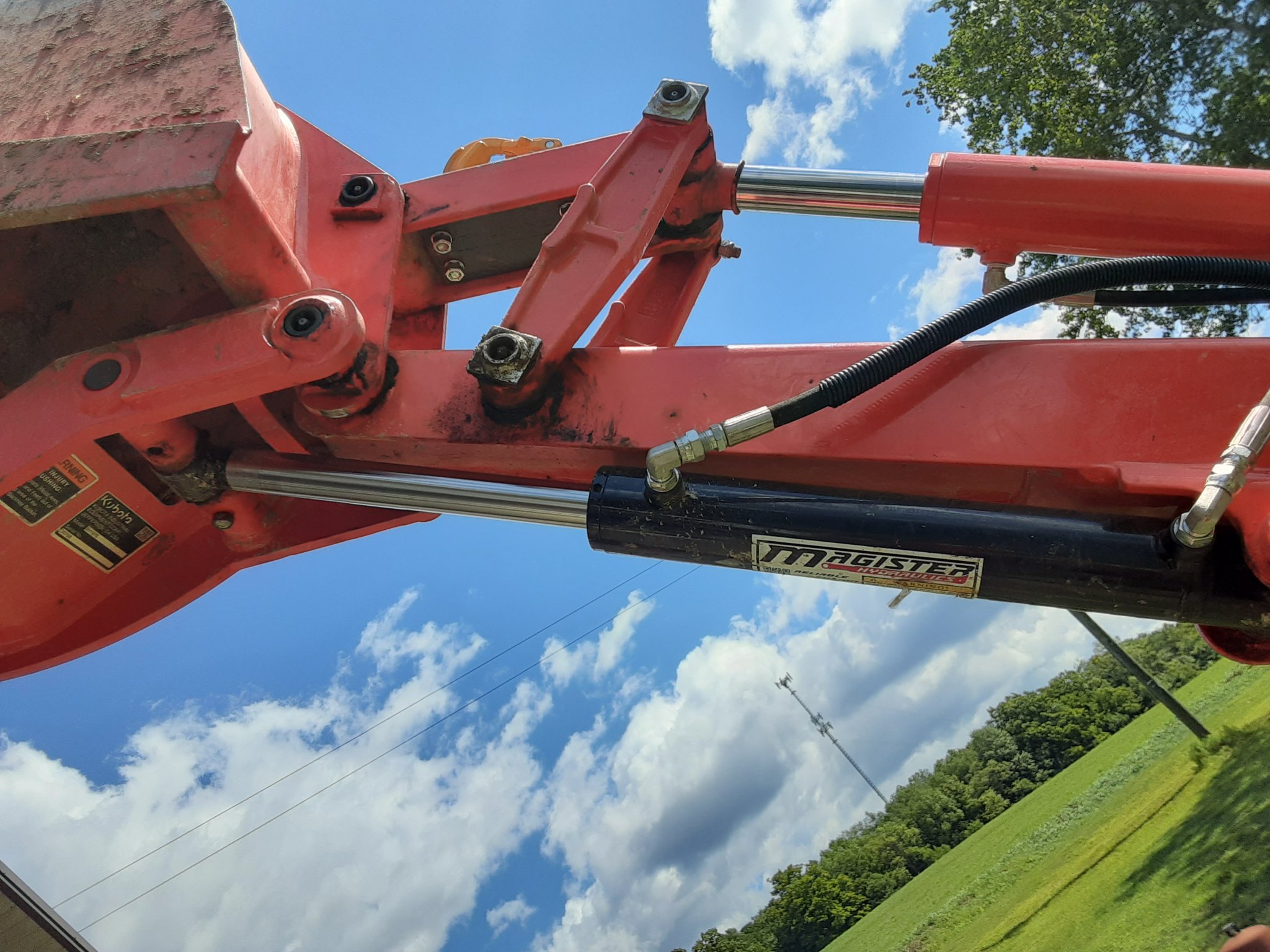

Well to start with I picked that tang style cylinder because of it's dimensions. It is 19" closed and 29" extended with 1" pin holes. The hydraulic ports are on the side so I positioned it with them on the left for me. The rod end is 1-1/2 wide and that fit where my manual thumb linkage was. I put that end in and positioned the base end in line with the mount hole. I see then it was off (as I remember) about 3/8".
I cut a piece of 1" shaft and welded in to plug the base hole. Then I determined where to bore the hole again by holding it up and marking. I bored the hole and then welded on a 1"shaft collar on each side and then milled about an 1/8" off each side so the base end was centered in the dipper arm bracket. This allowed me to tuck the cylinder and thumb as close as possible up to the dipper arm when not using.
As I posted earlier the cylinder I used was the WTG2x10 and it isn't available right now. I did see the WTG2.5x10 is and it looks like it would fit in there too. It might have the thumb down just a little due to the small difference in dia when the thumb is up.

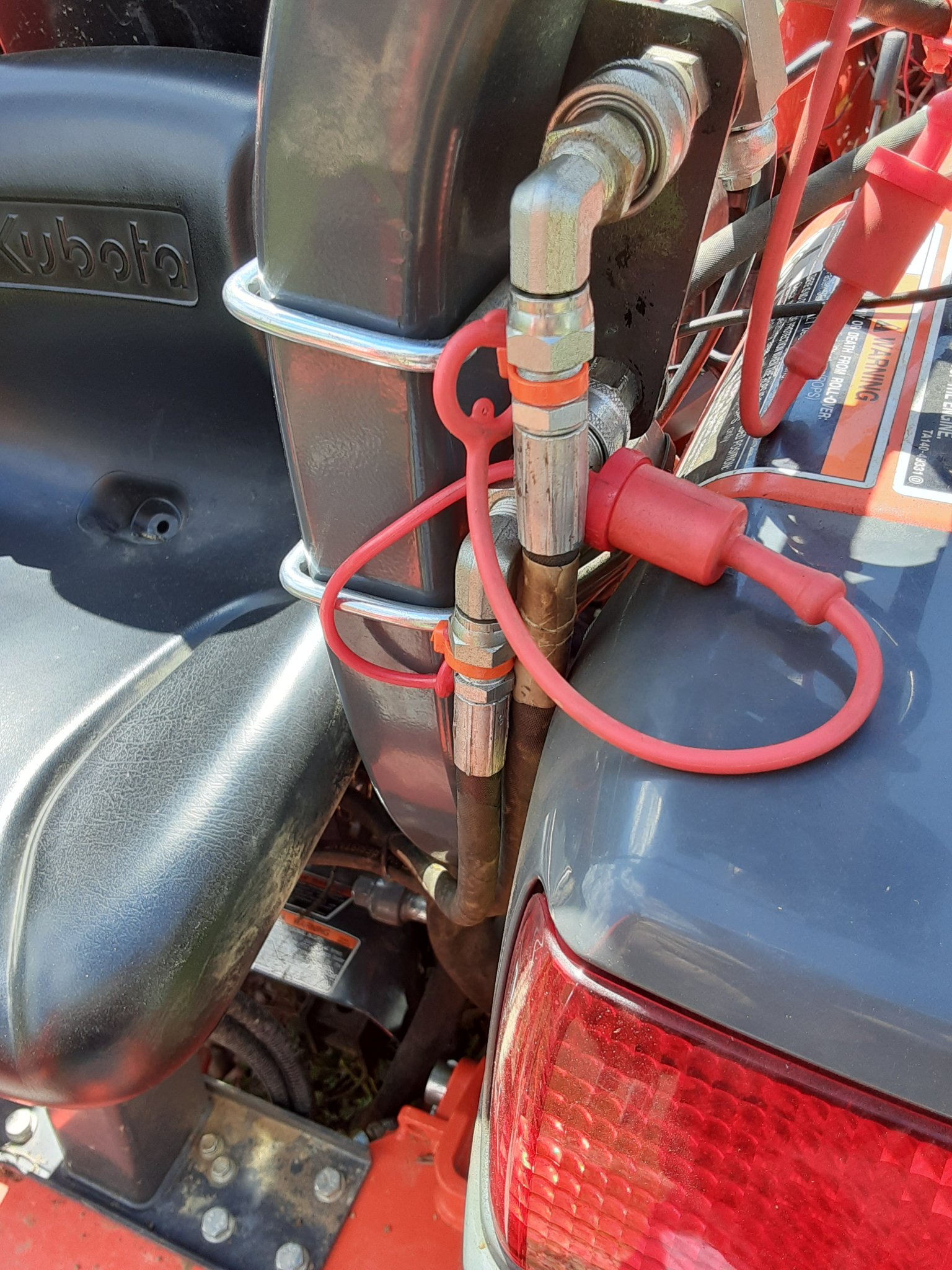

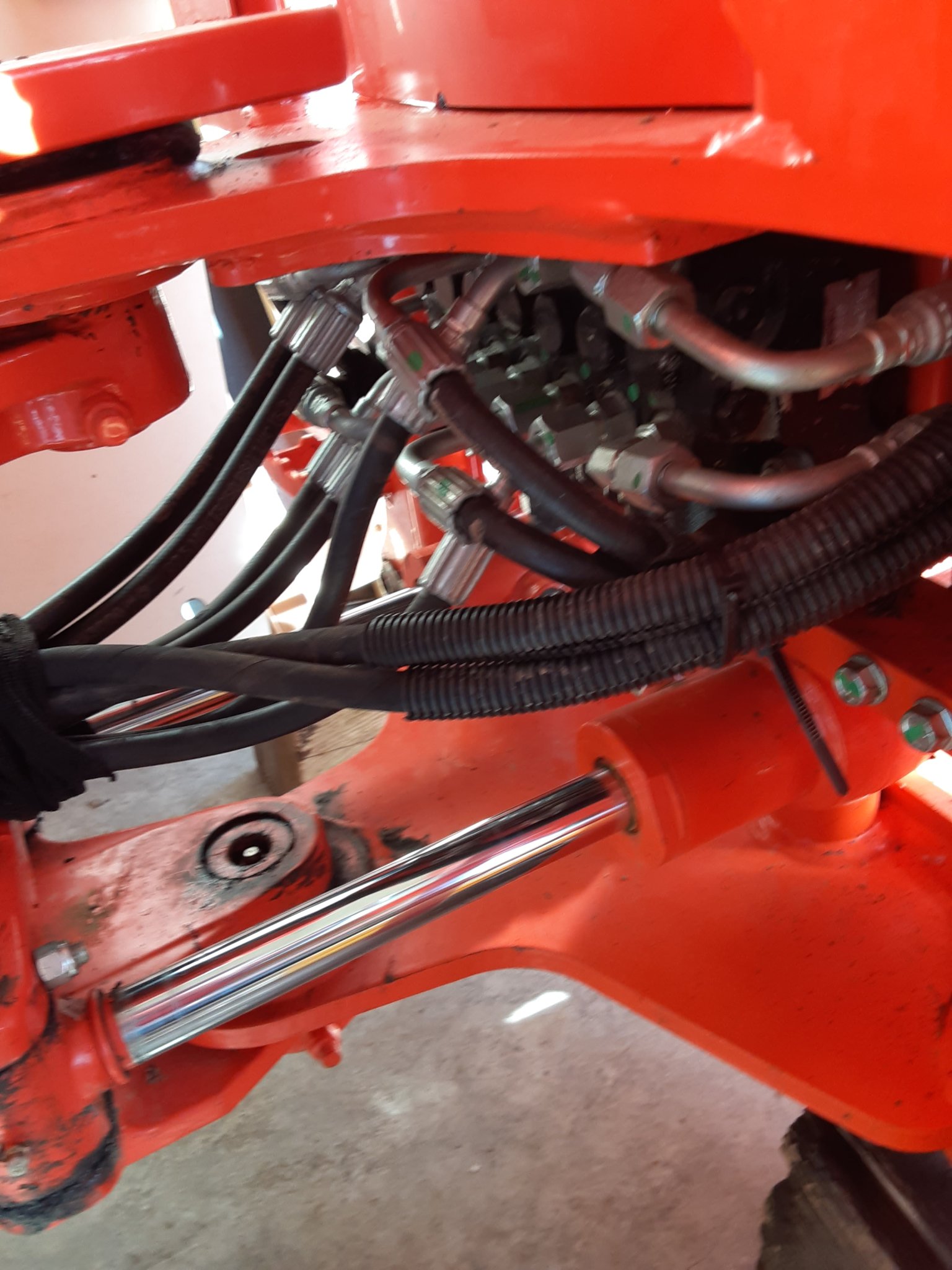

I was able to snake 2, 1/4"hoses thru in the same path as all the other hoses and that wasn't too had considering I did it by myself. I used the NPT 180" from surplus center 916-14180. They were long enough to come thru up by the right fender where I installed the coupling fittings teed from my 3rd function valve.

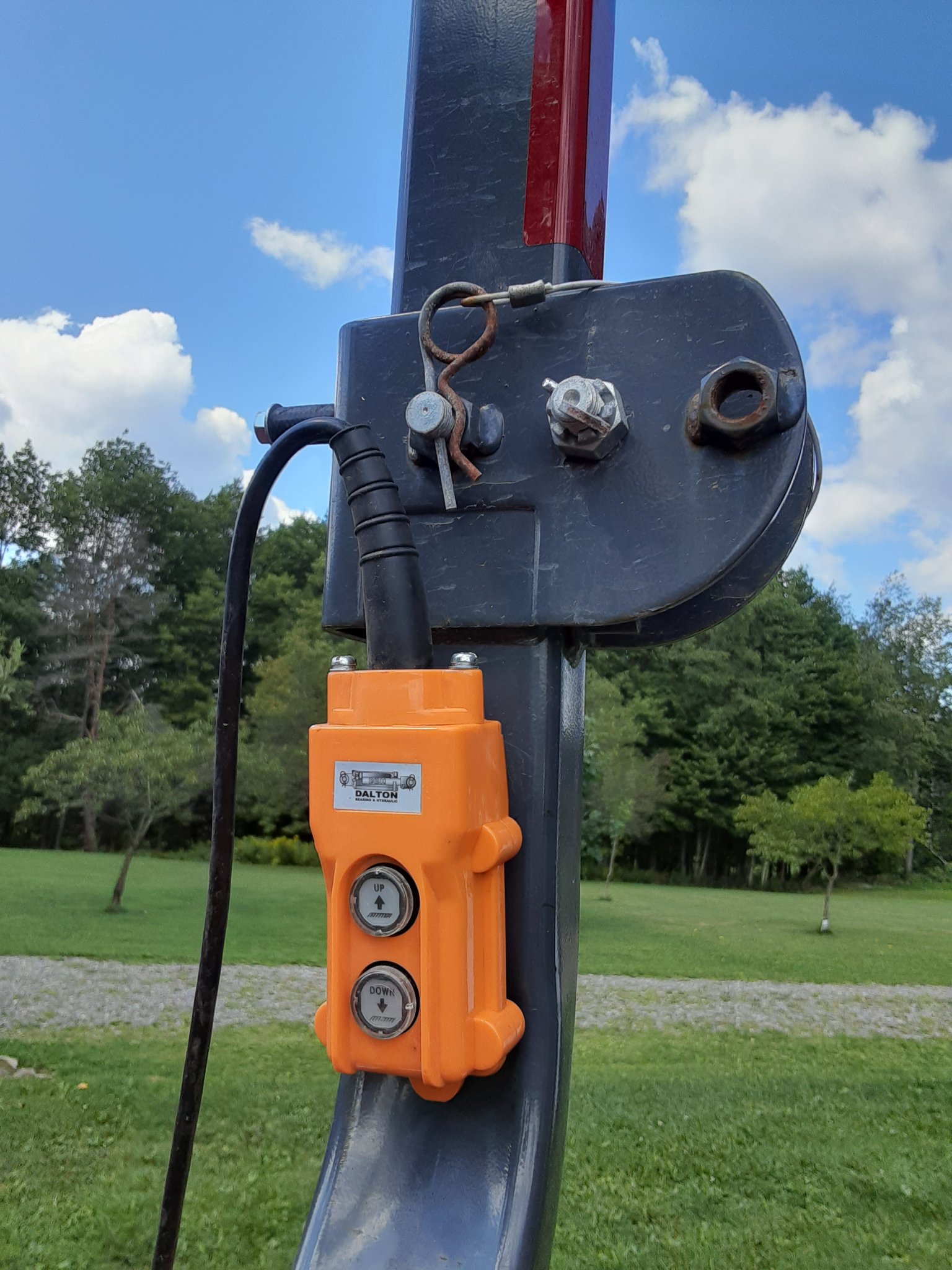

The switch I paralleled to the 3rd function switch was from surplus center and is 2 NO push buttons with about a 20 cord and magnets on the back. It is PSN=020-M20 11-2201-20 if I have that number right. I figured I wouldn't be using the grapple at the same time as the backhoe. In use I wasn't sure where I would want the switch and found so far it is handy stuck on the right ROPS.

I did add a ball valve in the base end side of the line on the tractor side before the hydraulic coupling so I could lock the thumb up as I find it leaks down sitting or in use. I assume it has to do with the 3rd function valve but that works so I haven't looked further. I got that idea from other threads here about doing that for top and tilt circuits without the locking circuit on the cylinder.
