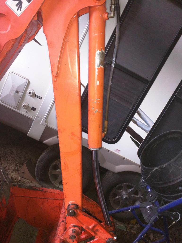

Thanks. I'm trying to check how much pressure I've got going to that particular cylinder which keeps bending

It is unusual for a cylinder to bend unless subjected to forces originating outside the cylinder such as a thumb or if it is not free to pivot at each end and thus bending forces are applied to it.
Could you post a couple of photos of the bucket area of your hoe

Thanks Dave this is the 3rd time in less than 20 minutes of operation. I had a 2in stop installed in the cylinder the last time I had it straightened but it didn't help. I'm trying to remove red tip bushes not oak trees. Very disappointed any advice would be greatly appreciated

Look at my marked up photo. Why is the paint worn off in this area?
Buy a 0-3,000 psi hydraulic pressure gauge for about $30.
Remove the upper hose from the bucket cylinder and connect directly to the gauge. No Tee needed.
Engine at max rev's. Send pressure to gauge and read immediately then release pressure so your system is not continuing to discharge through relief valve.
Dave
wddot
Jun 9, 2019
7
Lumberton NC
I sanded the paint off so I could read the numbers. I just checked the pressure thanks. It read between 2500 to 2575psi The relief valve is working so I'm thinking the Ram's diameter is just to small.
