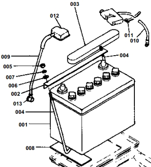

There was no battery holder on my B7100 when I bought it either. I checked online one time and what looks like a small piece of angle iron cost $30. I will try to attach a picture from the pdf parts manual I downloaded.

There is an angle iron tie down with a long bolt at each end to tighten and hold the battery tight. I no longer have my B7100 but if I remember correctly the angle iron piece was about 3/8 x 3/8 wide and about 1/16 thick that ran the width of the battery. It had a hole in each end for the hold down bolts bolts and it fit across the back side of the battery, not across the middle. It would be really easy to fabricate with a short piece of angle iron and a piece of all thread rod. The picture James posted is exactly what you are looking for. If you can't find the hold down kit it would be very easy to make one yourself as I said. Good Luck...
