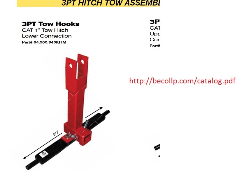

Using the dimensions of the drawbar I picture you using, it is 26" wide before the 3 pt pins. Let your concrete box be the width of the bar.
I am suggesting 1 foot in thickness as to go thicker can start to require a strong form to resist the concrete pressures until it solidifies..
I picture the draw bar being placed on top of the concrete box so as not to weaken it by casting it into the concrete. Four 3/4" diamter bolts 8" long inserted into the wet concrete (head down) to attach the draw bar to the concrete. Then nuts can be put on the protruding bolts to secure the drawbar. Place a sheet of plastic with the four bolts protruding through it on top off the wet concrete and get the bolts through the drawbar holes before the concrete hardens. The plastic will prevent the concrete from sticking to the drawbar and slow down the moisture evaportion thus improving the concrete strength. Setting the bolts through the drawbar before the concerte hardens avoids any alignment issues with the bolts and the bar holes.
You will have to use some judgement in where on the block to locate the drawbar in a front to rear direction so it is not hitting the lower arms as you lift it.
You need to make provision to attach the top link to the block otherwise it will be swinging back and forth.
This drawbar photo is to give you an idea of what you need to provide a location for a top link. The part painted red.

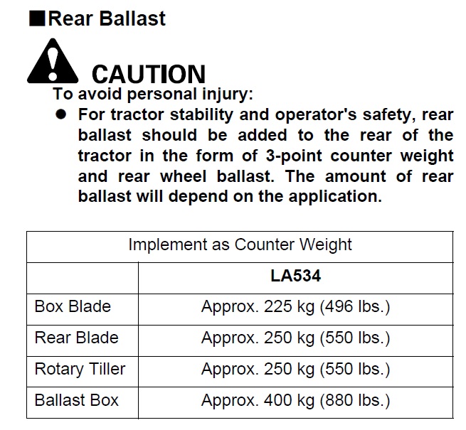

In the installation instructions for a LA534 loader I came across the ballasting instructions which, at first glance, seem a little confusing.
The amount of ballast needs to not only consider the actual weight but the distance the weight is from the rear of the tractor.
The box blade at 496# is envisioned to have its weight furthest from the rear of the tractor where the ballast box at 880# has its weight closest to the rear of the tractor.
You will find having the ballast close to the rear of the tractor will make maneuvering much easier.
