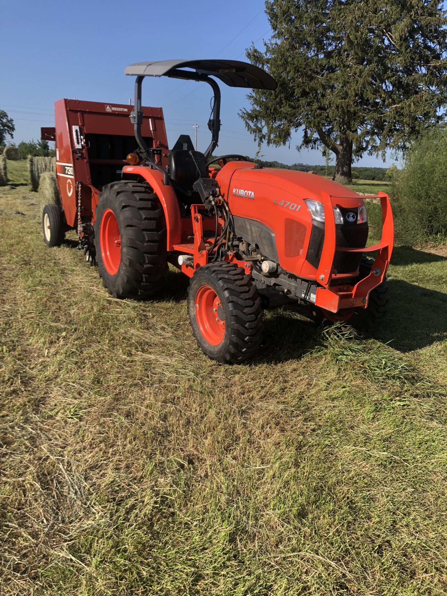

If your are looking for a round baler for the L4701 I would check out a Hesston 5530, 530, 730, or Massey Ferguson 1734, or Case 8420. They are all the same baler. I have a Hesston 730 and the 4701 Handles it just fine. Biggest drawback is they are twine only and the twine arm and cutter can be problematic. They also do not have a bale monitor so you can make some odd shaped bales of your not paying attention.
