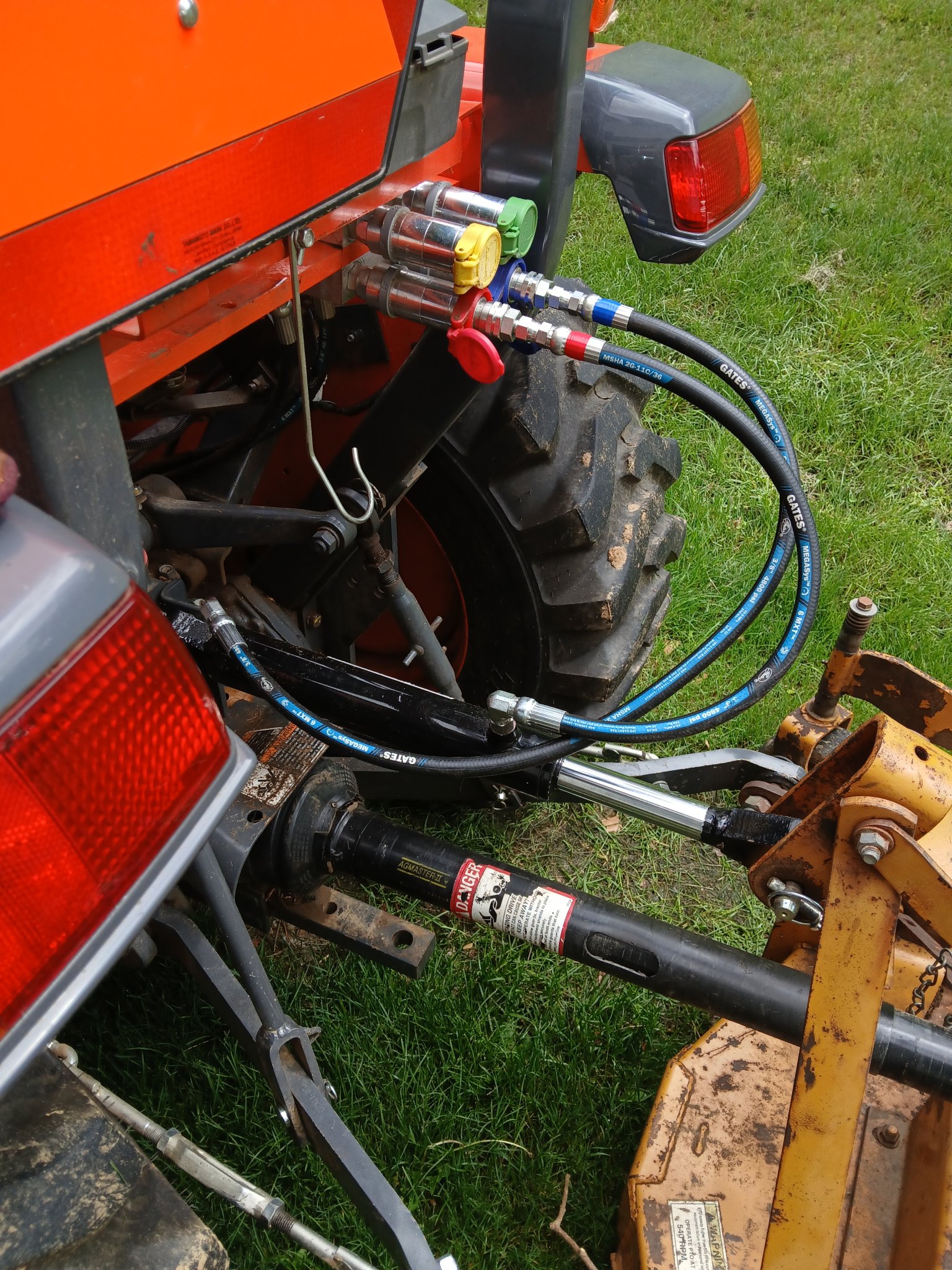

My pref:erence - same type as used on M series:
FTG-05
L4330 w/FEL, RTV-XG850 and ZD326S
