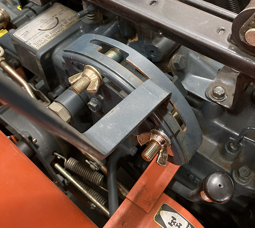

On a B7200 the slot in the lever guide has an offset about 2" from the top. Thats the gate. You have to pull the lever to the side and then up to get past the offset and into the top of the slot. It is there on all B7200 with or without the optional outlet.

Attached is a pic of the B7200 gated guard for the 3point. Not sure if it's the same on the B9200 though. If it is, the control levers never hold tension. I usually have to tighten it once a year. You can tell by how marked up the nut is. Next time I stop by Messciks, I plan on getting two new spring washers and applying a dab of blue locktite to the threads. Hopefully that last longer than a year.
