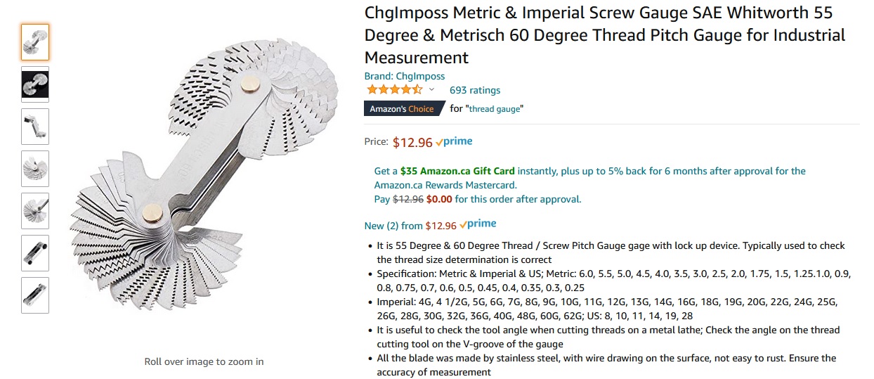

The wedge bolts are still available but expensive at $80.
Part Number is 70761-56190
How did you determine the shank size was 16 mm?
Many of these Kubota accessories were made in North America using SAE fastener standards.
If your tap and die set does not already have a thread pitch gauge, $13 buys a comprehensive one on amazon.
Even with damaged threads you should be able to verify which of the two Roadworthy suggests is the one.

Thanks, I found someone that could measure the pitch. It was 1.50 I ran a tap through the nuts and a die on the Wedge. They are good now.
