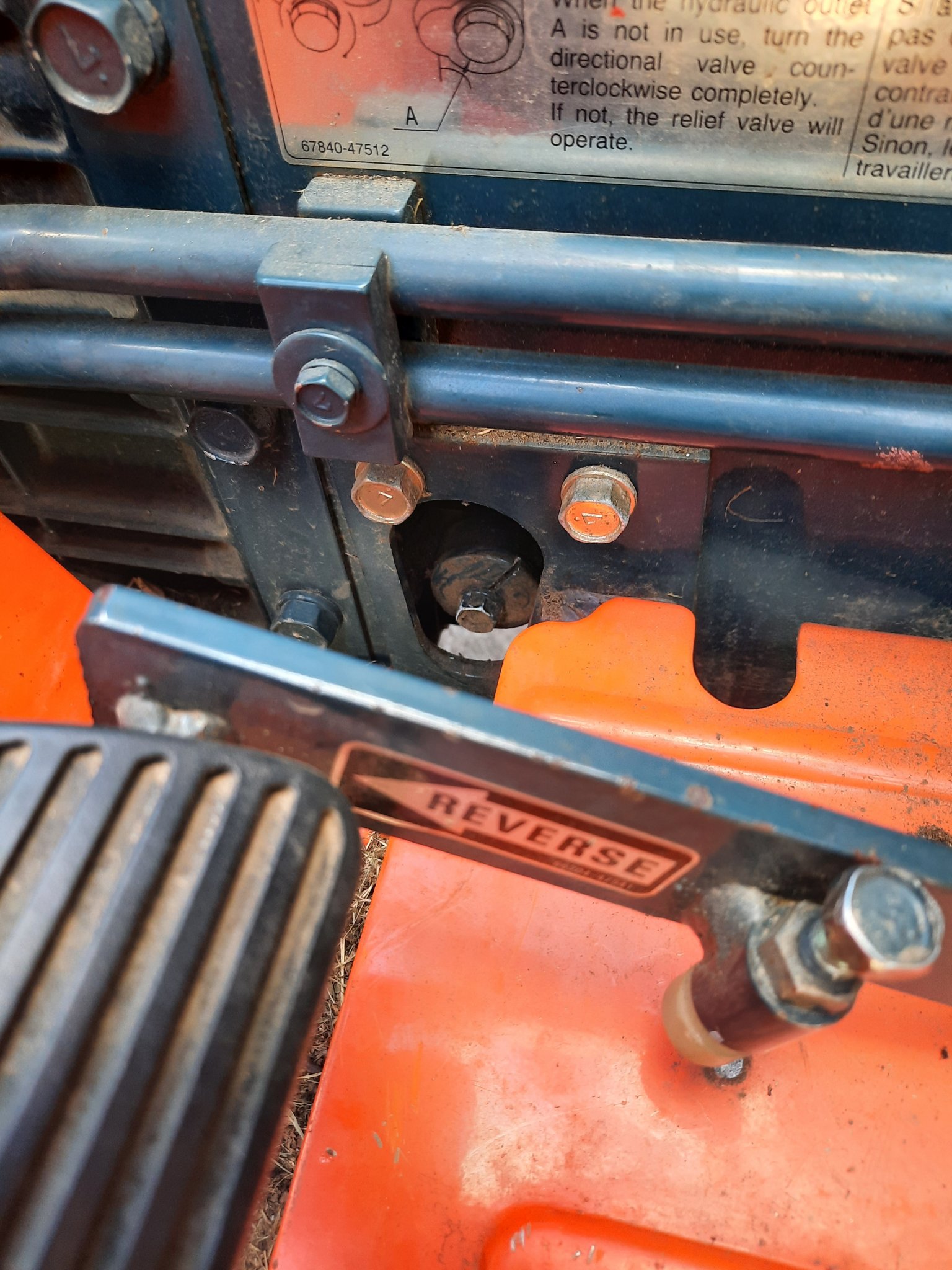

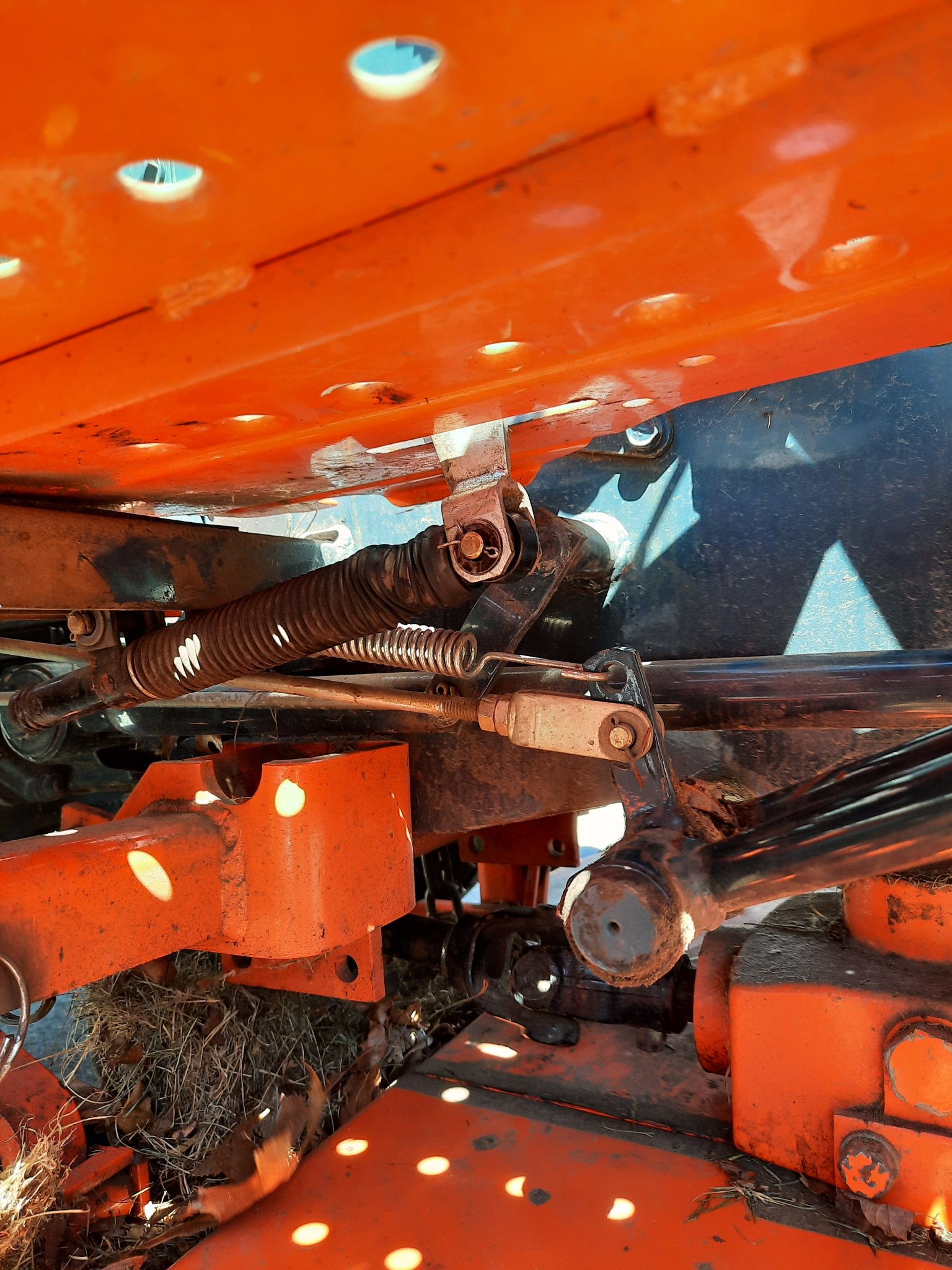

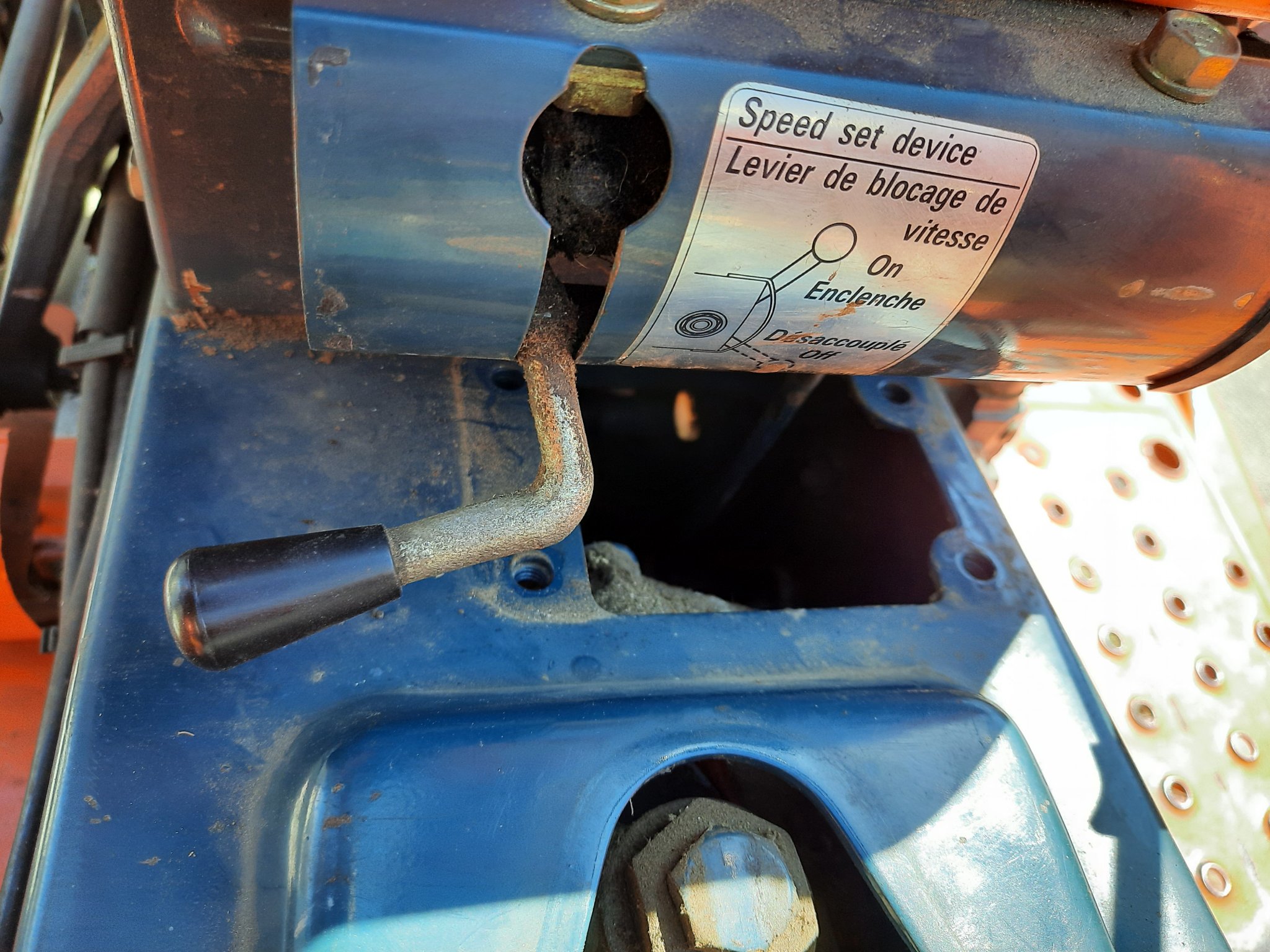

I just picked up a Workshop manual, so that will be my bedtime reading tonight! I am also posting a few picture I took here. You cannot really see much of the mechanism here, but you get a sense for the pedal and access points. After I took these, (and on another commenters advice) I removed the mid-mount mower deck and was able to crawl under the tractor and see up there much better. I see the 'V-plate' and roller mechanism that many others have referenced as being how the HST 'finds' neutral. I cleaned a bunch of gunk off that, but still having the issue. The project continues....

Sometimes the damper can be finicky on an HST. It's shown in second picture.
Try a parts diagram...agree to legal the put in B8200 and pick HST 4WD. May give you a good idea how it all hooks together.
The linkages are the last 2 diagrams under Speed Change Lever.

Eureka!
This issue is resolved, but for the benefit of any others that are looking for a solution (or for myself in 10 years when I have to do this again), here is how it went.
After doing more research online I was able to find a post where somebody had the same issue with a B7100. It turns out the HST system on that and my B8200 are nearly identical. They key I was missing is the neutral adjuster. In the picture attached, you have to pop-off the black rubber hatch to expose that part.
I made sure the tractor was in 2WD, blocked the front tires, and jacked the rear ones (only the rear right tire is connected to the drive, so that's the one you really need to get off the ground). Then I loosened that retaining nut, started the engine and used a flathead screwdriver to move that slotted circle one way and the other until the rear right tire stopped moving in neutral. Tighten that nut up, and you are done! 20-30 minute fix if you know what you are doing. 4-5 hours if you don't!
Thanks for your help everybody, it will be wonderful not having to deal with this anymore.
