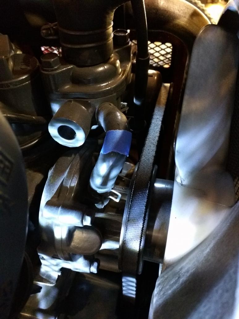

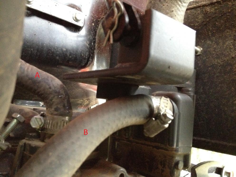

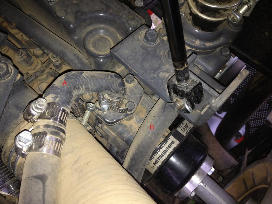

Questions for the experts... - see photos below, the thermostat bypass hose is, I believe, the one to which I've attached some blue tape
1) if I attach the two heater hoses to the two existing hose nipples (one on thermostat housing, the other on the water pump housing) am I going to get a constant flow of hot coolant going to the heater?
2) which end of this thermostat bypass hose is considered the "pressure" side - the side closest to the pump or closest to the thermostat? I'm assuming I should treat the pump side as the "pressure" side and the thermostat side as the "return" side. Please correct me if this assumption is wrong.
2) the cab has a coolant flow control valve outside the heater core - this valve is sticky and I'm inclined to just leave it permanently in the "on" position. If I do happen to leave the flow control valve functional, should I tee into the hoses and install another valve (perhaps down by the engine) to essentially provide a "winter/summer" selection to ensure the thermostat bypass can continue to flow if I happen to turn off the cab heater valve during the summer?

I have a bypass for the water that is open when the heater has no flow. On my install, the lines to the heater are 5/8" IIRC. There's a short 90 degree hose that was connected as a bypass from the factory.
One end was 1/2" and the other 5/8". I rotated that short hose and used a coupling for one heater hose. Then the second heater hose got connected to the spot where the short hose was removed. I'd be concerned about using a smaller bypass than was installed at the factory.

You may have already have a port on the outlet side of the pump which will save you cutting an Teeing the lines.
I have what looks like a port on the thermostat housing, but in fact it is a depression in the casting rather than a threaded hole with a plug in it. I would have to bore out the hole and tap it in order to get a pipe thread-to-hose-barb fitting threaded into it. That's why the existing 3/8" hose barbs on both the pump and thermostat housing look like the ready-made solution.
