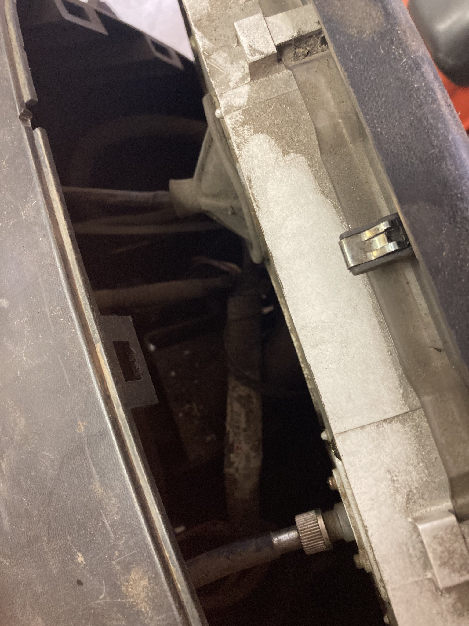

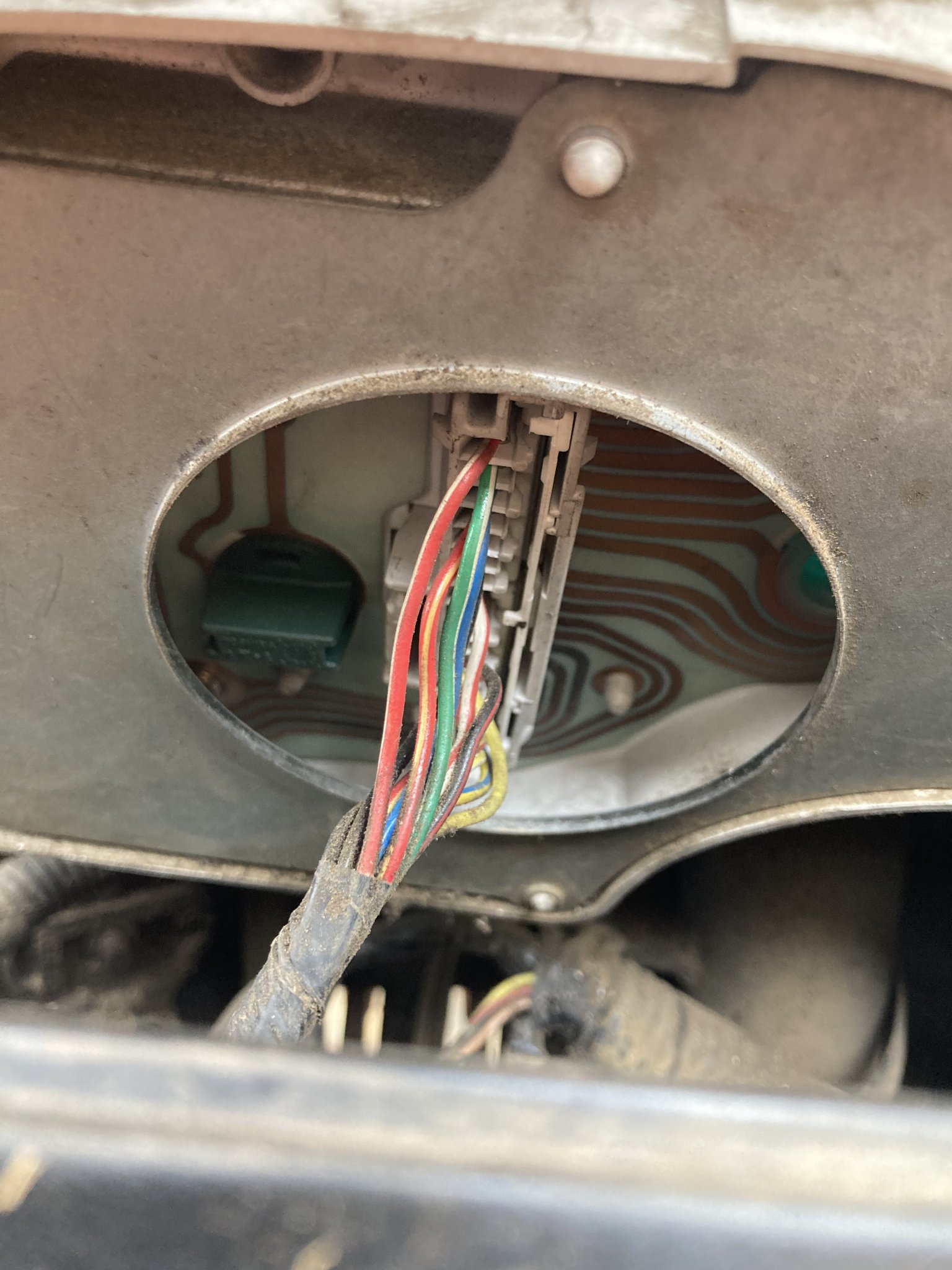

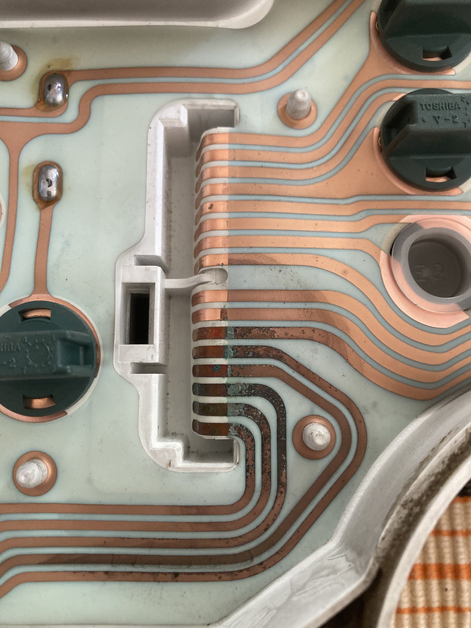

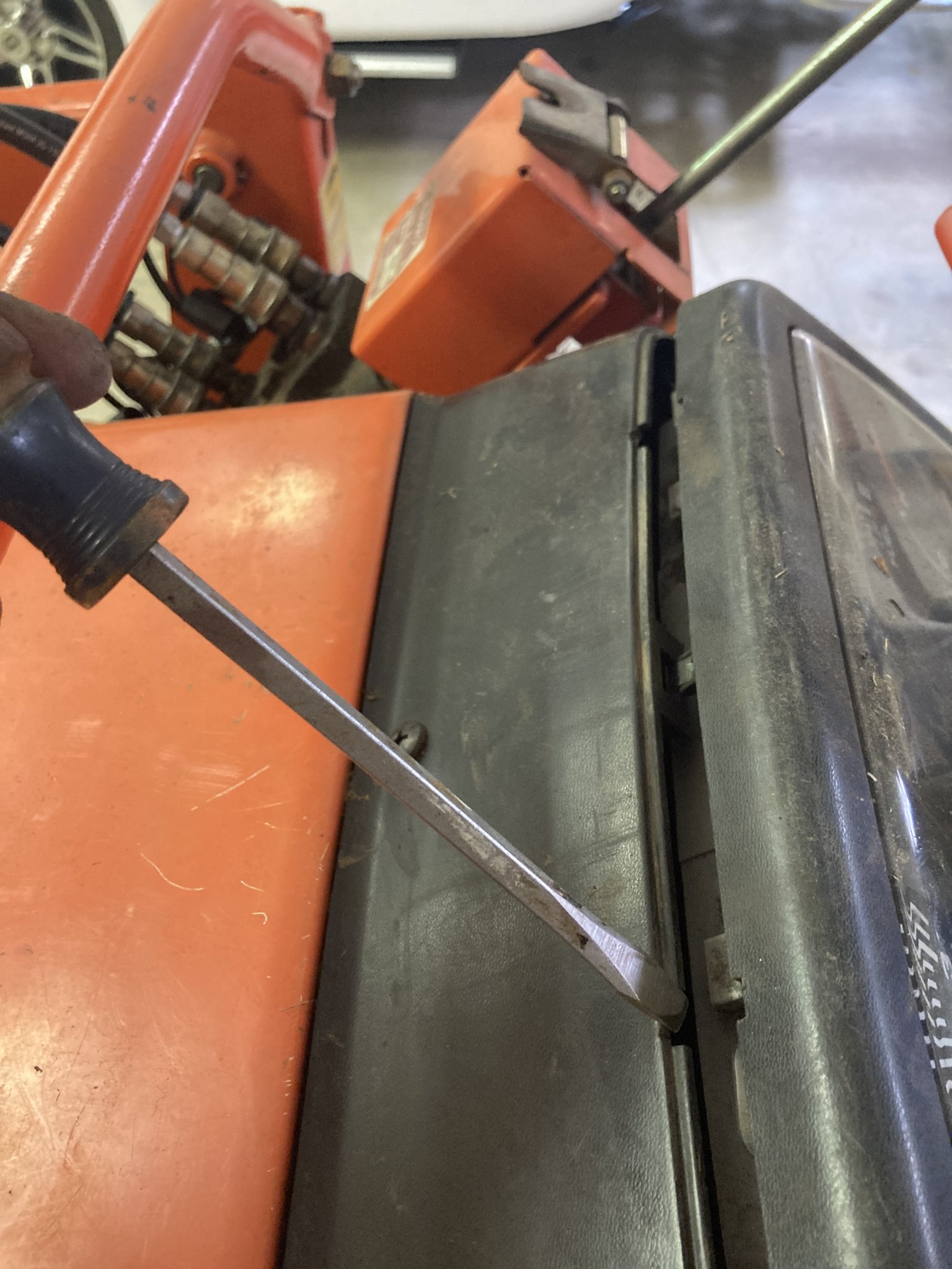

There are two pry slots on top of the B7500 where you can insert a screwdriver and pop off the instrument panel (photo 1). Once open you can see the cable connected to the tachometer and a grouped cable going to a rubber-covered shield behind the fuel and temperature gage. (photo 2). If you remove the rubber shield you can see the cable splitting into multiple wires going into a circuit board driving the gauges.(photo 3.)

I pulled the panel as described above and then disconnected the tachometer cable and multi-wire connection. That allowed me to fully remove the instrument panel and get a good look. The attached photo is what I saw. The bottom 6 leads had oxidized to the point they were not making good contact. Once I cleaned them up and reattached the panel my gauges started working again.
You guys were right about that being a possibility.
By the way, there didn’t appear to be any other components in this panel board apart from the metal leads to gauges and warning lights.
