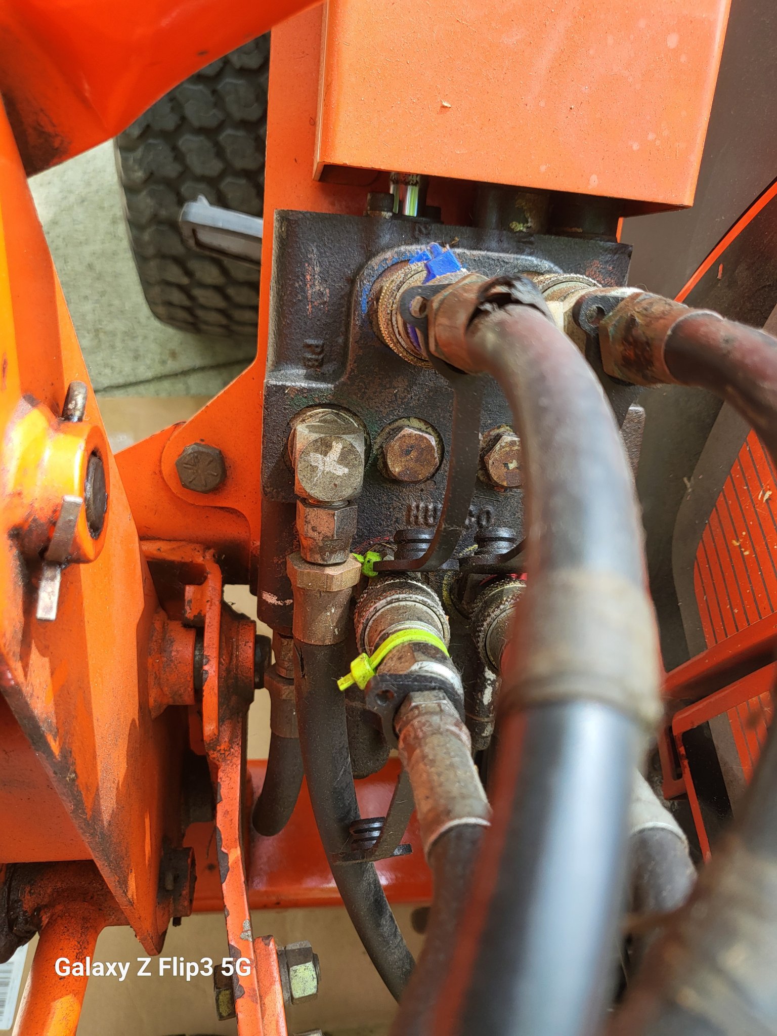

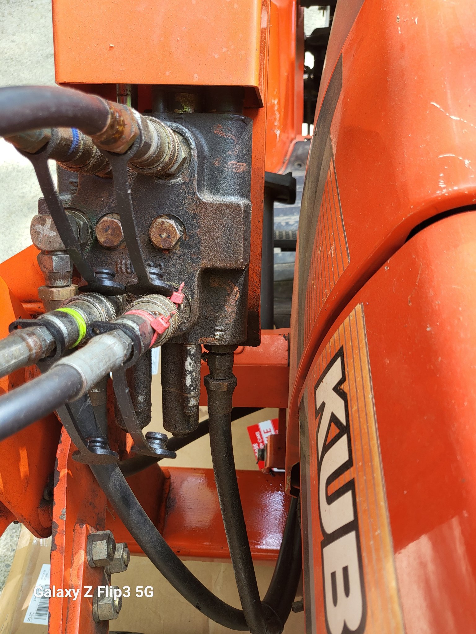

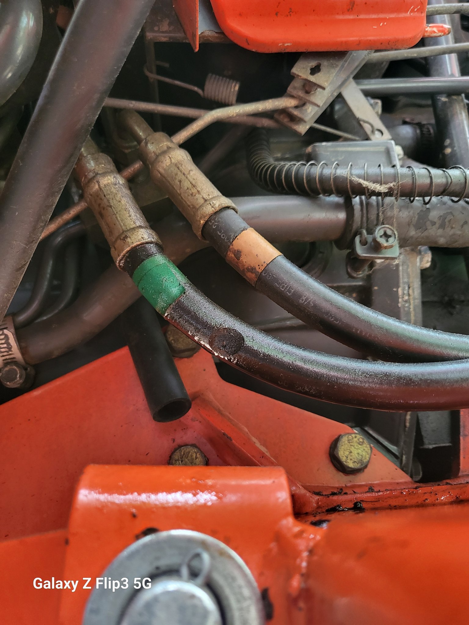

I believe the oil leak is in one of the hydraulic lines for the LA272 loader. One attaches to the hydraulic block "In" connection the other goes to the top face of the block but isn't marked. Both attach at the same location along the frame (but not the same connecter). Photos attached. I'm wondering if finding these is going to be a problem (suggestions or where to go for them welcome) and if there is a bleed process when lines are replaced or if the air is normally pumped out when the loader is used.

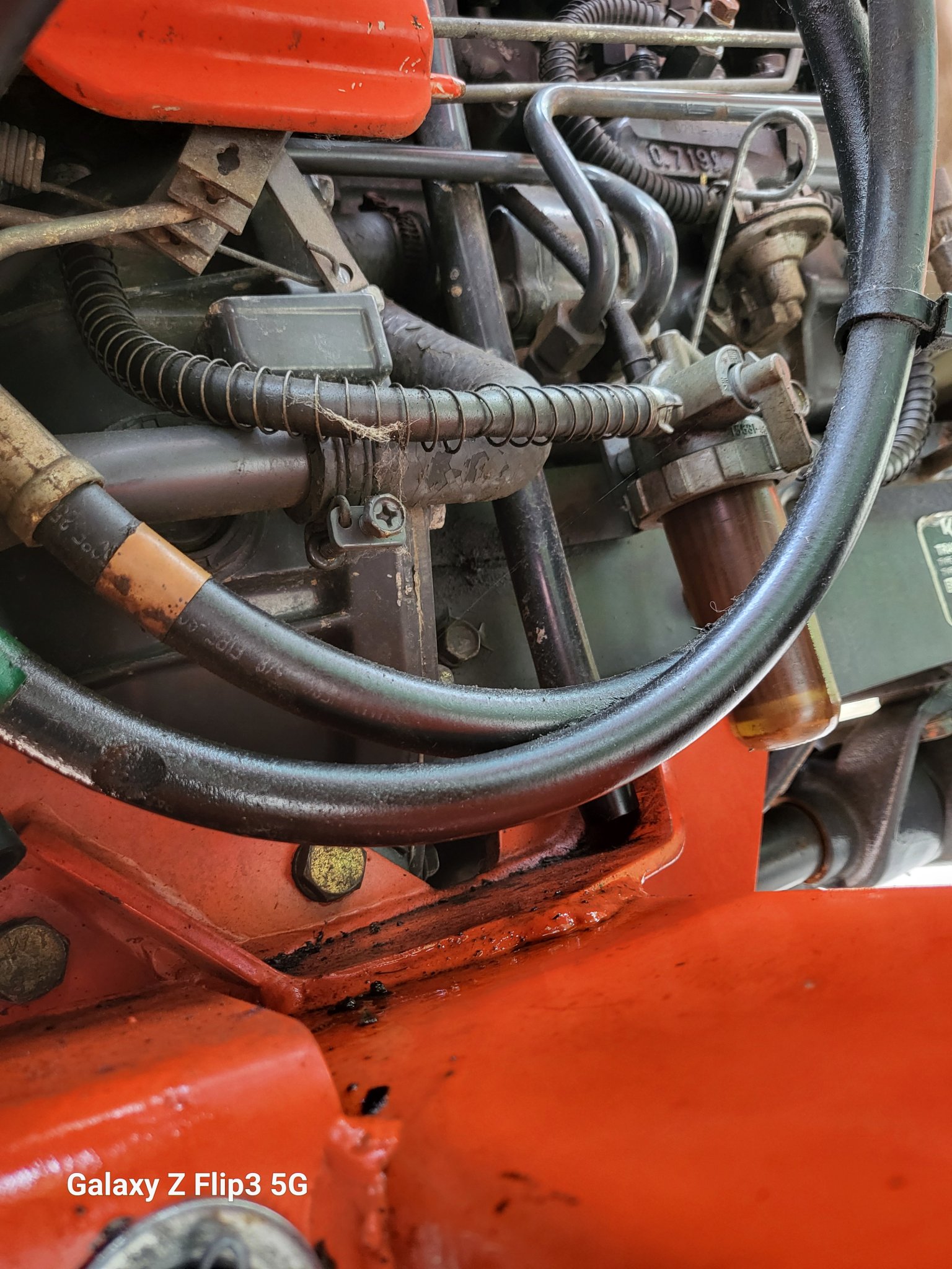

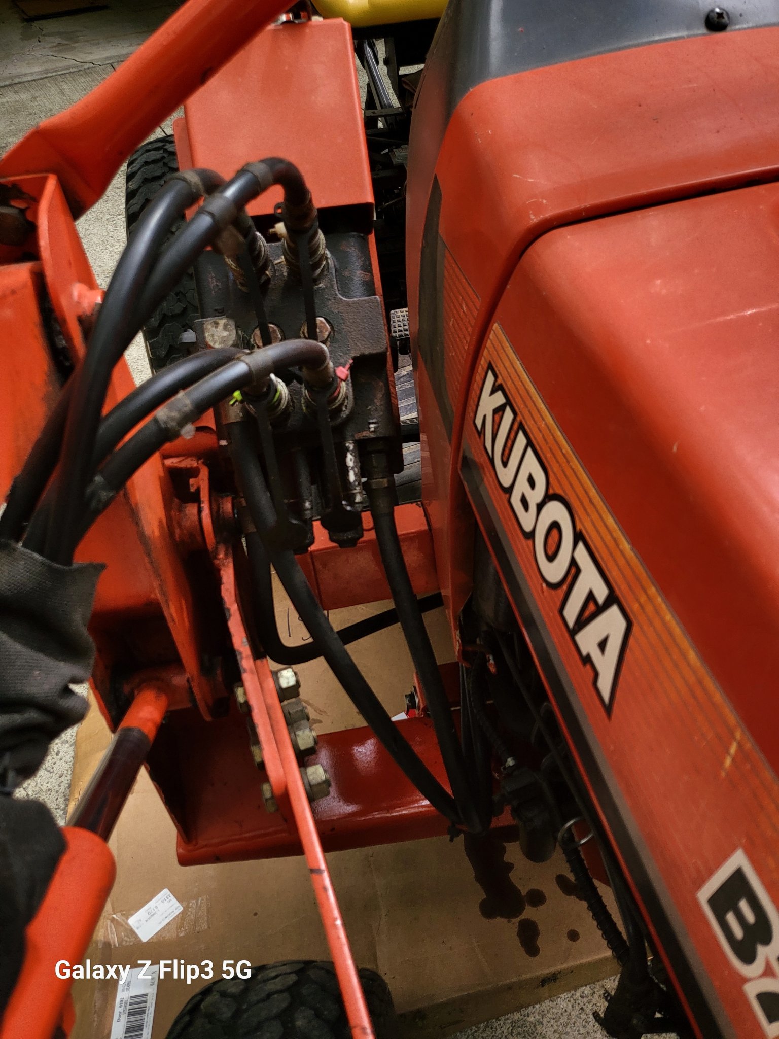

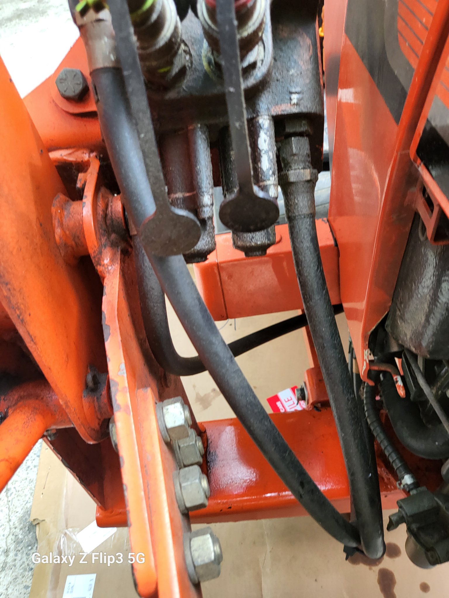

Photos: the first one shows where they are attached to connectors on the frame one has a green band (this is the primary leaking line) and the other has a yellow band, I thought it best to replace both but am open to suggestions. The other photos are of both lines as they come up from the frame to the hydraulic block for the loader. One line is longer I think but not by much. I estimate they are in the 36-42 inch length, maybe shorter.
I'm not very familiar with tractors but do know which end of the wrench to use. Thanks for any assistance.

doesn't sound like much of a problem so sure you will be able to handle easily.
On my end I would simply disconnect both hoses and take to my local hydraulic shop. They sell premade hoses for about $20 for a 40" hose with fixed ends or if something special / unique ends maybe swivle etc... they simply custom make to suit with exact ends you need.
should self bleed when reconnected.

Thanks. So no hidden issues it seems, just as simple as it looks. Thankyou Maple!
