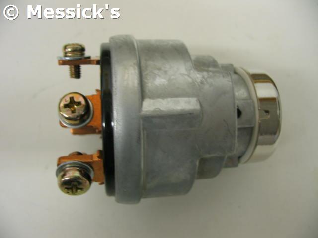

Looking at the parts photo, it looks like the chrome trim ring unscrews to free the switch.
Have battery ground cable disconnected to avoid any shorting of switch terminals as you pull back.

Appreciated. But how do I get clearance to get the old switch out of, and the new switch into, the instrument panel when freed?
I have not done this on a B7200 so not in a position to offer first hand advice.
Other members will respond given a bit of time.
In general I see the wiring harness acting as a pull cord to pull the switch back enough to come free of the dash and then down to allow you to access the terminals.
To avoid wiring connected to the wrong switch terminal in the switch replacement, take a number of photos before disconnecting anything.
