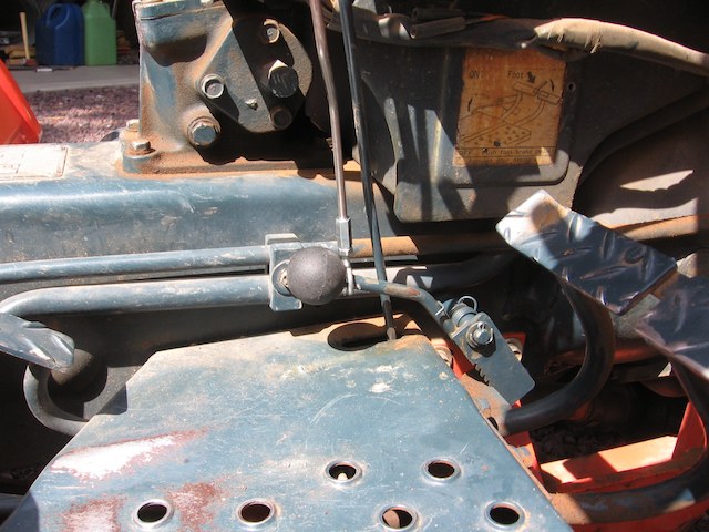

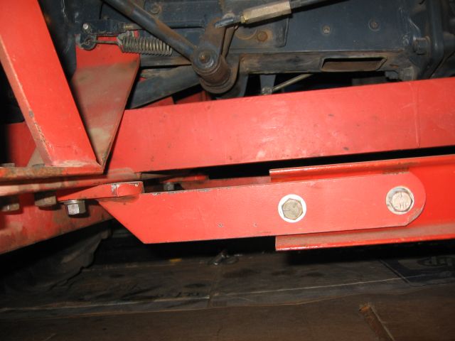

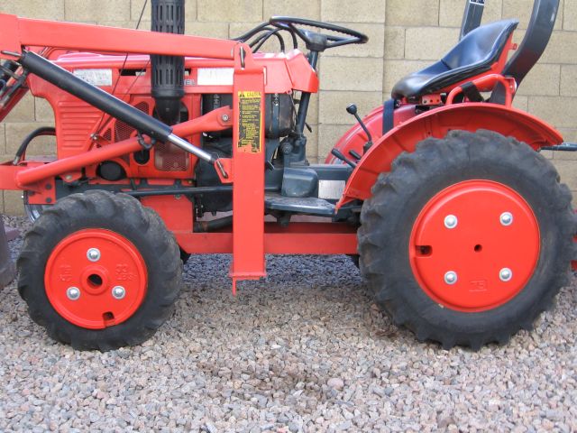

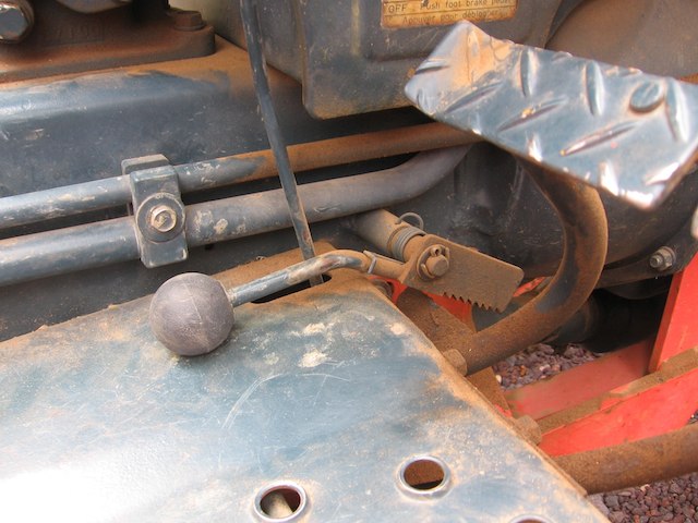

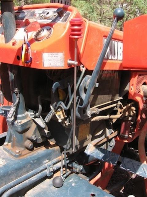

Does any one have a loader frame for a B7100 that can get me some close up pictures of it and where it bolts to the tractor please, can not find one and going to build one, thank you
7,285
2,240
Went through all my pics and these are everything I have that shows anything related to the loader, subframe, & where it attaches. Tractor is not here presently, so this will have to do for now. Hope they help, and will clarify with descriptions if needed.

Westendorf makes a loader for the b7100 and is still available. The problem is that they cost a pretty penny, so I don't blame you for wanting to build your own. For what they cost new, you can find a 7100 with one on it for the same price. You could do that, sell the tractor after removal, and probably get most of your money back. It may cost you less than what it would to build one. Just thought I would throw that out there.
