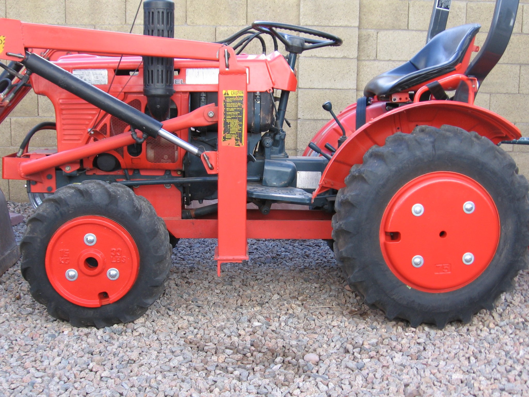

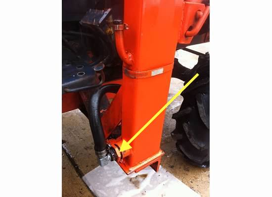

If it is a B219 FEL, (most common on B7100s, 1st two pics) the fitting that the arrow points to is actually a screen that doubles as a drain plug.

Okay, thanks, it appears to be that FEL. The fitting stackup there is different, I'll pull it apart and see if there's a screen there and try to suck out the remaining oil.

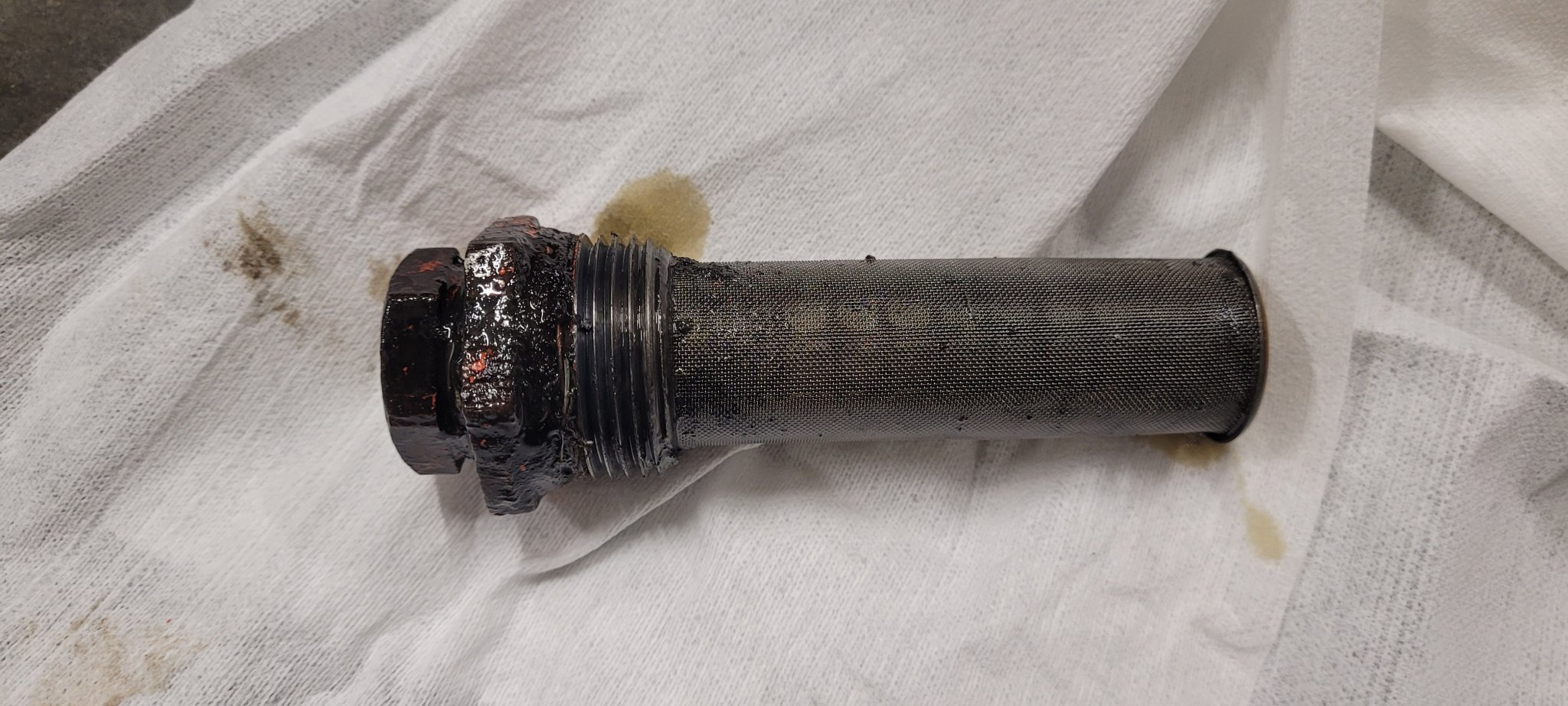

I pulled that fitting, and yup, there's a screen in there that's covered in crud. The bottom of the reservoir was also covered in crud and metal flakes (probably from pipe threads). I sucked most of the oil out from below the supply fitting with big syringe and piece of hose. The oil in the top of the reservoir looked okay, a bit dirty, but the stuff in the bottom was black sludge, the picture doesn't really do it justice. I cleaned everything up with rags and brake clean the best I could, it's not perfect, but probably 99% better.
