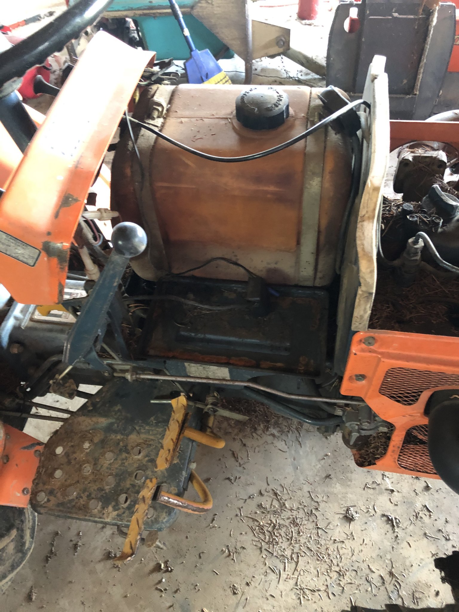

I recently acquired a B7100 with no battery in it, I got a new battery, but cannot install it as there is no positive/negative indication on the cables, they are both black? Any way to know the negative side???

The Pos, goes to the starter... Neg goes to the chassis...

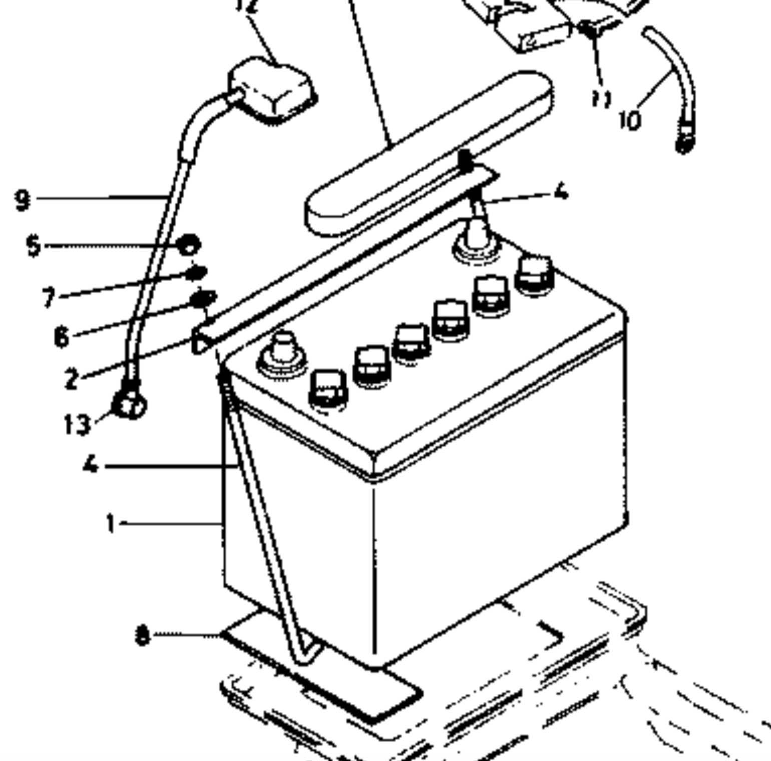

With no battery, I'm assuming no hold down either. Easy to fabricate from a small piece of alum or steel angle, and a couple of conventional 1/4-20 "J" studs from any auto parts store.
Also, a piece of 1/8" or 1/4" rubber sheet under the battery will help with battery life.
