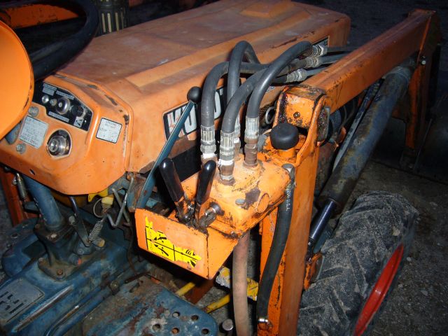

I am having an issue with the B219 Loader Control Valve - detent not holding. With all the snow we have had it has become a major pain - not having the float position.
Has anyone had this issue, where the handle will not stay in the float position? It almost seems like it only happens and does not hold when the temp is below freezing.
I guess I'm just assuming that the valve has hydraulic oil running through the entire valve. Is it possible that there is some moisture trapped in the valve and the detent ball is getting frozen in place. Above freezing I have never had an issue with it. It was working fine last week but the temps were around 45 deg F.
Is there some way to pull the detent ball and spring out without a complete tear down of the control valve?
Any suggestions??? Thanks, Dan
Photo is not my rig, but an identical setup. Hoping the owner of this photo does not mind my borrowing the pic.

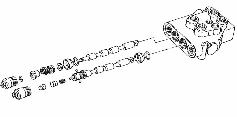

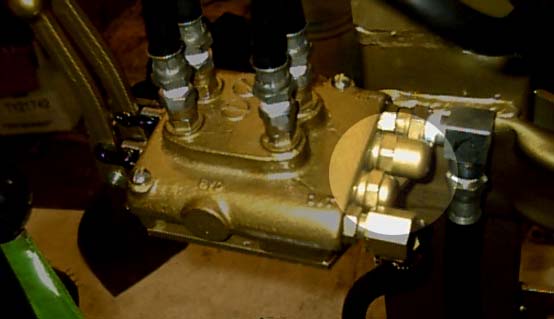

Have the same loader, and had the same problem. The detent mechanism can be disassembled without getting into the hydraulics. Yours is probably rusty like mine was, & my neighbors was the same. (different Kubota tractor, loader, & valve, but similar layout) On the front of the valve, (opposite the levers) there are a pair of caps that cover ends of the spools- the longer one houses the detent parts. The end of the spool has a cross hole which contains a spring & 2 steel balls. The inside of the cap has a ridge & a groove- in normal FEL operation, the spring loaded balls stop against the ridge, and when pushed forward to the float position, they compress into the hole in the spool, then pop out in the groove, locking it in the float position. Mine had rusted to the point where the spring & balls no longer existed. Inside the cap was pretty bad also. Dealer (and Cessna) both told me parts are no longer available. I just cleaned it up, re-assembled it minus the bad parts, & if I need float, I hold it in manually. My neighbor could still get parts for his, so we replaced the parts in his, now it works great. It was a major PITA to hold the balls & spring in place while screwing on the cap, but it can be done. I suppose one of these days I'll make replacement parts for mine, but for now it's just not a high priority for me. If you take it apart, be prepared to have the balls & spring (or whats left of them) go flying, & be prepared to have fun putting it back together. Another neighbor has a Yanmar with the same setup, and we were able to disassemble his, clean the rust, grease it up & re-assemble it, & now works great. Just depends on how bad yours is.
First pic shows the Cessna valve with the two caps highlighted.
2nd pic is the exploded view of my neighbor's valve, (similar) so you get an idea of the ball detent mechanism. Keep us posted….

Thank you for the excellent and very detailed post. It is a big help.
The manual suggestion is what I have had to do (until my hand is needed elsewhere at the same time) :D and by the sounds of the repair, will continue that way, til things warm up and dry out this spring. Don't need to be pulling tiny springs and balls in 5 degree F weather today.
At least I now know what needs to be done. THANK YOU !!!
