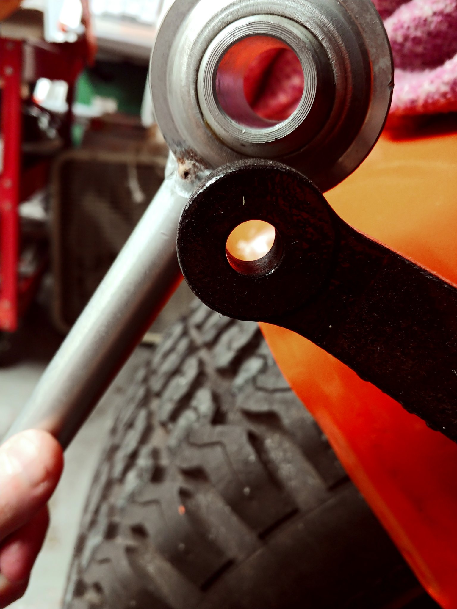

New to the foru, but been reading for some time. I am the owner of a new to me 1979 B7100. When I got the tractor home I noticed (after reading for a while) that I was missing the 3 pt hitch lower arms. I read somewhere on this forum to purchase a set from Weavers (item # 7825-1112, 23.5 inch universal 7 piece hitch) - link is below.
Weavers 7 point hitch kit

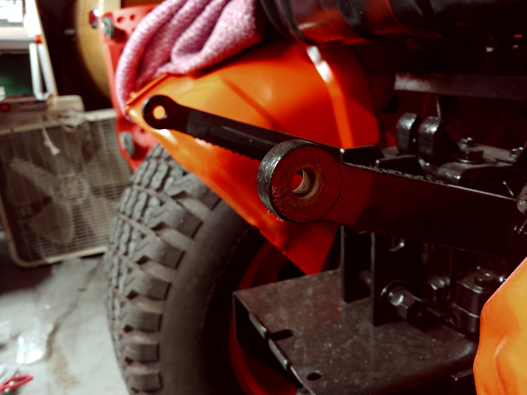

I thought I had read that it would be a perfect match but something seems off to me. I noticed that the hydraulic upper lift arms on my tractor are maybe a Cat 0? The ID is only 1/2" while the ID of the ball socket on the connect arms is actually 3/4". Are my hydraulic upper arms the right size for this tractor or do I need to upgrade them to a Cat 1 setup?
Also, the lower arms seem really long, but maybe that's just me. Here are some pictures of my setup. At the end of the day:
Should I just get 3/4" to 1/2" reduction bushings and use the items I have OR get new hydraulic lift arms OR did I get the wrong 3 point hitch kit?
Help! (thanks!!!!!!)

Your local Tractor Supply will have bushing to size the links correctly and yes, the arms do look a bit over length.

Thanks! Is there a particular length that most people use with B7100s? I honestly only bought them this long since someone on here had recommended that particular kit. I only plan on using a 48 inch finish mower with it...

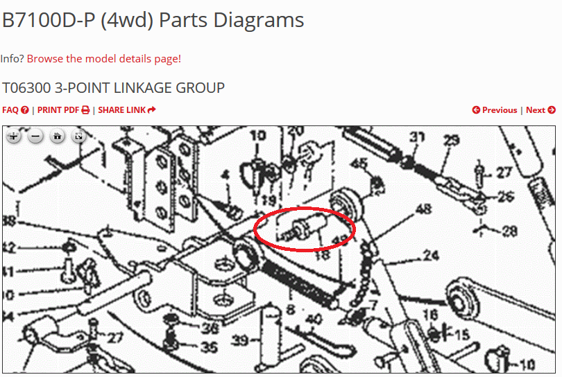

You are missing the special stud that fits into the 1/2" hole in the lift arm and provides a protruding pin of bigger diameter for the lift arm.
see part #18
see part #18
Dave
The interesting thing is that the actual picture they have on the Messick's website doesn't look anytning like the illustrated pin bolt. I'm wondering if maybe just using a 1/2" bolt and some 3/4" bushings will do the same function?
The correct fastener has a large surface to bear on the lift arm to resist bending of the fastener.
I do not know on your lift arms but often the special fastener is tapered to fit especially tight into the lift arm.
Not a place to be taking short cuts when you will have heavy implements lifted in the air.
Dave
