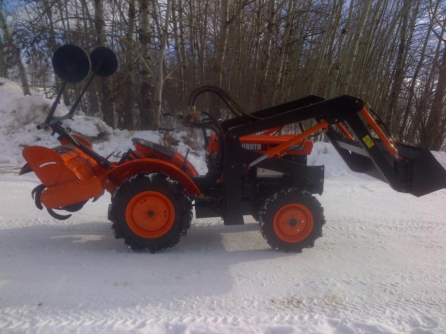

I bought this B6000 with the loader on it 8 years ago. Even with the rototiller on the back it has no problems lifting the back end off the ground if you're not careful, and at even 3/4 throttle the loader is very quick moving, almost too quick when trying to be precise. There is no auxiliary hydraulic pump on this tractor.
I appreciate hearing that from you. I feel more confident about using the built-in hydraulics, which saves a couple hundred dollars.

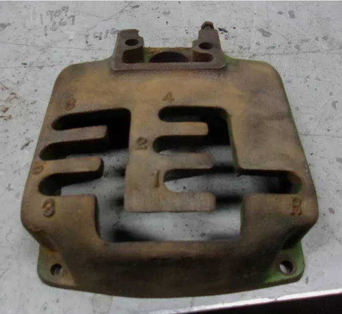

Ah yes . . . when I was about 12, Dad had hired Mr. Ab, a big man, to bale hay. I was supposed to be hauling hay, but Mr. Ab needed somebody to run the rake, pulled by a B. My previous experience was our Allis Chalmers 'C' (the other orange), but I jumped at the chance to get out of throwing those bales, so I got on. After seeing him throw his bulk into starting the thing, all I could think about was not stalling it. Then I looked down to put it in gear, and about choked
Screenshot_20210330-032800~2.png That shift pattern looked like a rat maze compared to the AC's 3 speed!
