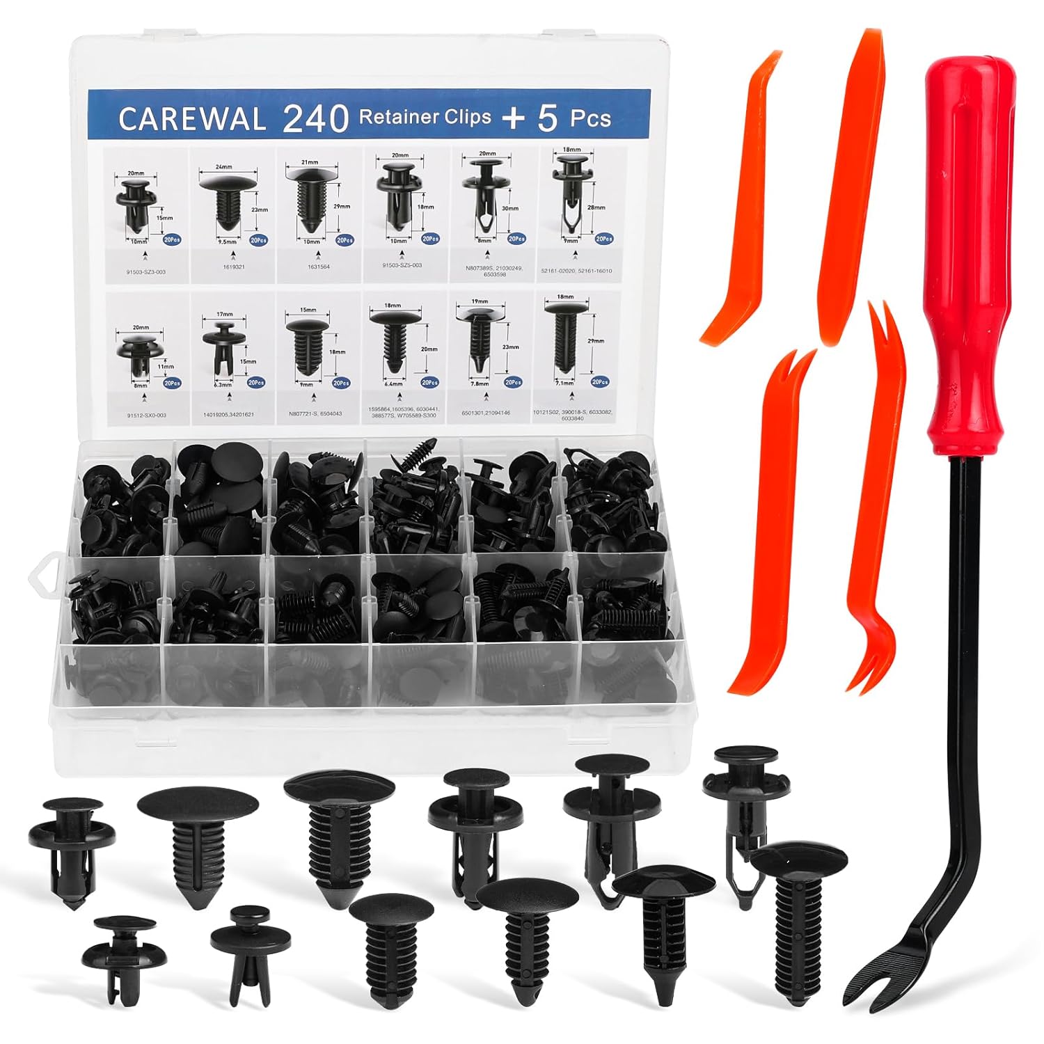

Are you talking about retainer clips like these? If so you'll likely need a kit to replace the ones that don't come out easily. Just search Amazon - body panel clips, retainer clips, etc.
If not take a picture and post it.

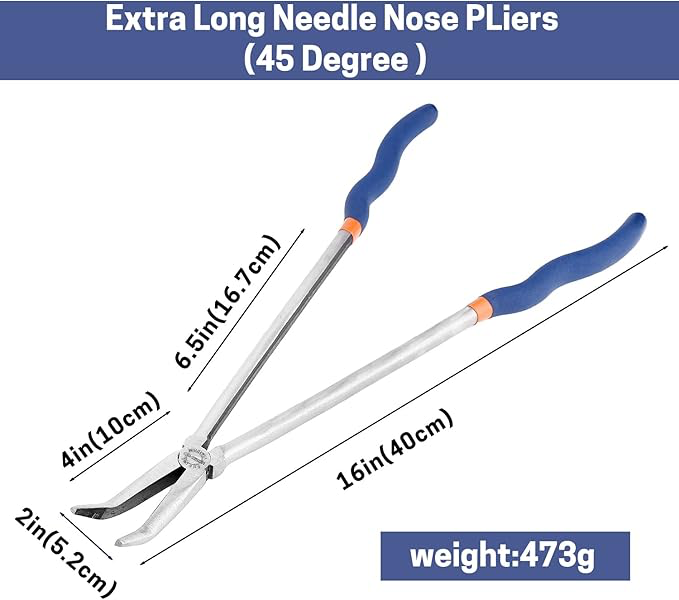

Those things (plastic clips) are a PITA, especially in the cold. Warming the tractor cab up will help, if possible.
I have a couple of the above posted “special tools” and they rarley work.
My “ best tool” for those style clips has been a 45 degree, long needle nose pliers.
Can’t say that even those are “great” though.

Do not push the center all the way through.
When installing you push the center in and it spreads the tongs (for lack of a better term) to lock it into place. To remove pry the center back out and it should release the tongs so you can just pull the thing out. A very small flat screw driver works well for that.
DO NOT buy them from Messick's for $3.09 each. You can get a whole assortment for $10 - $20.

29
Bee-Positive is exactly right, thats how to remove them. Havent been on this site for a while so its a funny coincidence I see this thread.
