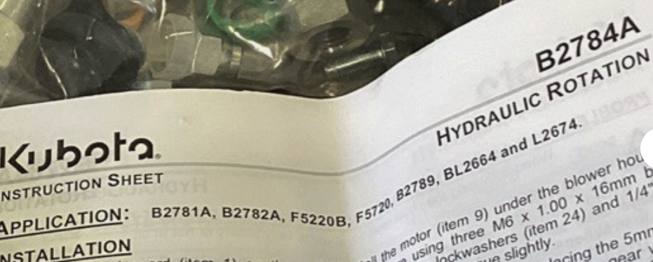

6 66ChevelleGuy New member Equipment Kubota Aug 25, 2025 4 0 1 Michigan Yesterday at 7:42 AM #1 Good Morning, I am curious what the difference might be between a couple rotation kits. B2784A vs B2756. Will the B2784A kit work for my B2650 HSDC cab tractor? Thanks in advance for any help.
D Dustball Well-known member Equipment 2016 B2650HSDC Sep 15, 2023 425 283 63 Hudson, WI Yesterday at 9:13 AM #2 Different hydraulic motors and mounting. The B2784A kit fits these snow blower models-
