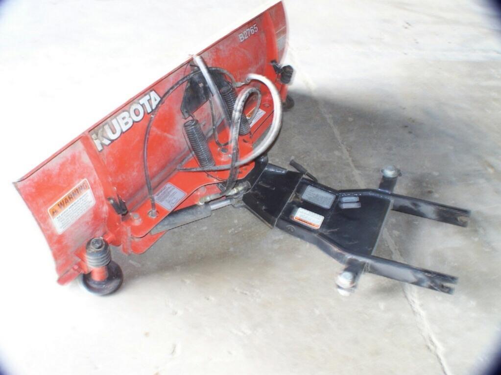

I have a 2014 B2620 with a front loader and mmm. I'm looking for a front snow plow for it and came across this blade. Will it fit my tractor and what do I need as far as mounting brackets. Here's a picture of it and the asking price is $1500.

My dealer was going to sell me a 2765 for my b2620 so yes it will fit. But that is just the blade. You will need to get a quick attach for the b2620. I say that only because mine is much different. What tractor did that come off of? I would suspect that 1500 is not a good deal if you have to but a quick attach in order to mount it on the 2620? From the Kubota website .......
1 QUICK ATTACH & SUBFRAME $967.00
1 60" FRONT BLADE $1,647.00

Thank you for replying. Not sure what tractor it came off of? Spoke with my dealer today and they can set me up for $2500 with everything I need. They did say to order by July if I want it in October. Must take awhile to get them in. Thanks again.

I don't know much about B tractors, but the blade in the picture you posted has the quick attach and subframe attached to the blade. Did you get the number off of the quick attach and subframe to see if it would fit your tractor. I am not sure what you would need to lift the blade as there does not appear to be hydraulics for lifting included.

Understanding that this post is old, I figured I would just add the answer to this question for other users.
For B2620 and similiar model tractors, you will be looking for the B2765A or B2775A Snow Blades, and you will then need the B2733 quick hitch. (2 seperate items)
You will need to remove two bolts from each side or your FEL Frame to install brackets for the quick hitch, and in many cases, I have seen that these brackets are not sold with the used quick hitches.
You can find the Brackets on Messicks with these PN's; 70060-02152 and 70060-02153
I should point out that I purchased this setup from a guy using it on his 2001 B7500, and it bolted right up to my 2013 B2620

Another followup to this old post, for general knowledge-
The black part attached to the blade is indeed a quick hitch, but one for a Kubota "F" lawn tractor. It "for sure" fits the xx60 series, and the xx80 series; (not sure if it fits the xx00 or xx90 series.) The large bolts located about midway attach to the lift arms of the mower, so no other separate"lift mechanism" is required.

Well I'll jump on this old thread too. I have a B2620 and ran across a B2775 blade with a 2791A subframe. Guy wants $2300. Any comments on price and if it will fit?
