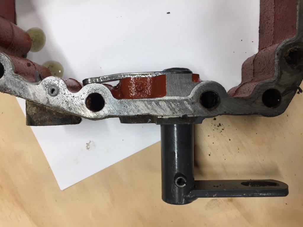

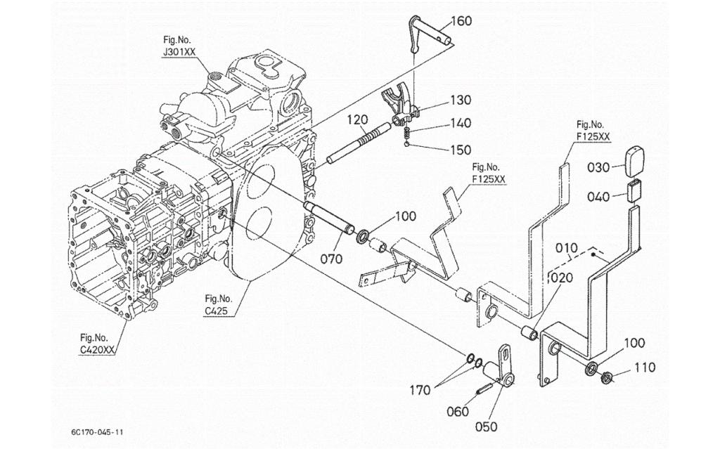

The range shift lever was loose, but the external roll pin was not broken. The lever would move freely and occasionally have some resistance. I found that the range arm shift lever (6C170-18510) was bent in two directions. Since it was bent it also caused small damage to the range shift fork (6C070-18420) which was replaced, along with the rod it runs on (6C070-18410), and its detent ball and spring. Replacing the rod and spring/ball wasn't strictly needed, but I ordered them before in case they were somehow damaged. These are parts 120-160 on kubota's drawing. I re-sealed the split cases with permatex anaerobic gasket maker #51813, waited a day, and refilled with UDT2. The range shift functions well. I suggest being very careful with the 3pt lift assembly- I introduced or disturbed a tiny piece of debris which resulted in it lifting slowly. This was resolved by removing it, tearing down, and cleaning the valve body.
parts 120-160 were ordered

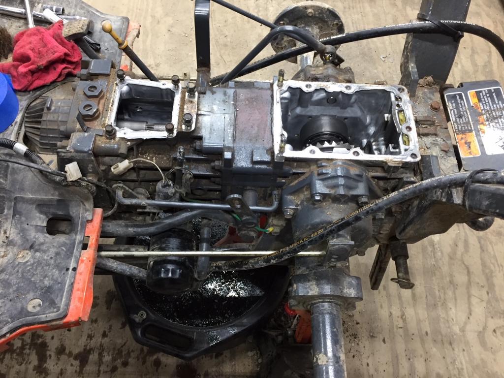

sheet metal and seat support off.
the range section is slightly red. The nuts on its left were removed to split.

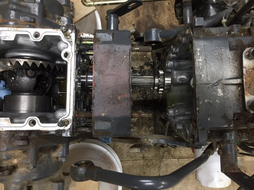

differential, rear axle, and range were moved backwards on a rolling jack to stands
bent lever was replaced
