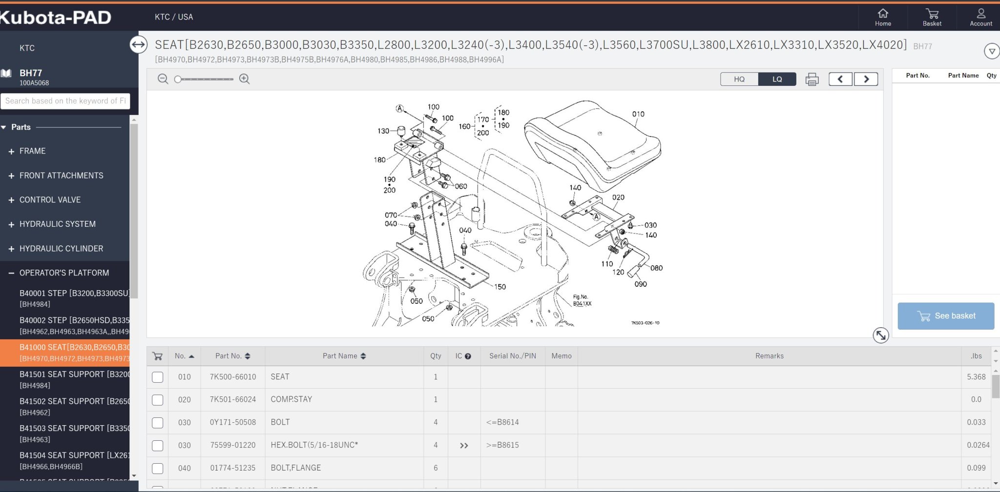

I'd like to add the backhoe seat to my B2650 (ROPS, no extra subframe extension like the cab version has). Does anyone know the part # for the backhoe seat kit (seat, post, and hardware)?
I hate having to rotate the seat.
see here:
here's the long way...https://apps.kubotausa.com/illustrated-parts/
