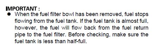

How full was your tank? Manual says needs to be below 1/2 tank

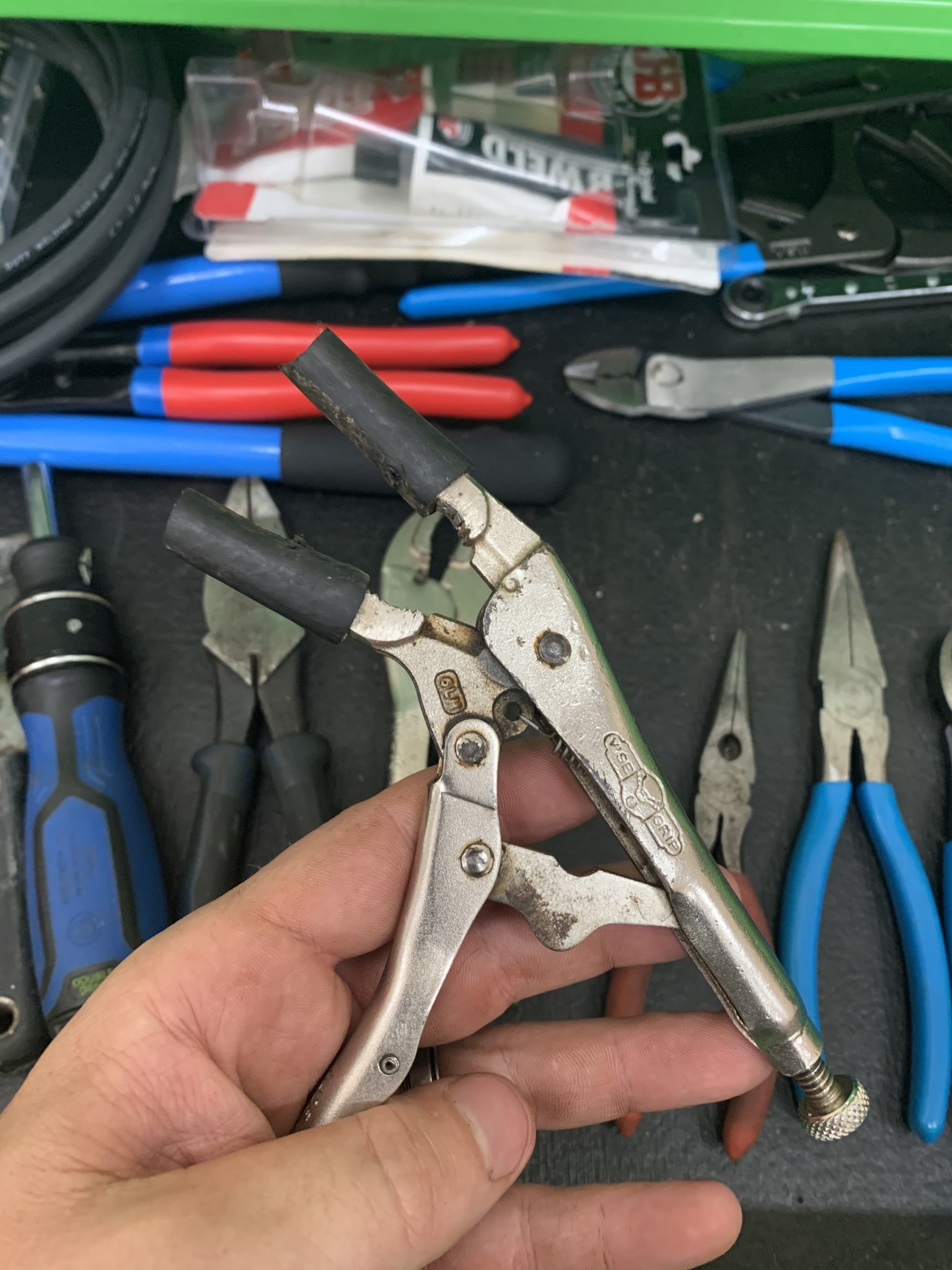

If there is no fuel shut off, the low tech answer would be to squeeze the line before the filter with a pair of locking pliers...just enough to cut off flow, and not to damage the tubing. Assuming the tubing is flexible.
Just what I would likely do...food for thought.

Ran the level below 1/4, lowest I ever had it, but it still dumped fuel. Don't know if it would have been worse with more fuel.

That's strange. I just dumped my filter content 3 times the other day (seemed like I had water in the fuel) and it stopped flowing out of the filter housing after a second or two. Didn't lose a whole lot of fuel each time. I would say that I had over a half tank of fuel in it at the time.
The fuels dumps out of the housing while your spinning the filter off, but it stops flowing after only a few seconds.
I usually do what Cherokee pictured above...only when necessary.
